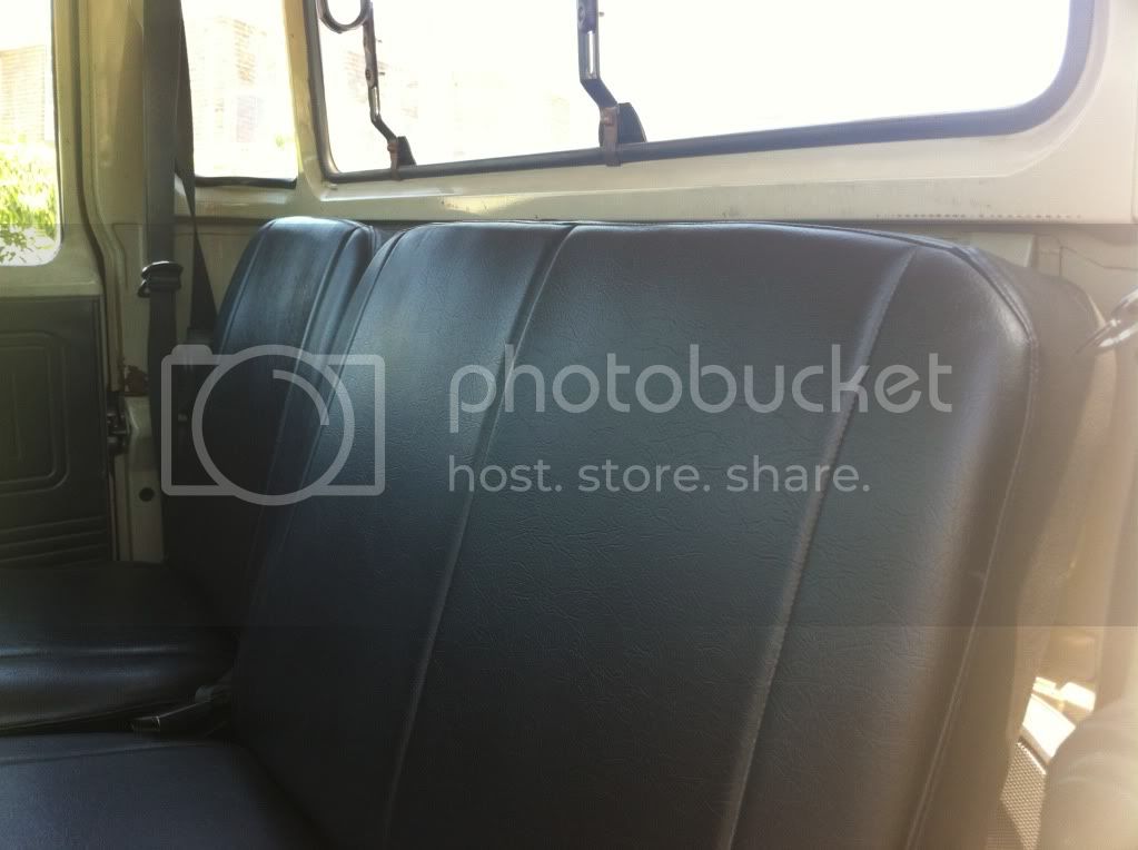

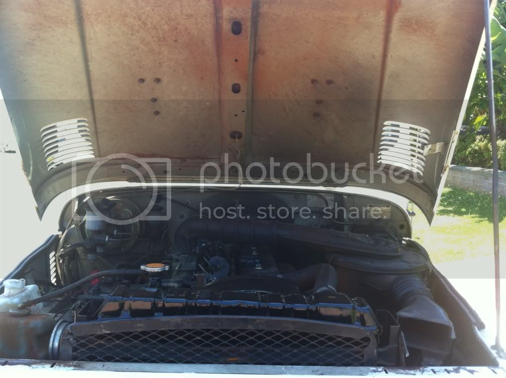

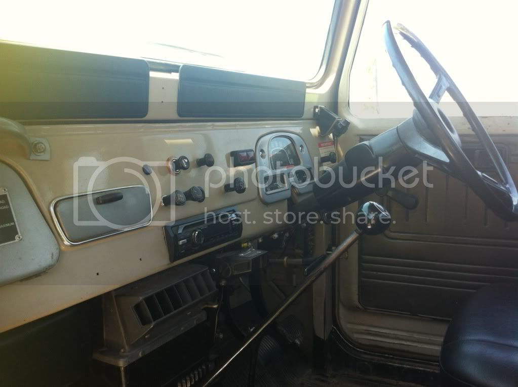

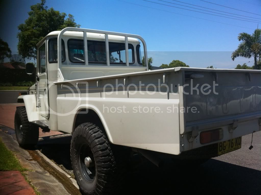

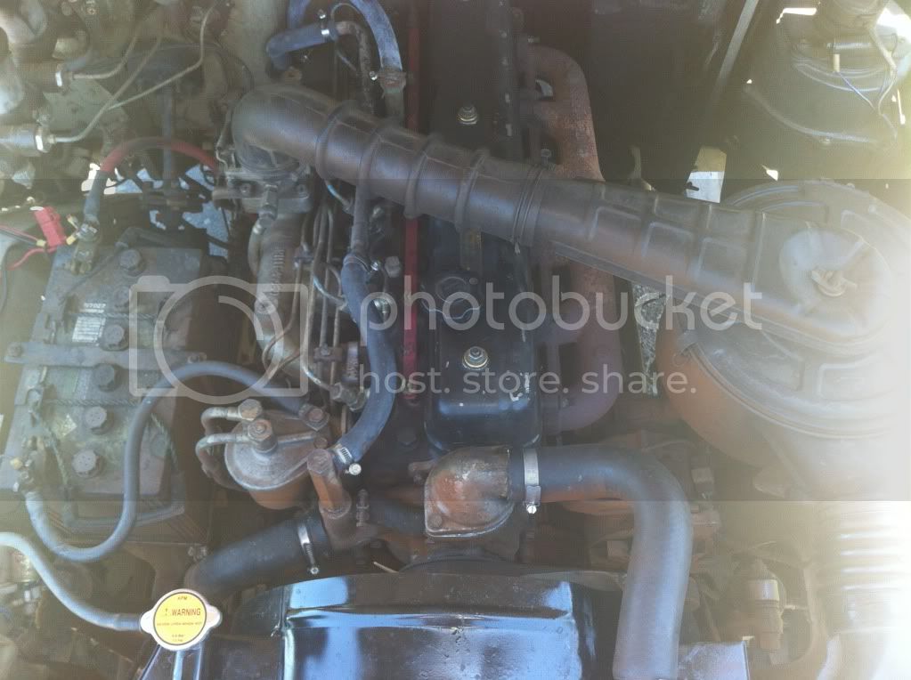

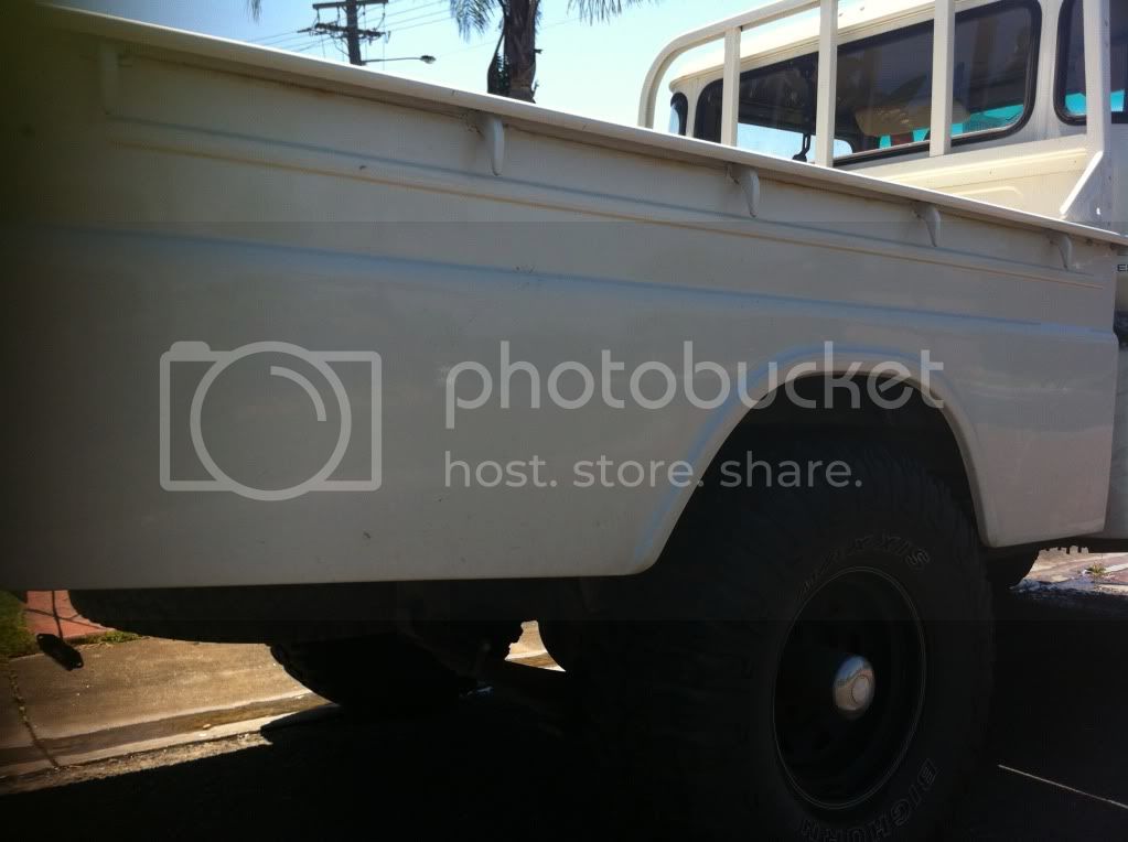

I've been looking for a fj45 for some time now and I came across this one on the net. Pic's listed below, It would be great to get some feed back from You pro's , Asking price 14,000 It looks pretty clean and straight what do you think?? don't want to make a big :whoops:
some more detailed pics would be good, it is a 3.6L "H"engine, they were a bit of a slug.

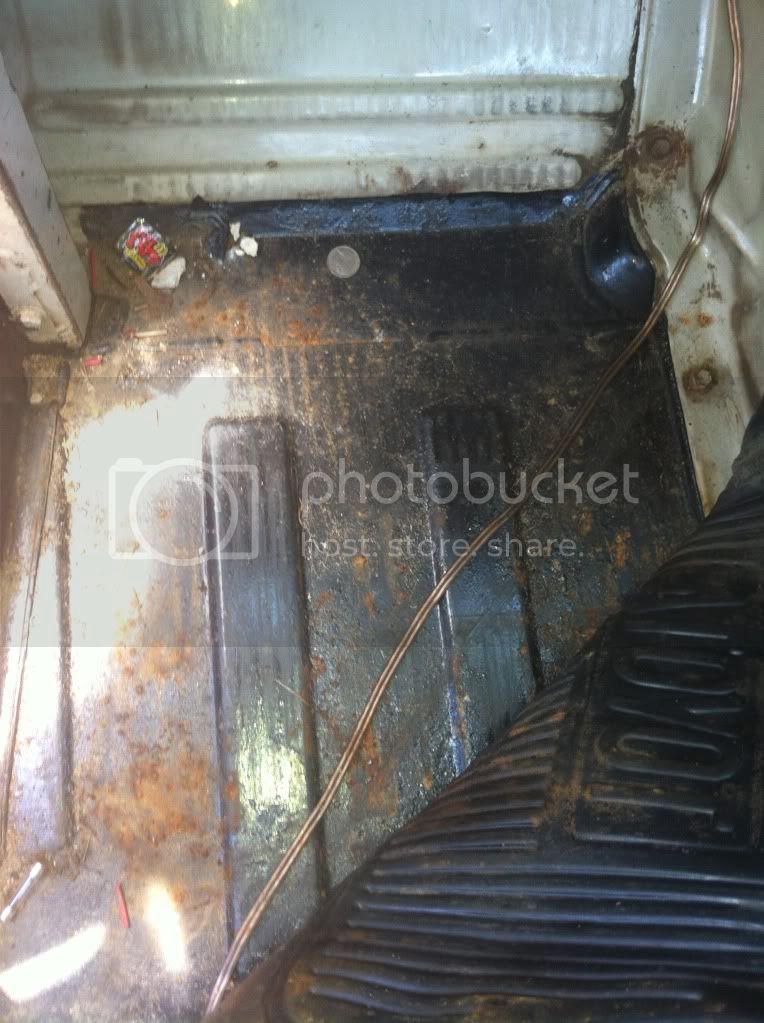

floor pics is of passenger side, need to look at drivers side as well. has rust stains under the hinges on the bed. loks like rust near drivers seatbelt, they normally go here, has it had a respray ??
looks tidy, just need more pics to really tell, where is it located, u may be able to get somebody to go look at it

$14k is waaaay too much for a H diesel, even one that neat. Try under $10k. Recently saw an '84 HJ47 with a 12H-T, H55F, A/C, P/S and disc front for sale for $17k. Neatest truck I've ever seen. Now that was a truck you'd pay more than $10k for, but not '78 H-motor, H41 and no air or steer. He's taking the piss. Is very tidy though and worth it if you can get him down.

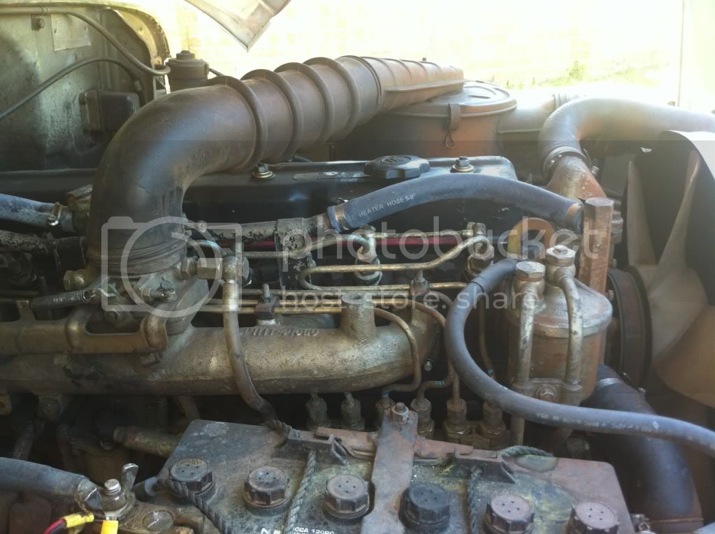

That seems like way too much for down-under and it might get $10k + in the US, maybe if it was a left hand drive. I'm thinking the rusty stains on the hood/bonnet are from a leaking water pump or is it just red mud spattered up from the fan?
