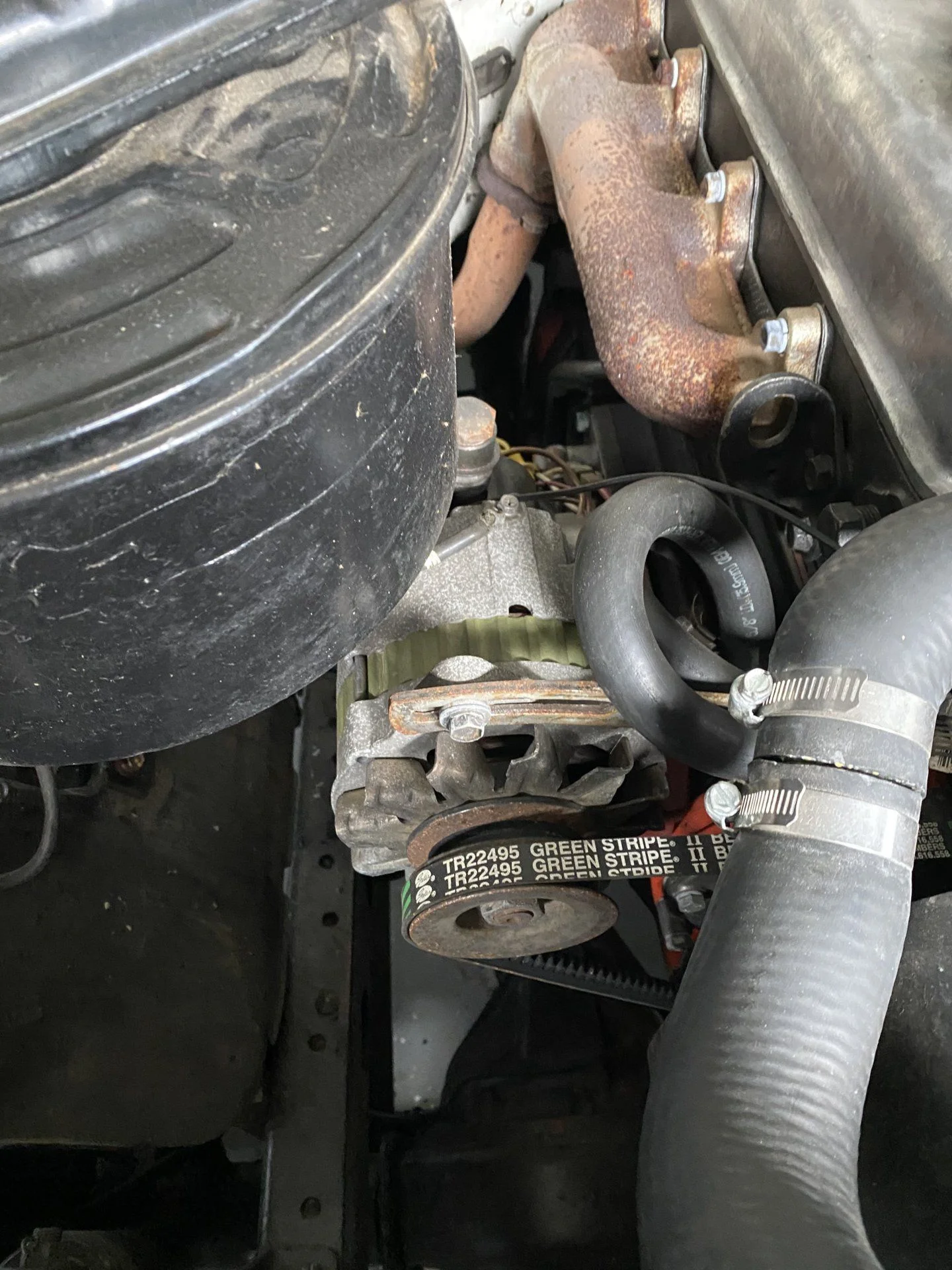

I am in need on an alternator or an alternative one that can be used, can anyone please help
No I havent, do you think thats the problem?

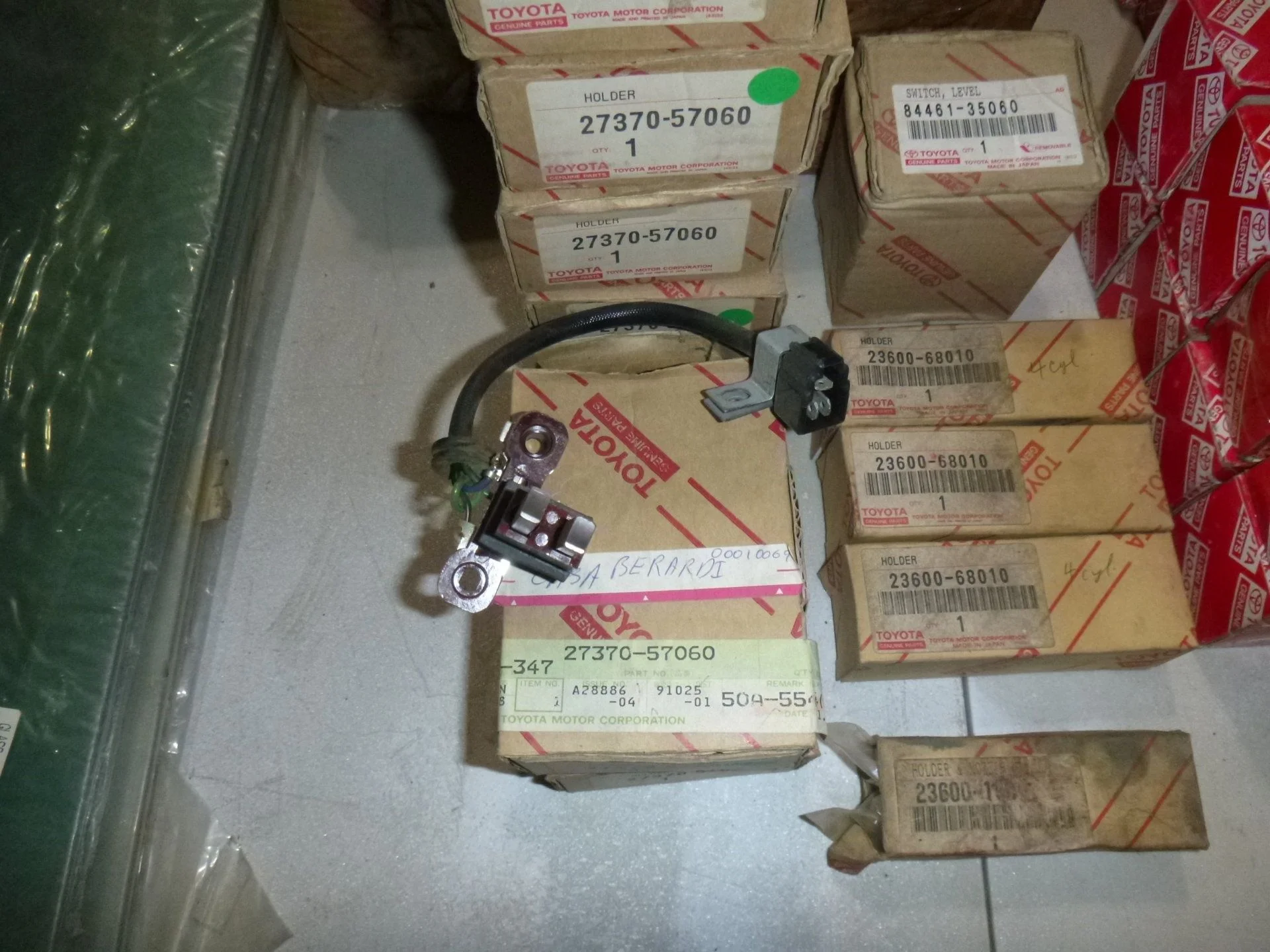

It's pretty common to need brushes after 250,000km and they are cheap and easy to do. If you can't find brushes in factory holders you can get the brushes alone for a few dollars and solder them in.
