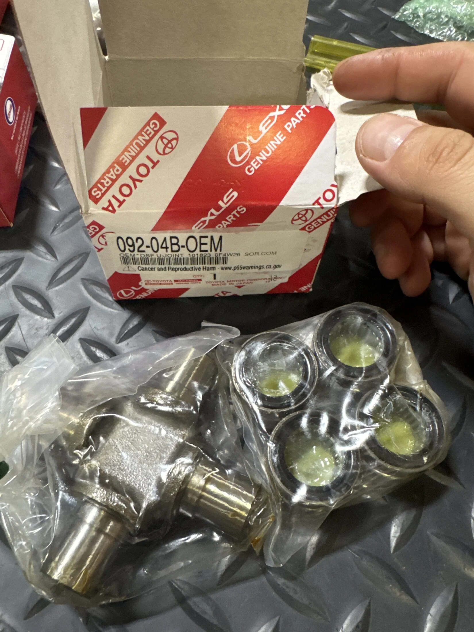

Specter off road has these original u joints I just picked up, very nice quality

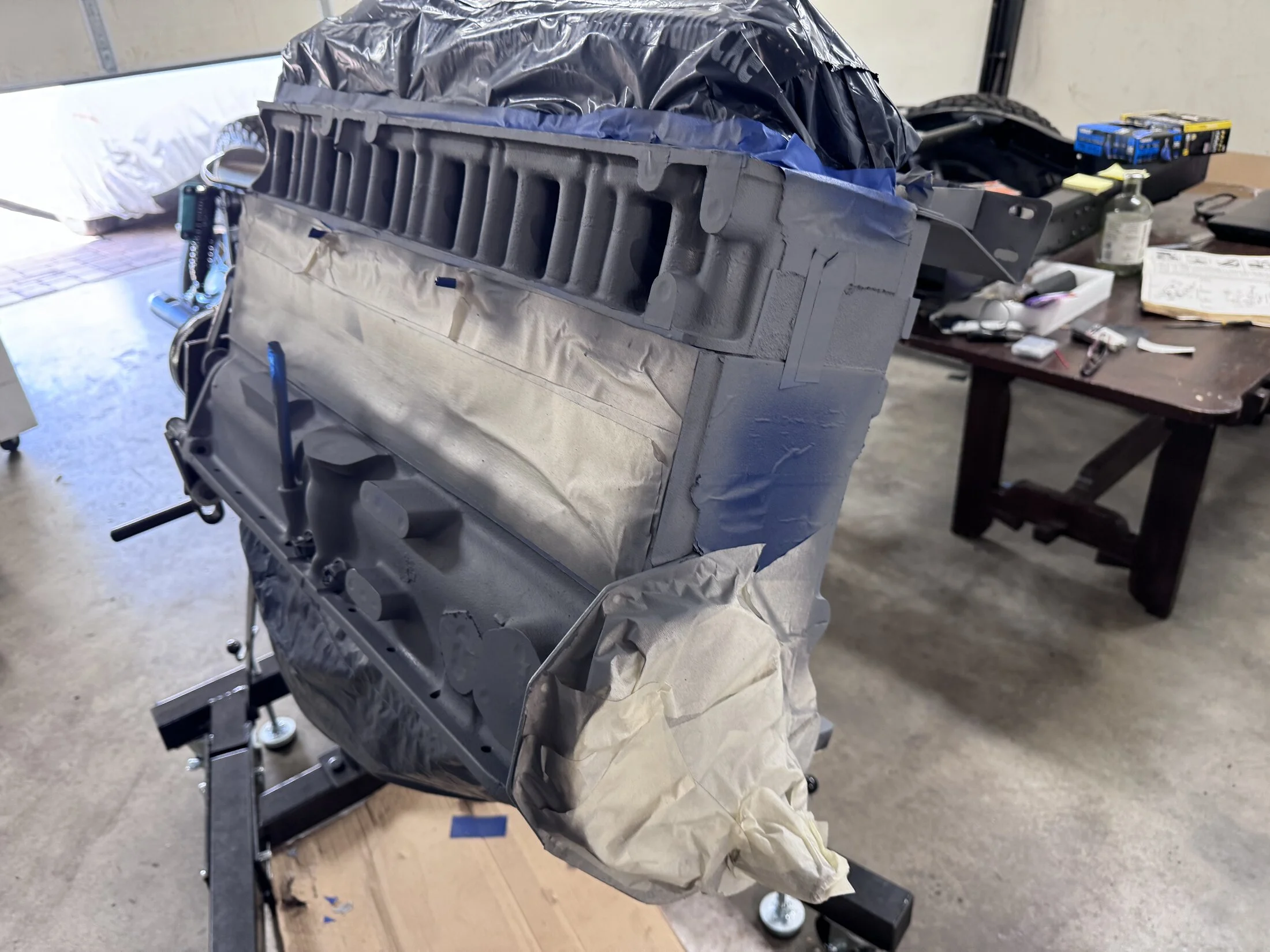

Tomorrow I’m going to take the valve cover and oil pan to acid dip / black zinc it or some type of nice finish to it
Might look nice to finish the side cover and timing cover the same way...

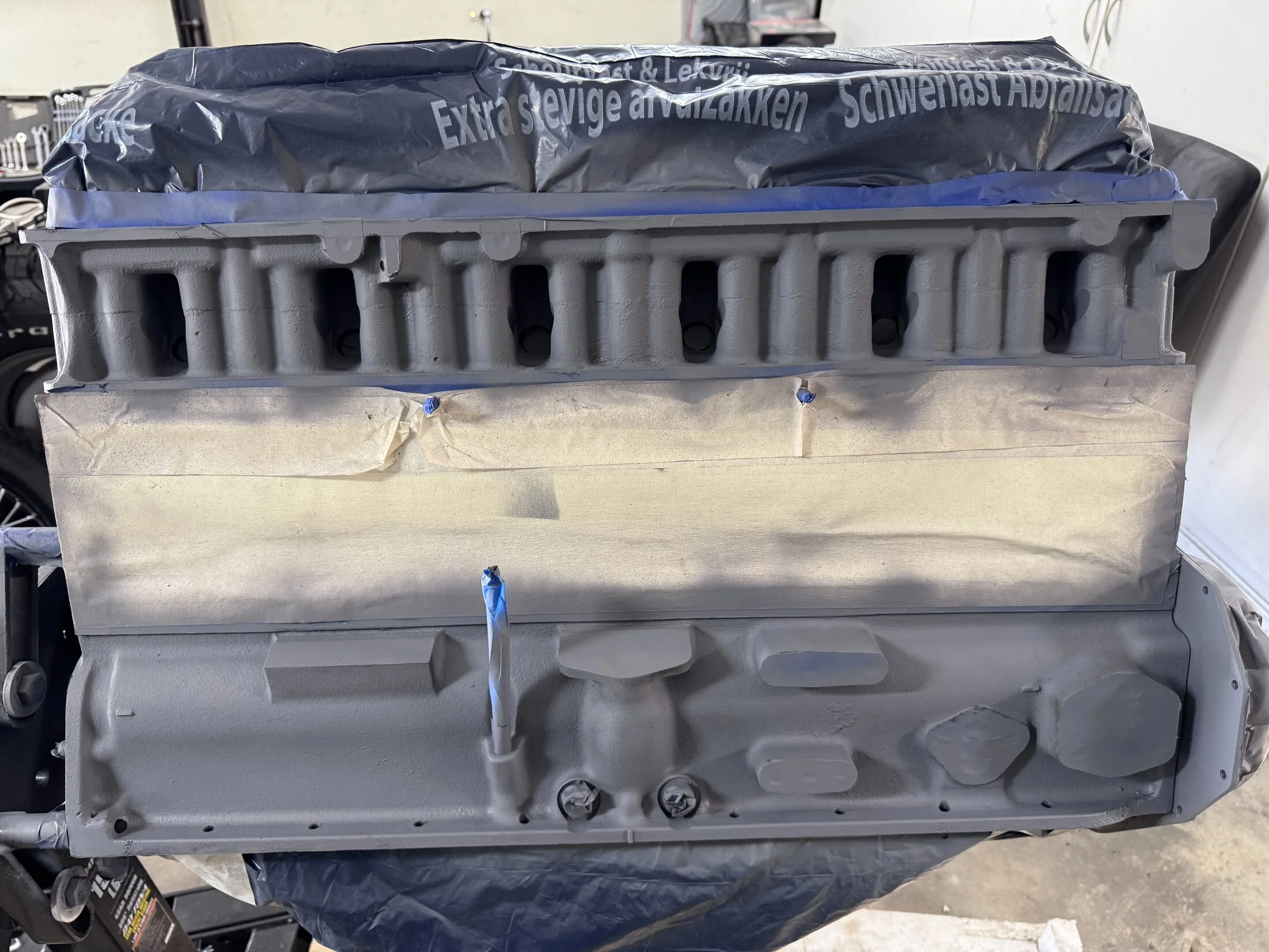

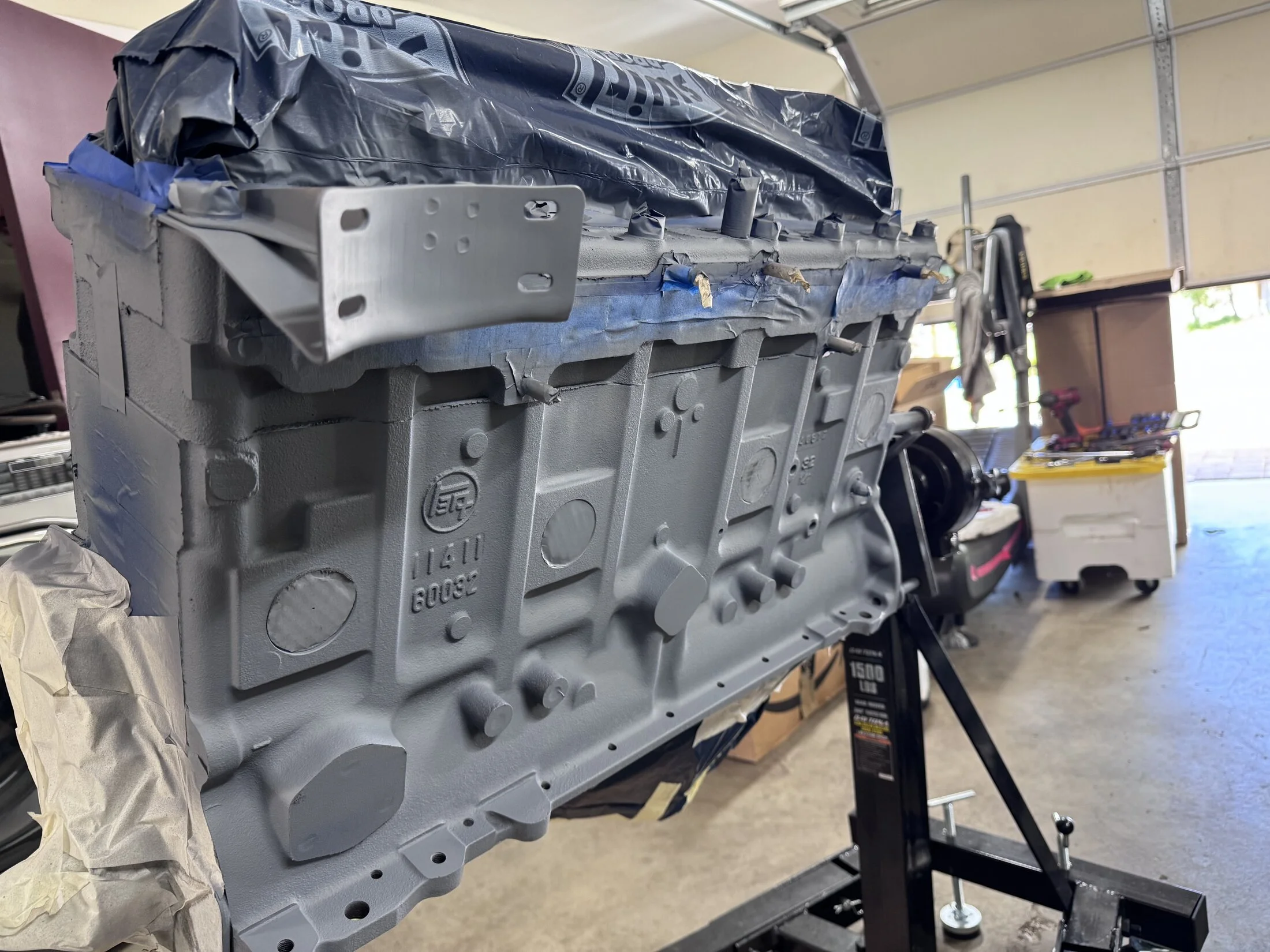

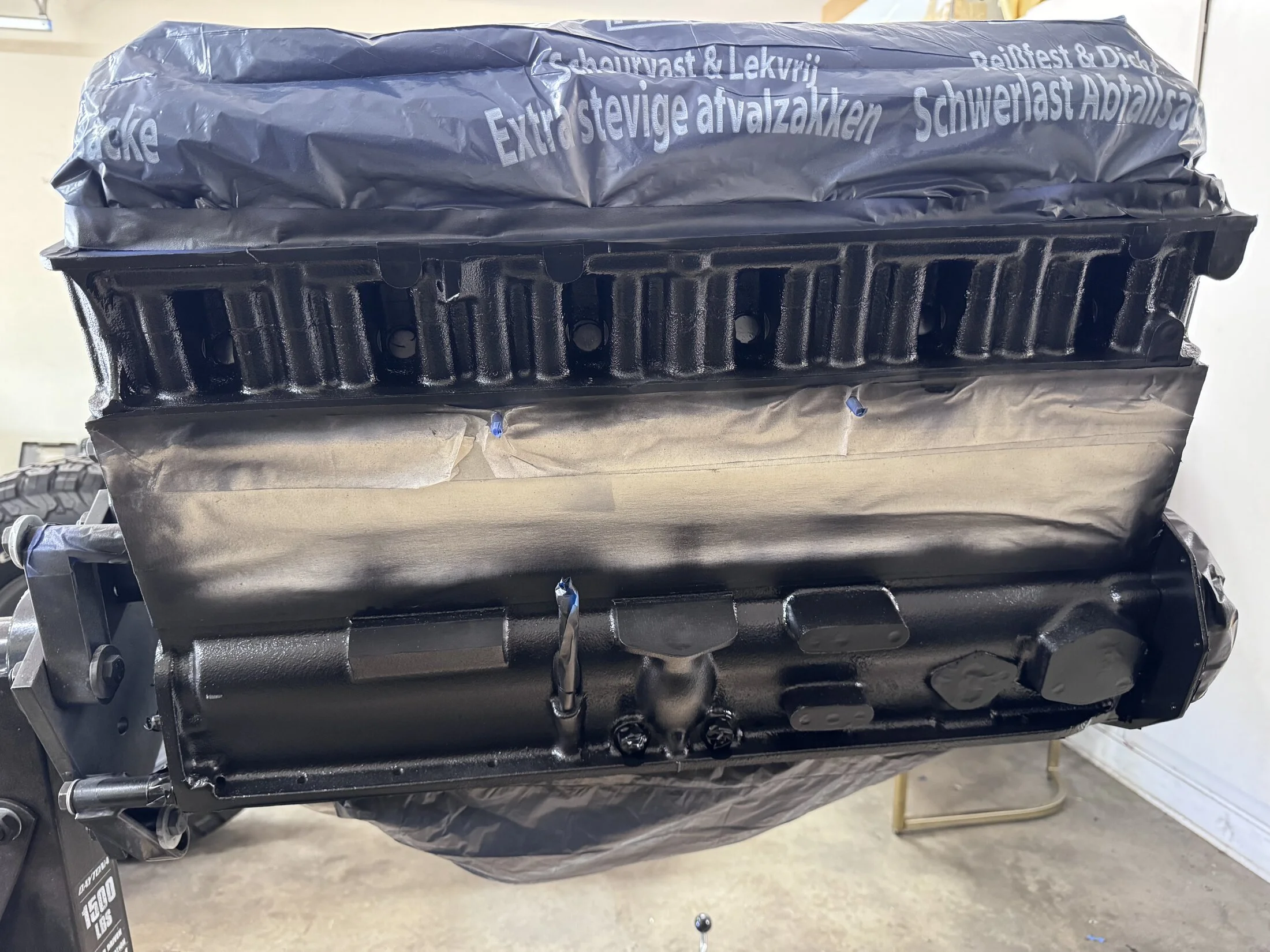

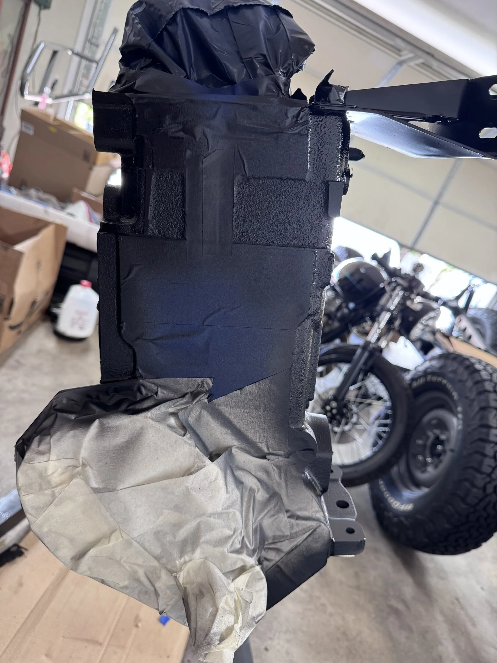

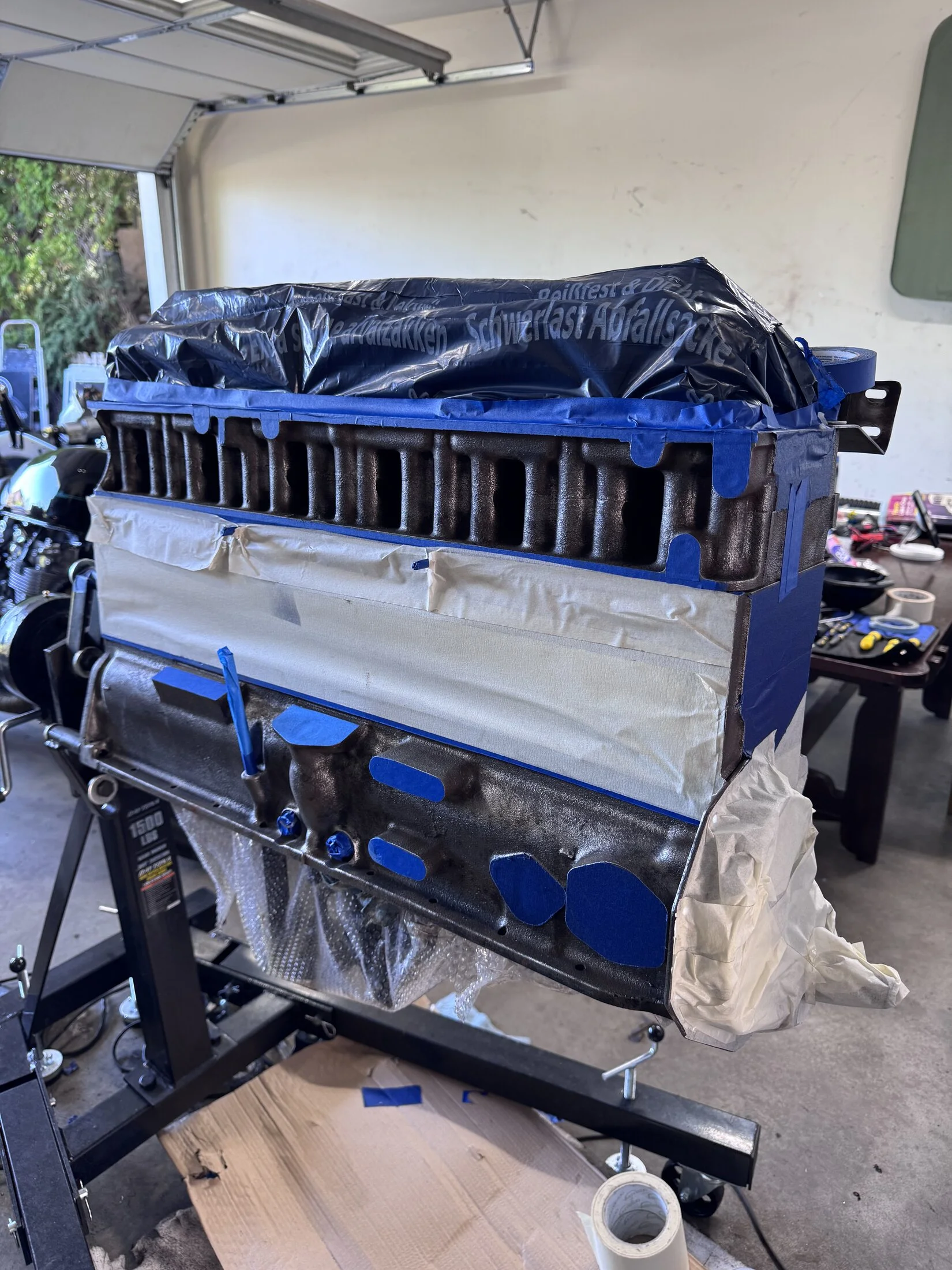

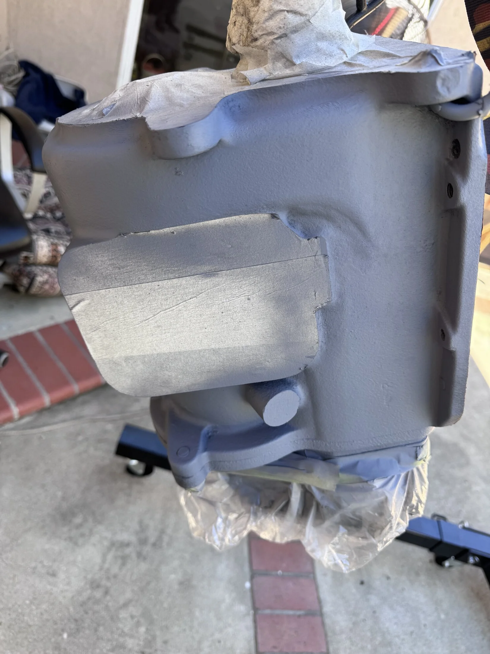

Engine & Trans primer painted with heat resistant engine block paint / primer going to be satin black tomorrow

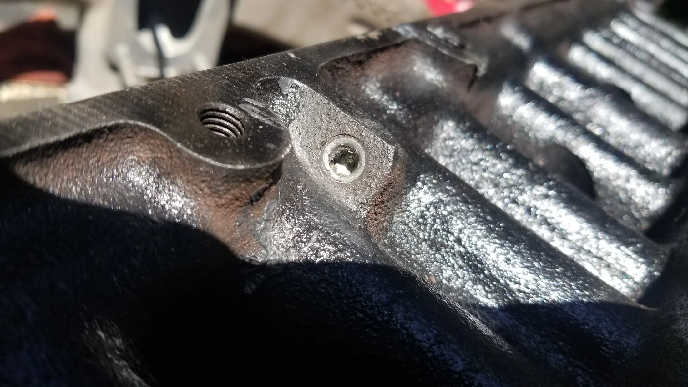

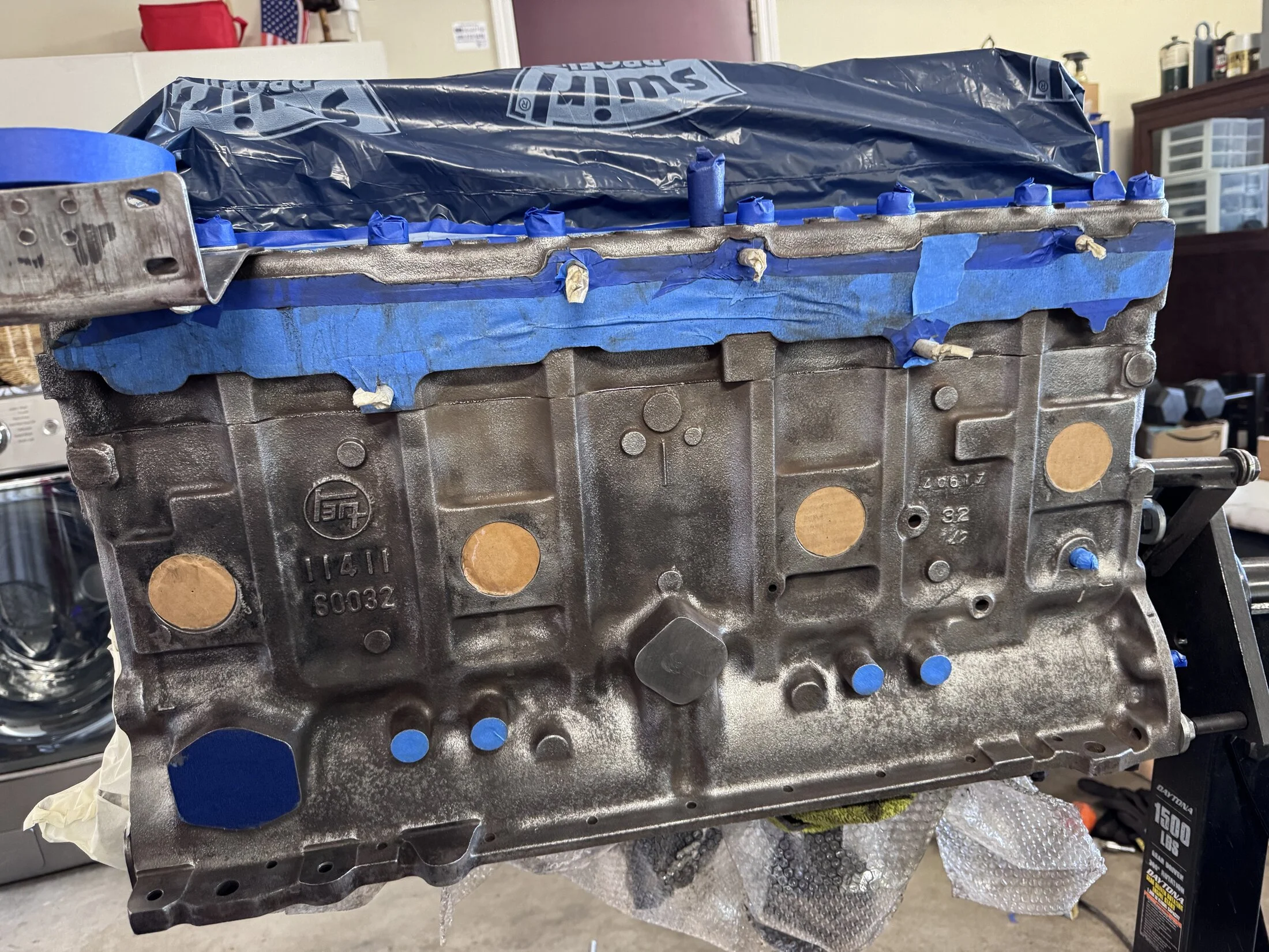

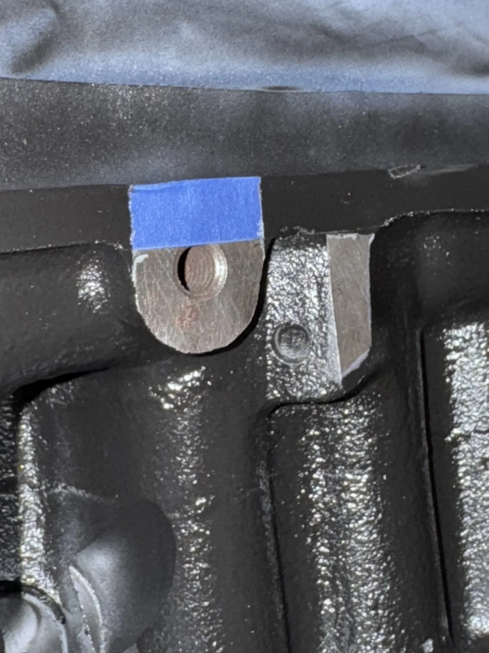

Looking at the pic of the PS side of the block reminds me, have you addressed the potential problem of that oil galley plug on the head?
I don’t even know what that is, what do I need to do?
There is a hole in the head left over from drilling an oil passage for the rocker arms. Factory put just a thin metal plug in it to close the hole. Sometimes (just sometimes) those plugs work loose and catastrophe can follow. Many people, like me, remove the factory plug and thread that hole for a real plug, then weld or peen that plug securely. It never needs to come out.
You can see it just in front and above sparkplug hole #5
I love you, ok I’ll make sure to weld that thing in to save the engine! Great info
So I’m trying to understand mine just looks like a regular little dimple, should I clean off the paint or just dump a little weld on it?
do not weld that. tap and install threaded plug.
