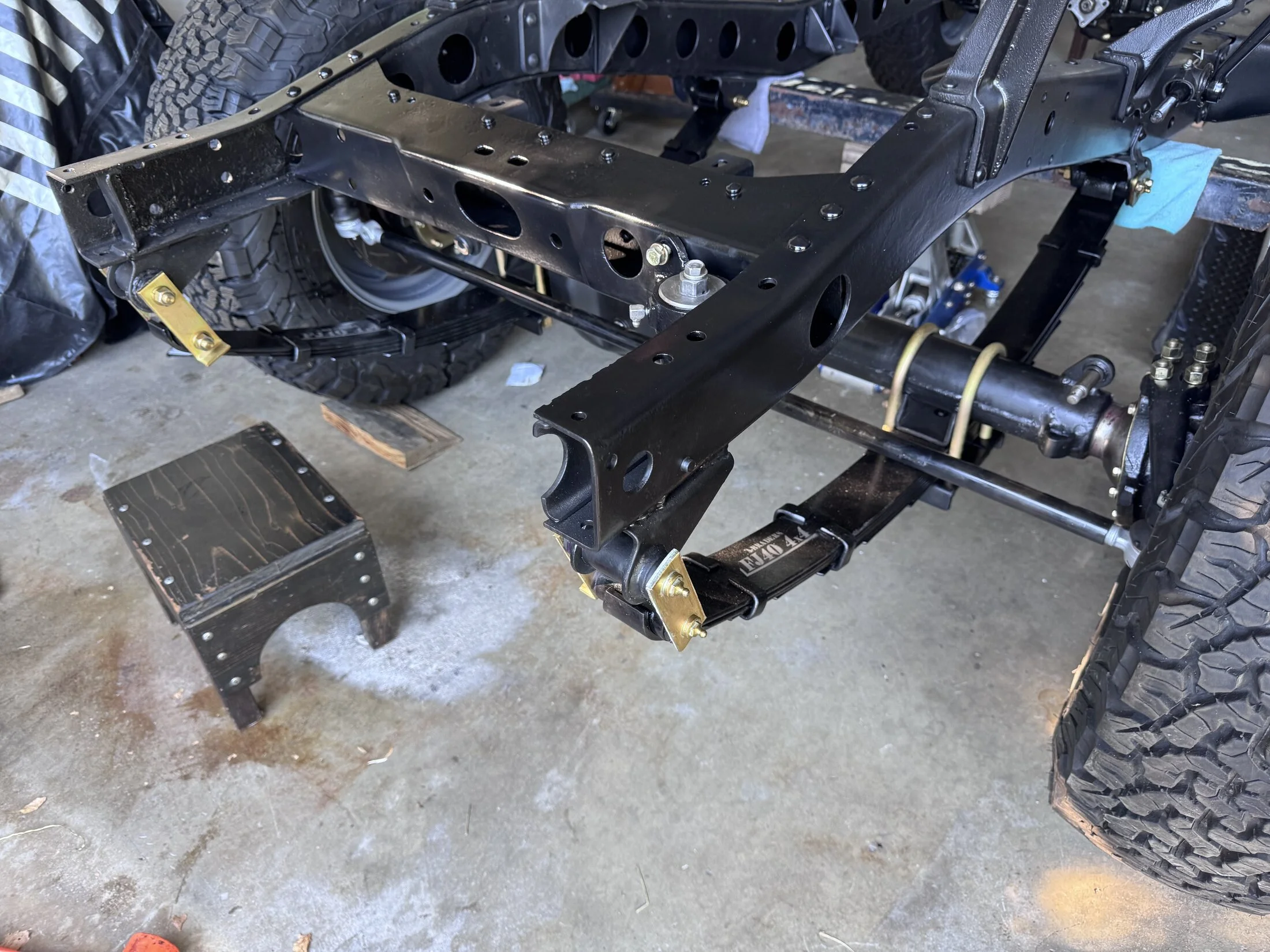

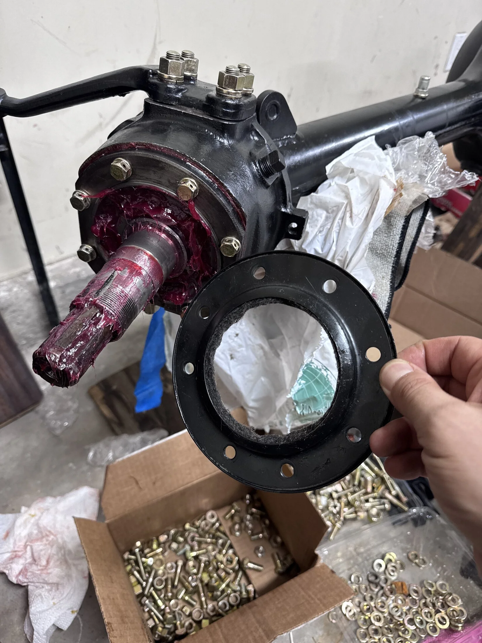

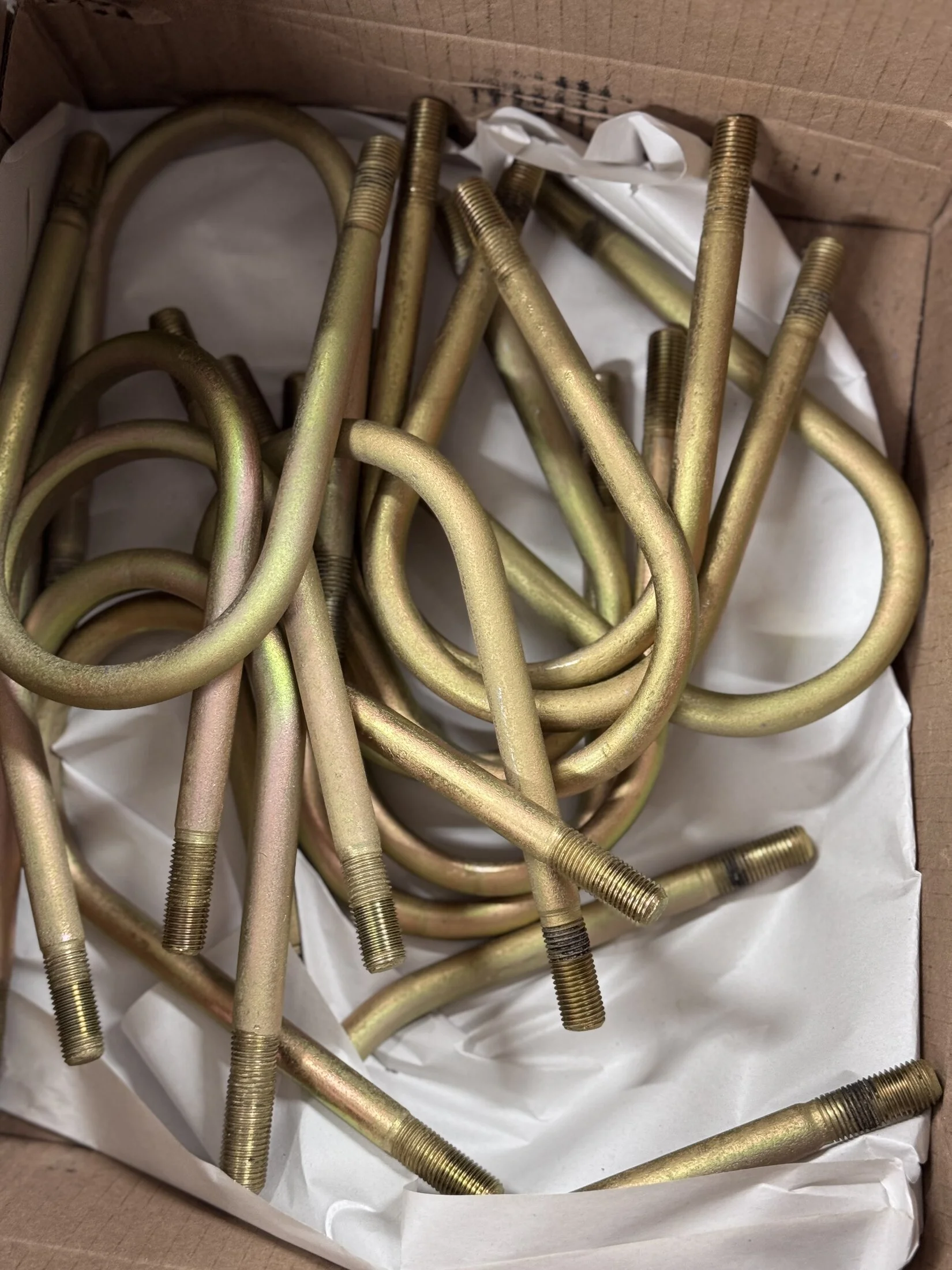

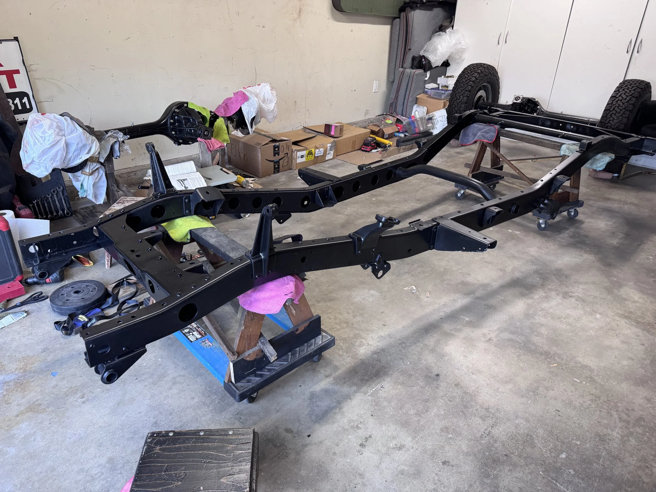

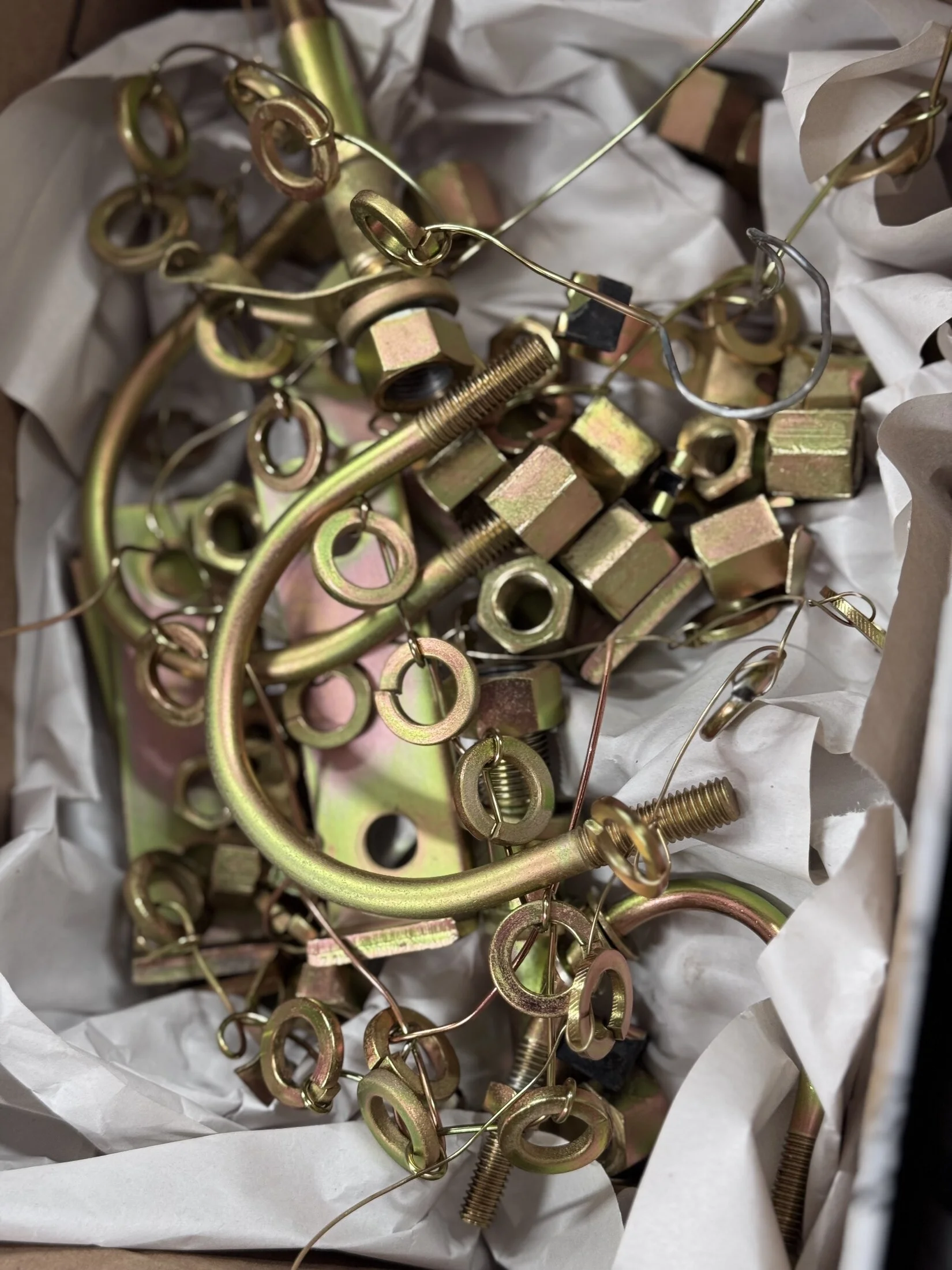

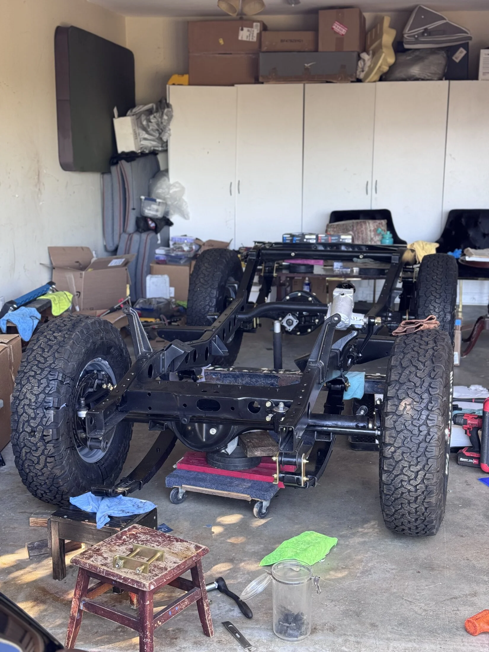

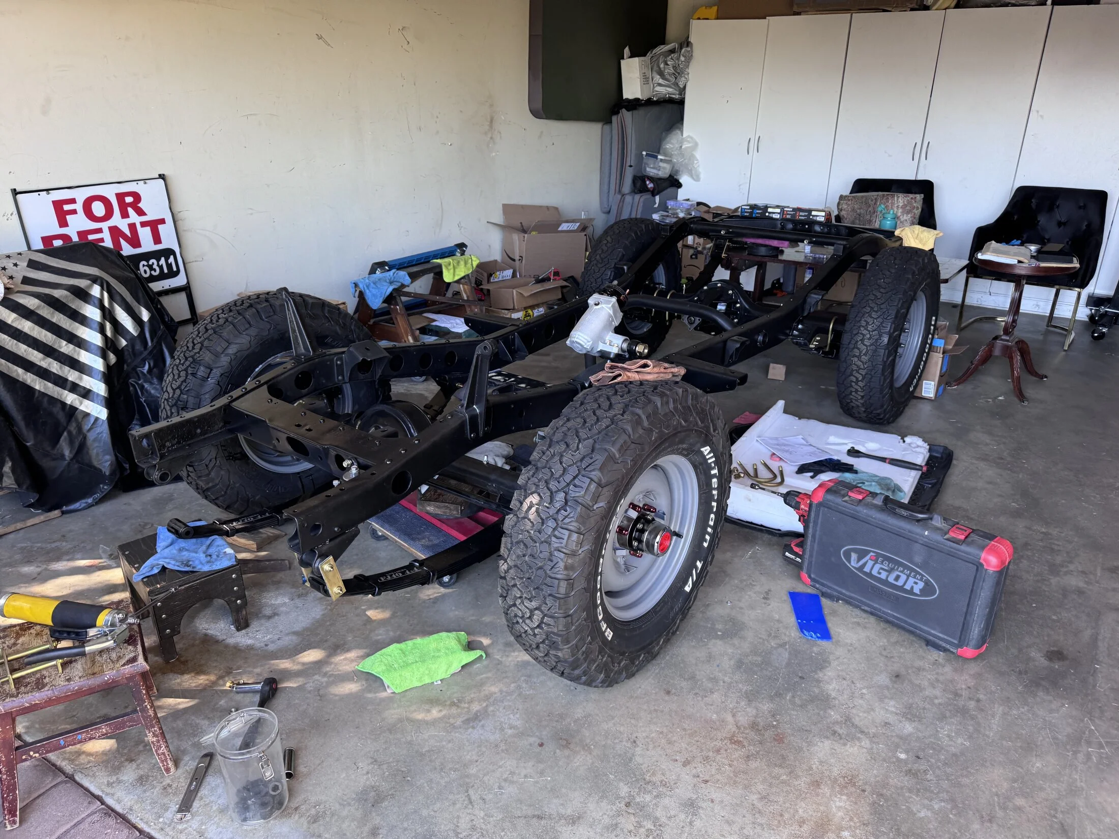

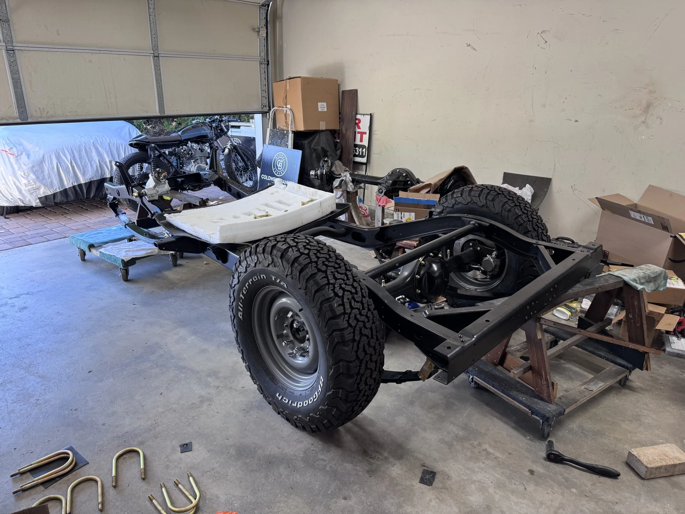

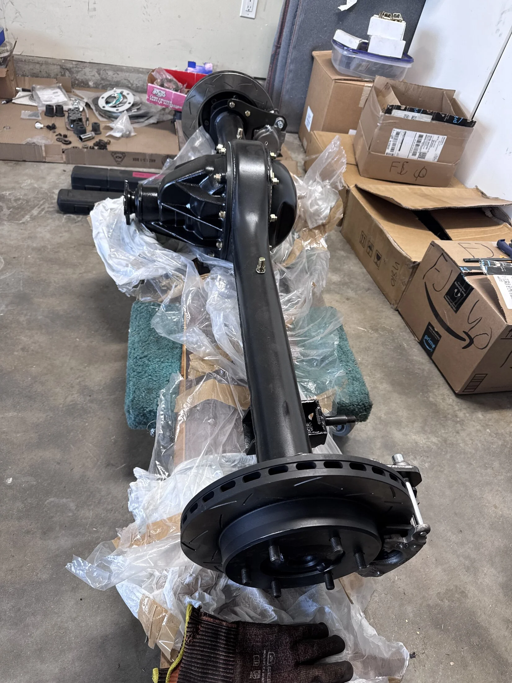

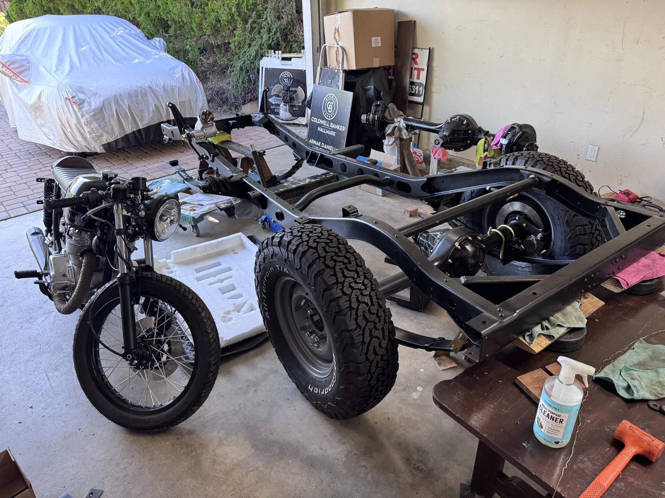

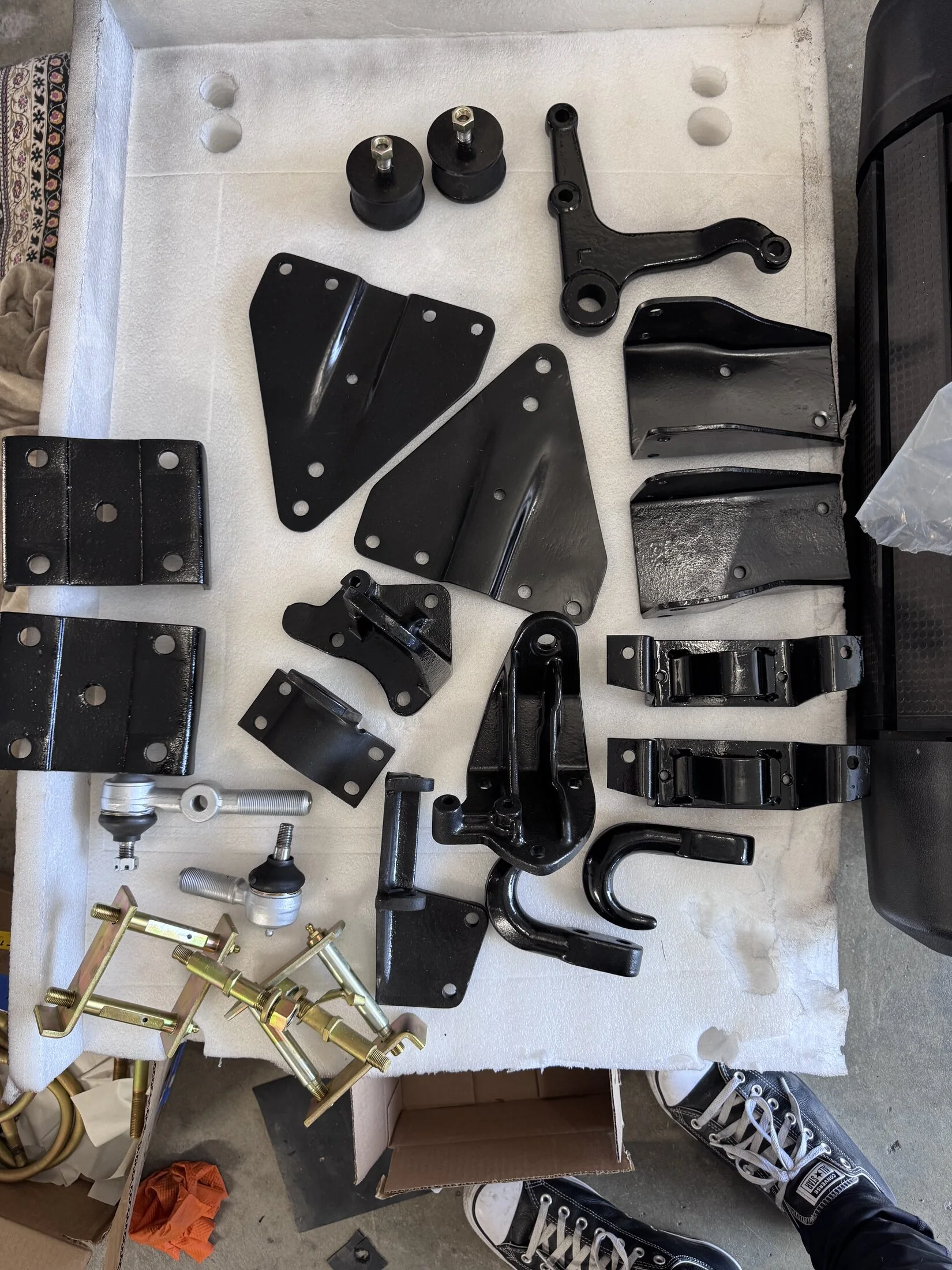

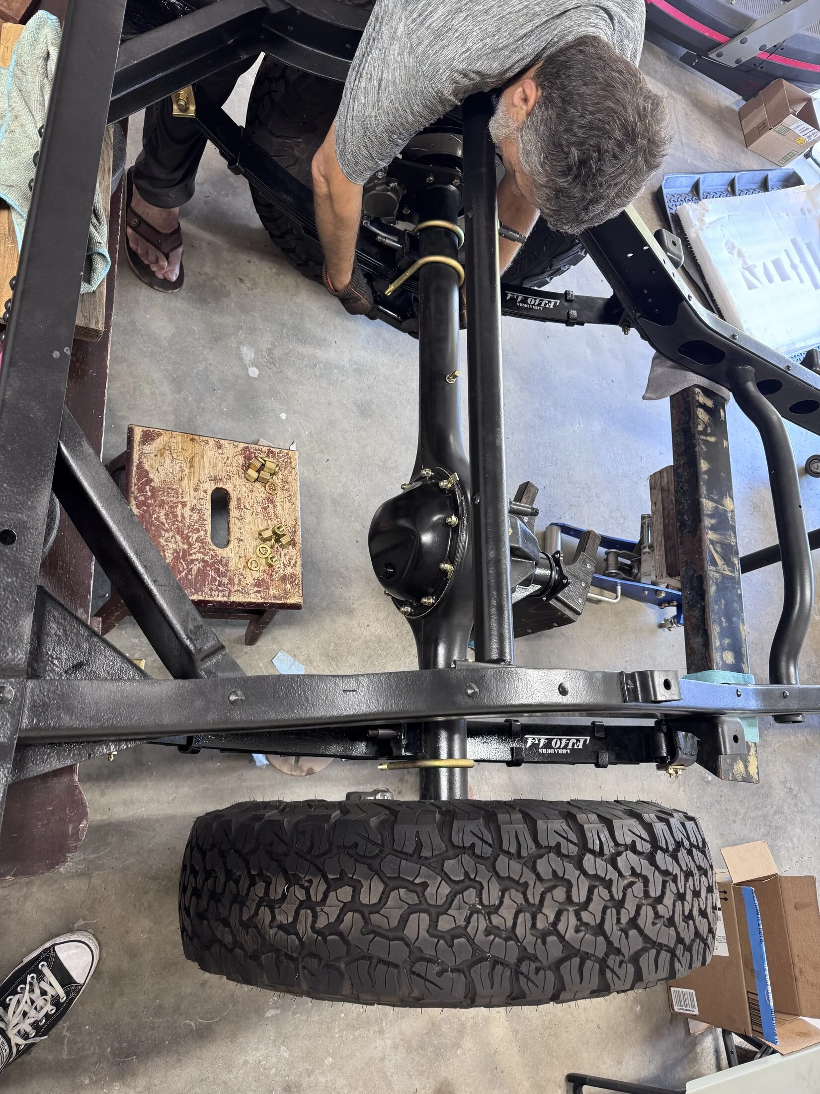

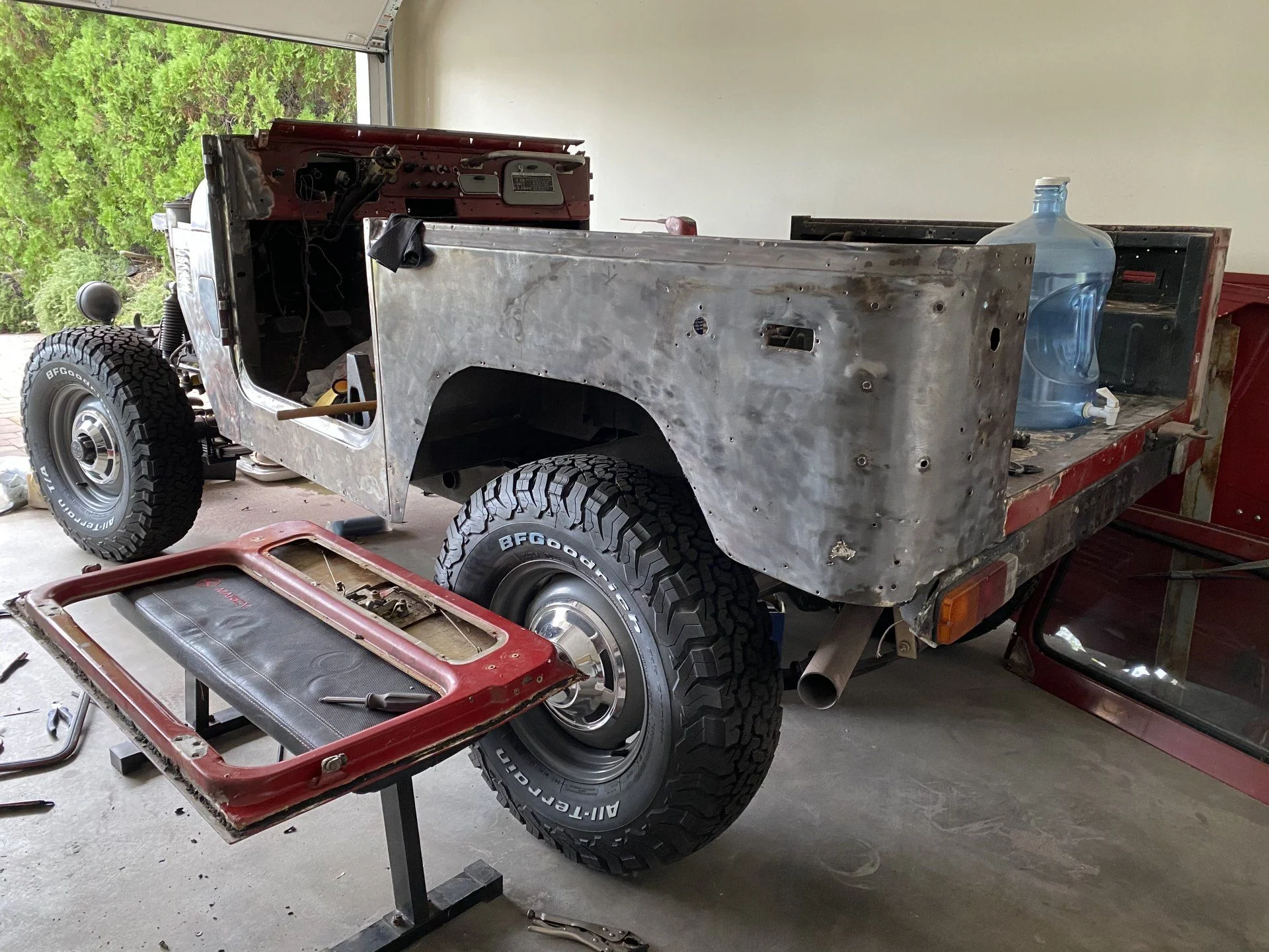

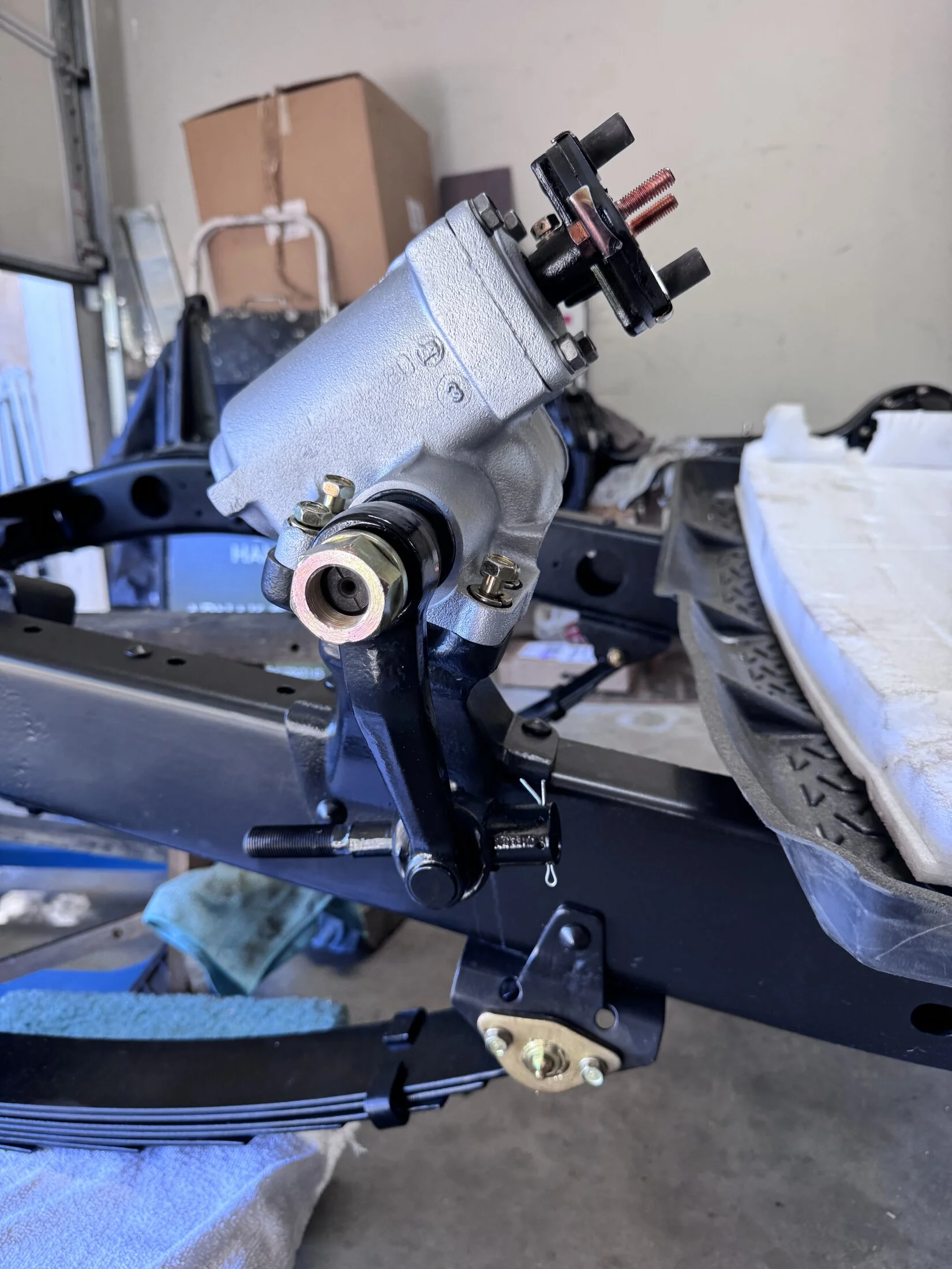

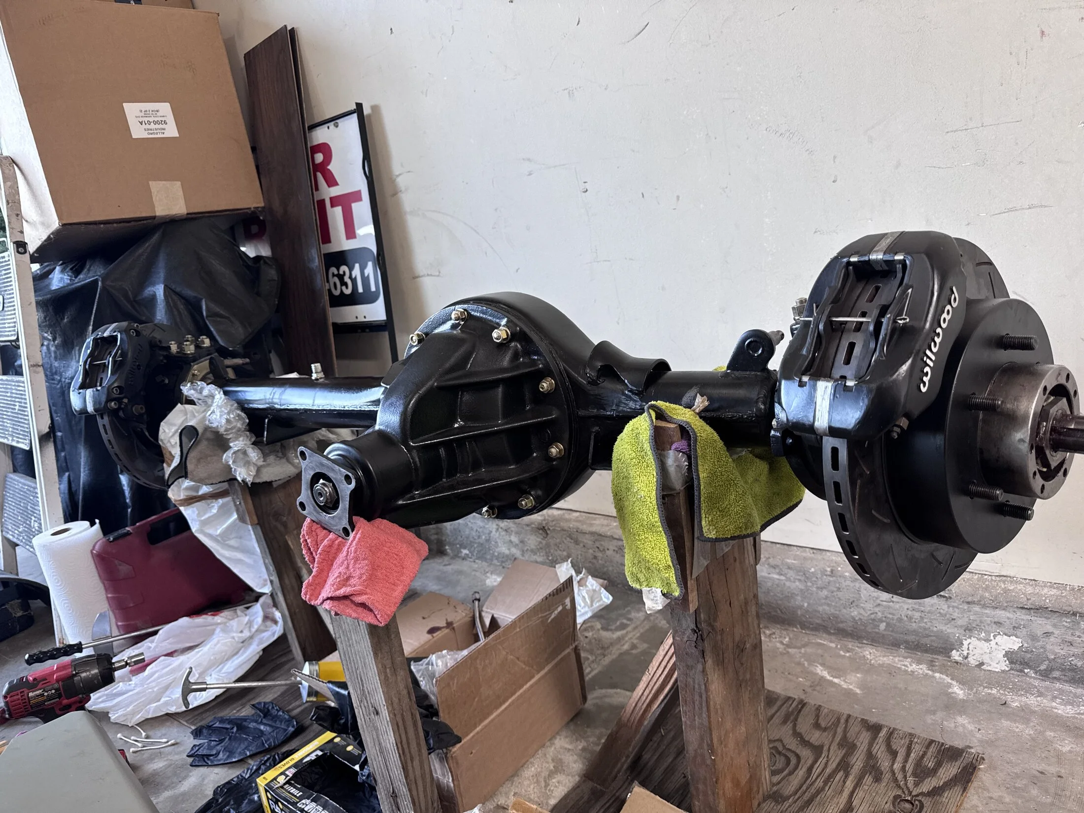

I haven’t posted in a while on the 1974 FJ40 but I’ve recently found the time and energy to put it back together again after sitting in my garage, I’m putting a bit of time everyday wanted to give you guys some update shots on the build

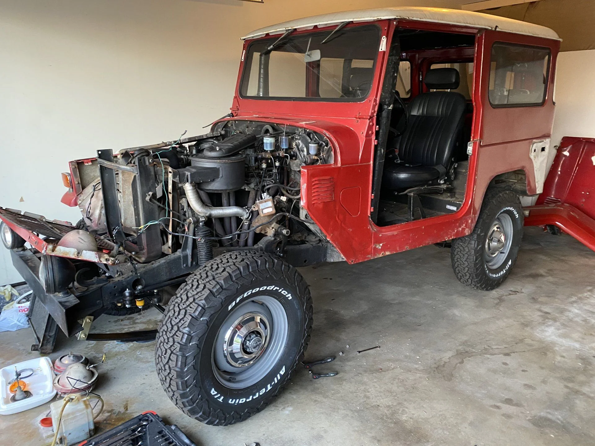

Some more progress today on the #fj40 I found out the original color was nebula green, should I stick to that? Btw should I weld the original body together and do original 1974 engine which is the f 1.5 engine? Or go 2f? V8? Cummins diesel? Budget $unlimited

My 2/74 had the F1.5 replaced with a 10/75 2F. Also has the original 4 speed. Are you aware that the frame cross member on your truck is incorrect for a 74/4speed? It should have a curve in it to clear the parking brake drum.
I did not know that, basically what happened was then I bought the truck everything was wrong with it if I scroll back enough in my album I’ll find the photos but basically my frame was bent on the 74 and the owner who sold it to me never told me that it was bent or in an accident before, and I had to find a donor frame, I welded off the vin from my frame into this frame, I think it’s a early 70s or late 60s frame I picked up … that’s good to know tho I’ll find out what to do next to fix this haha
is there anyway to get more juice out of the f1.5? Maybe upgrade to fuel injection, upgrade exhaust?
Oh sure, you can get a little more oomph out of the 1.5F engine. Bored, balanced, after-market cam, valve job with chevy valves and port-matching and polishing, headers are available and good. Dizzy re-curve, carb rebuild help. But it's still an F engine.
V-8s have been done to death. I've seen 454s and Mercruisers, heard of a Jaguar V-12 in a 40. I still like the F because it's what I know.
