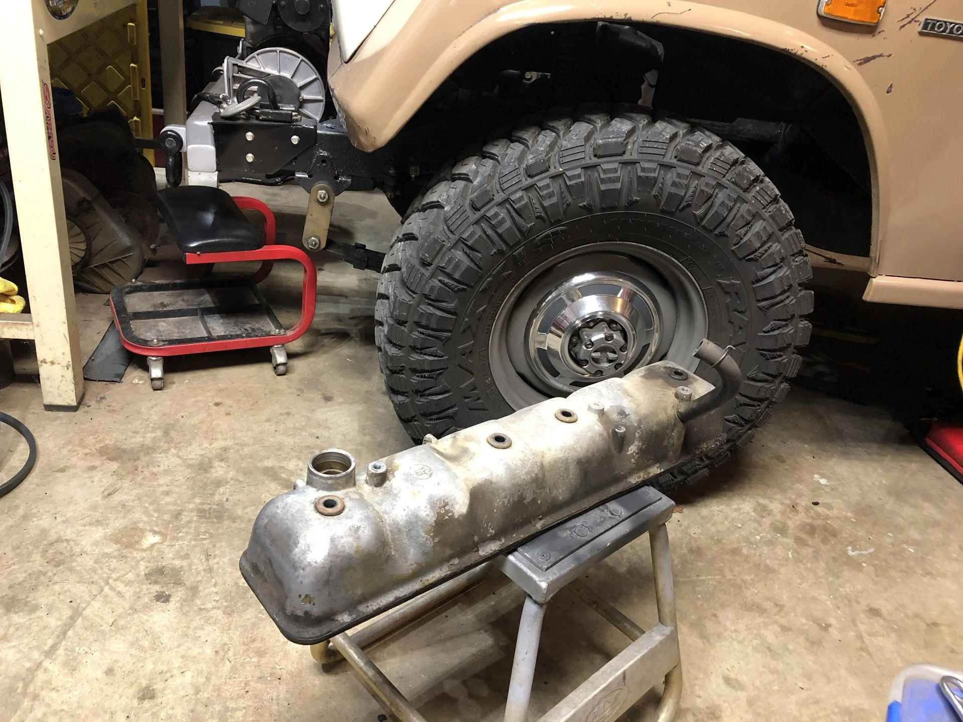

Sandblasted the valve cover and sprayed it with VHT cast aluminum engine paint and finished it off with a couple coats of VHT clear engine paint.
Before:
After:

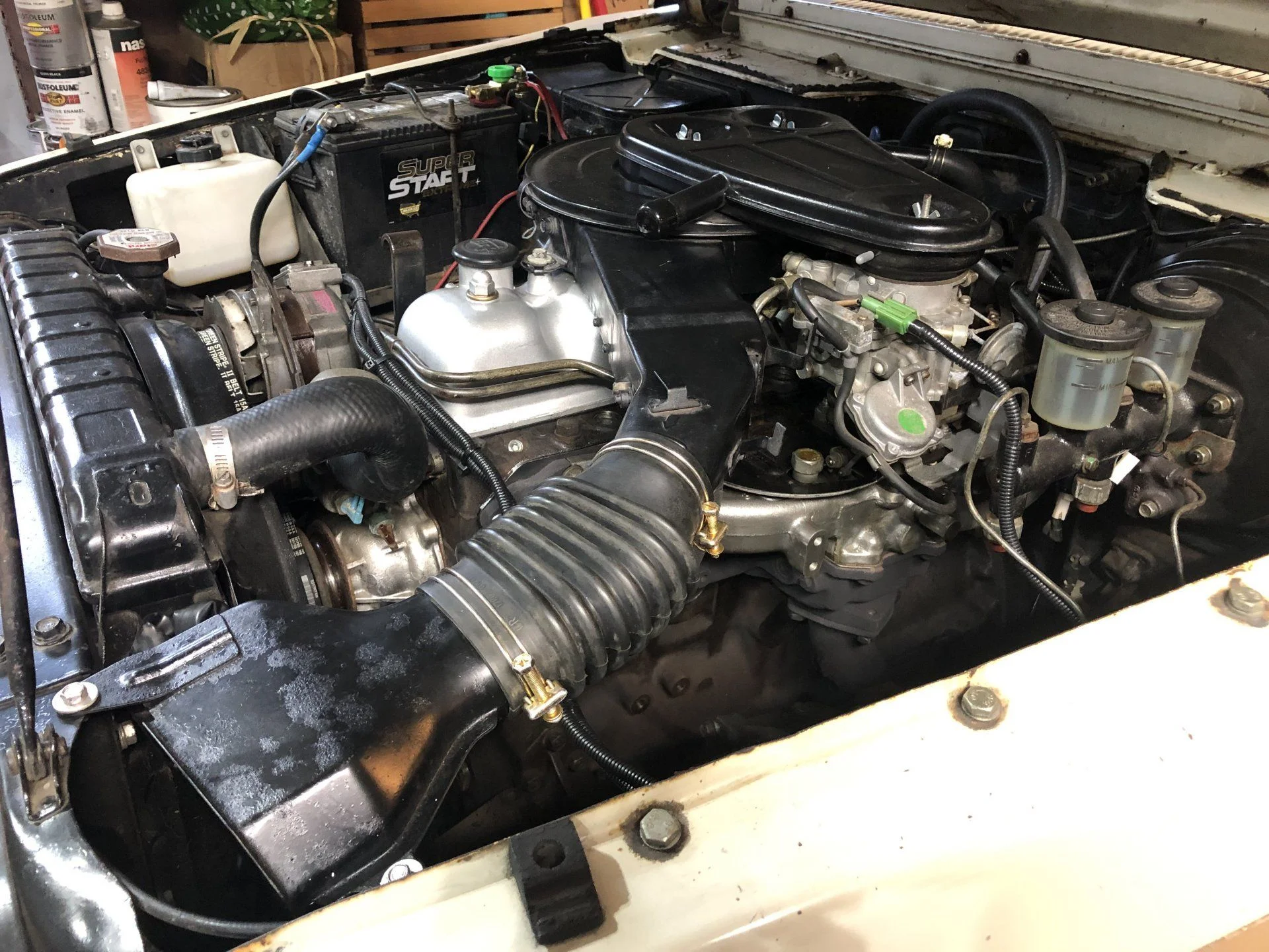

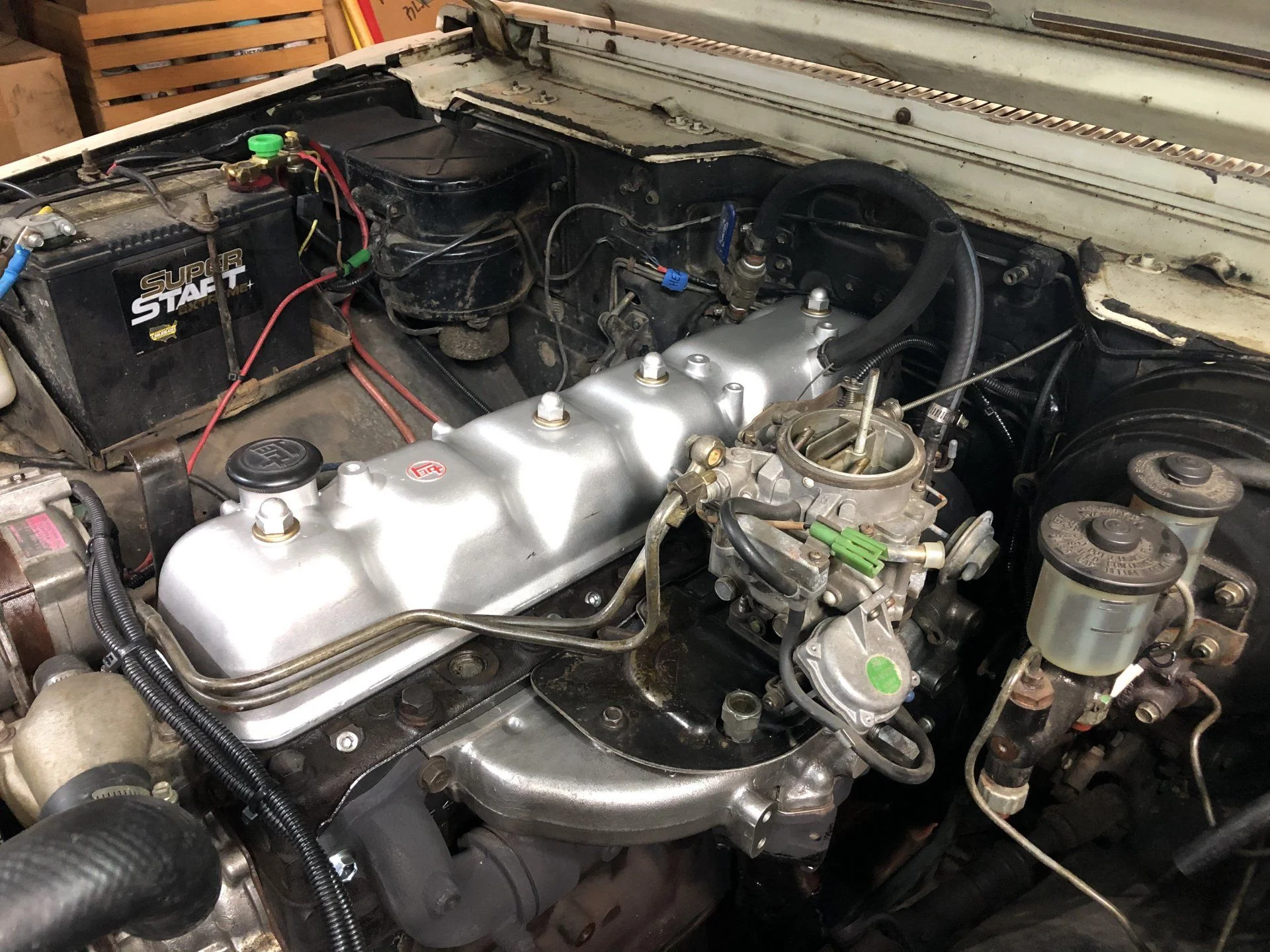

It’s coming back together:
How long does it take to warm up and how well does it run while warming up?
I’m in NC, so the weather is usually mild. The truck is normally easy to start without the choke and warms up quick (within a mile or two of driving). I have not tried to drive it yet without the flapper, but I don’t expect that I will see much of a change. My flapper was stuck in “warm mode” directing exhaust down. A screw had come out of the flapper and it was wedged in place and not rotating as it should.
