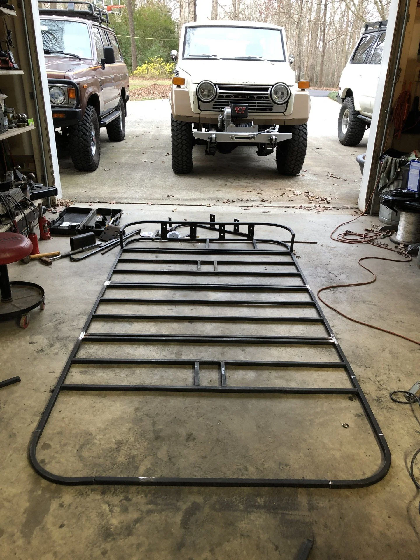

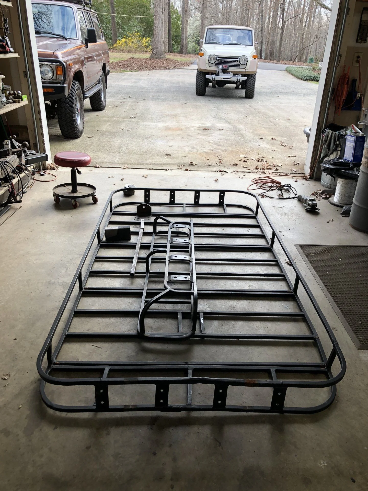

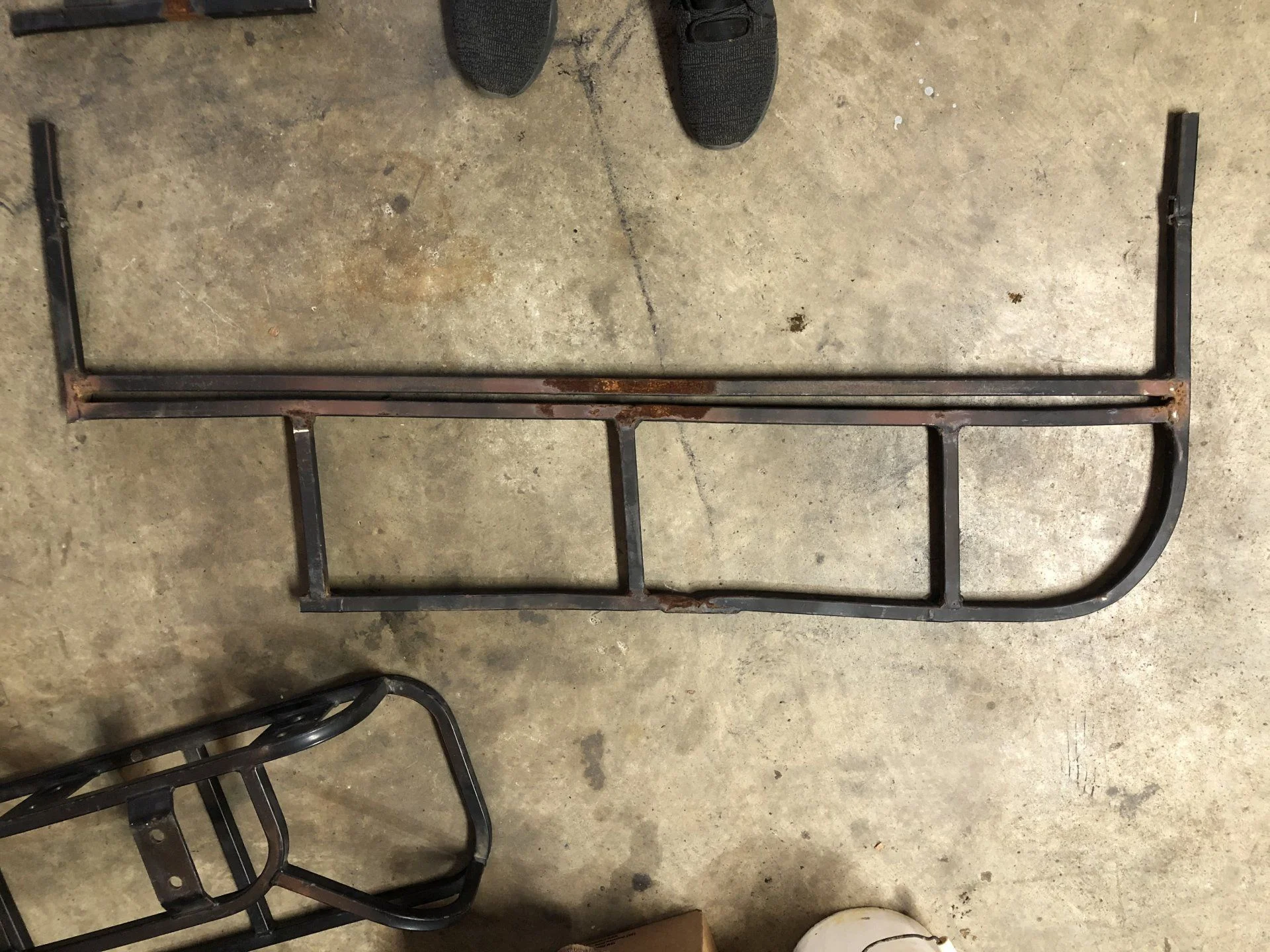

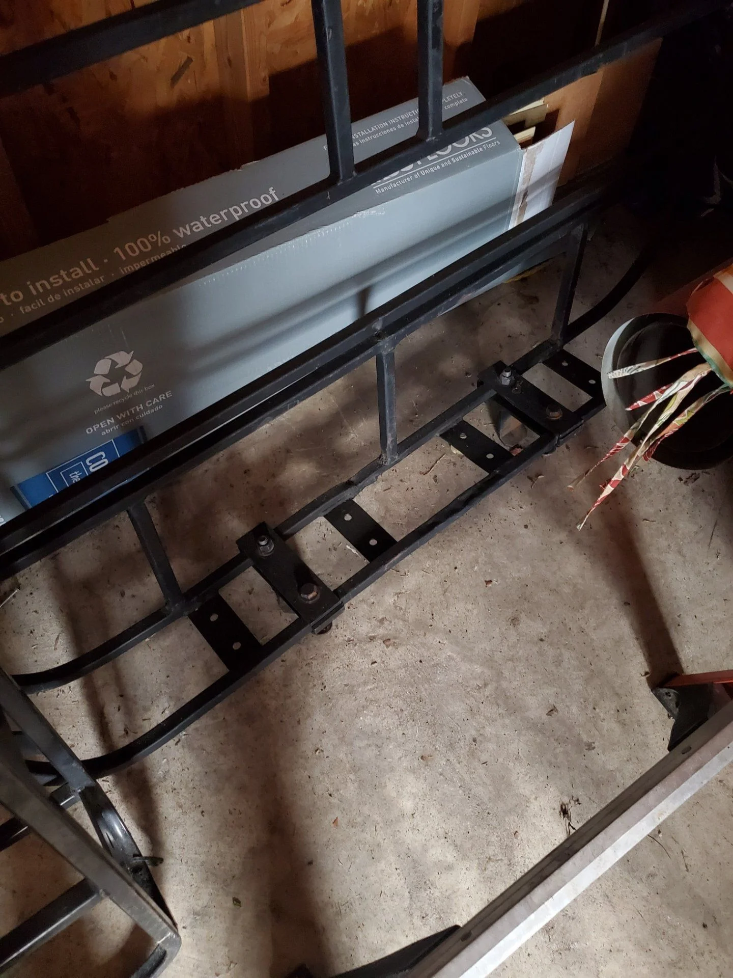

I bought an old full-length roof rack from @Swampfox58 last weekend. Not sure the brand. It looks like either a Safari rack or maybe an old Garvin Adventure rack. Once I got it home, removed the legs and sat it on a level floor, the flaws became more obvious. The rack has been smacked pretty hard in the back and someone did a less than stellar job of repairing it. It was bowed, crooked and had several sections of smashed tubing. Lots of booger welded repairs too. I could have just installed it as-is and let the wear and tear tell its story, but I am a roof top tent camper and having a flat rack allows me to be able to mount a tent. After much deliberation I have decided to cut the top rails off of the rack and use the straightest pieces to repair the bottom, turning it into a flat rack. It's a work in progress at the moment.

Rack off truck:
Bad sections:
Here's the direction I am headed with it:
Sweet! Gonna be doing something similar. Like the flat rack concept - minimalistic and less weight, but there to tie something down and hold it if needed. Also great for distracting eyes from roof flaws!
I hope I'm doing the right thing. These old full length racks are rare as hen's teeth around here, and they look good even when they are beat up (kind-of like pigs do). The functionality of the flat rack concept, weight savings, and the benefit of having some leftover sections of tubing to make repairs and square everything up made my decision for me.
