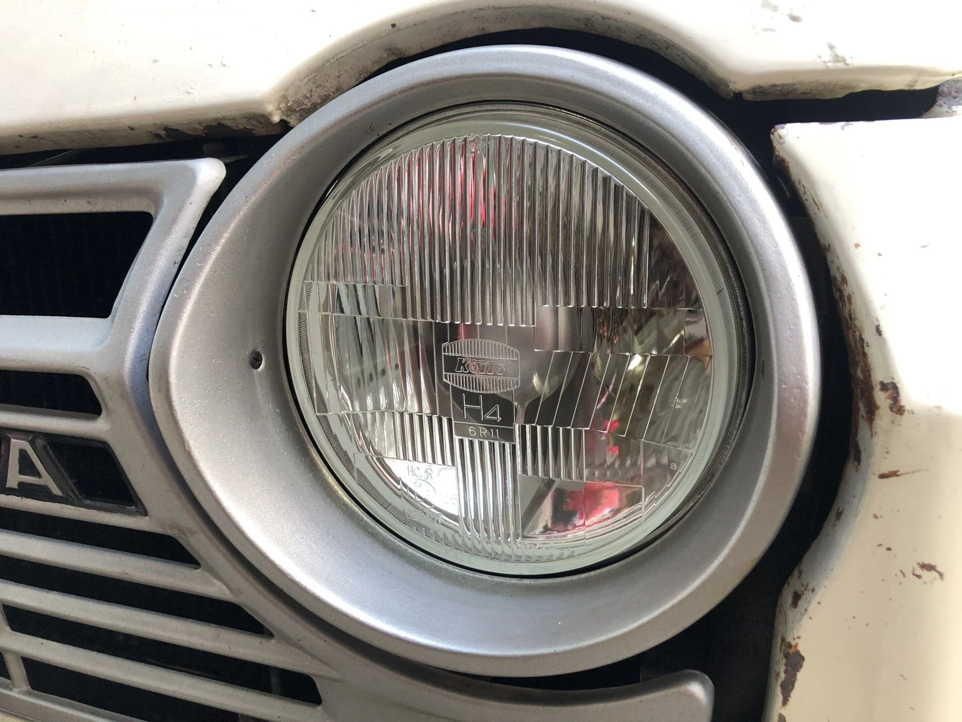

...and tonight ‘Ol Bucky got cornea transplants!

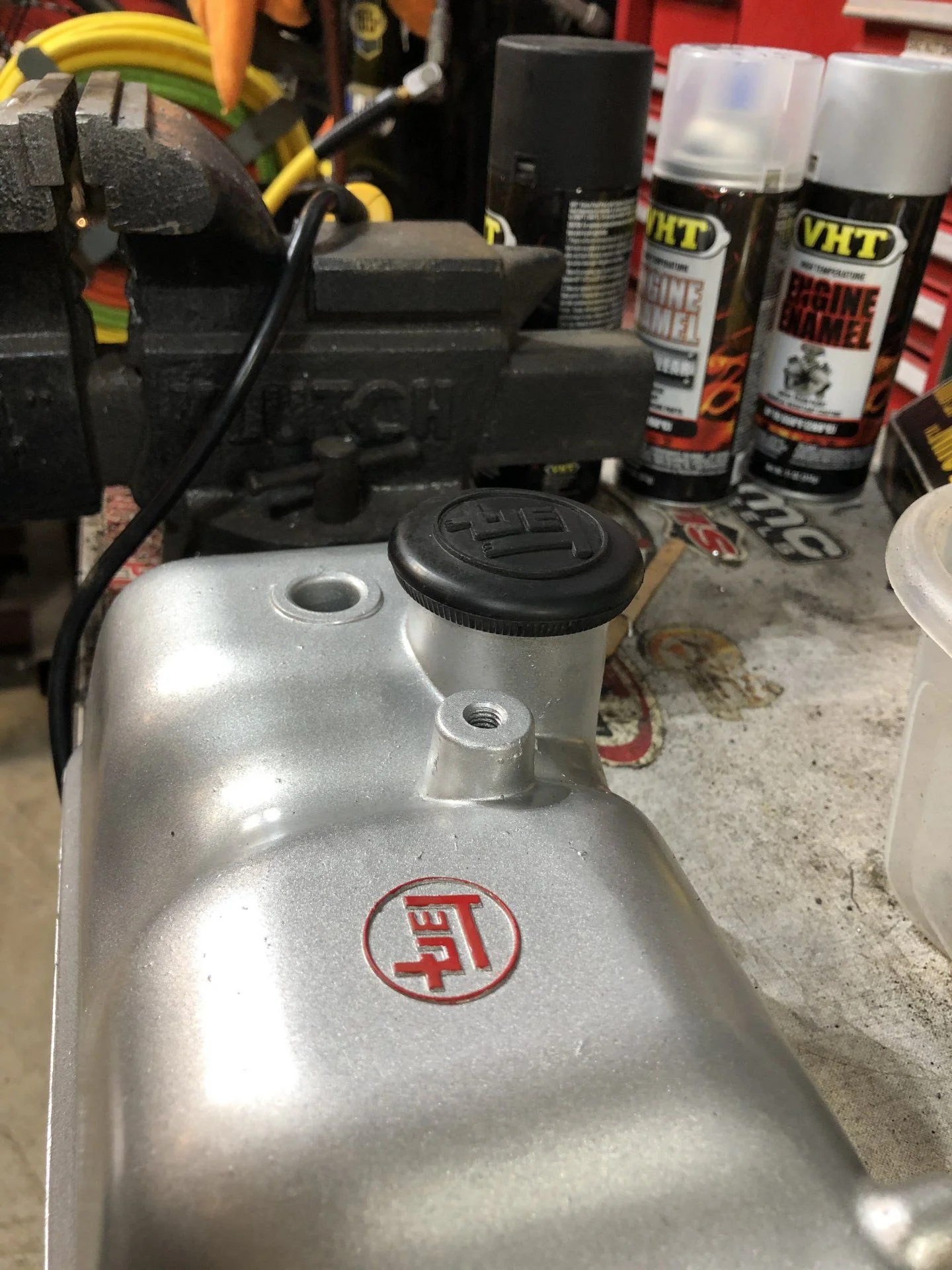

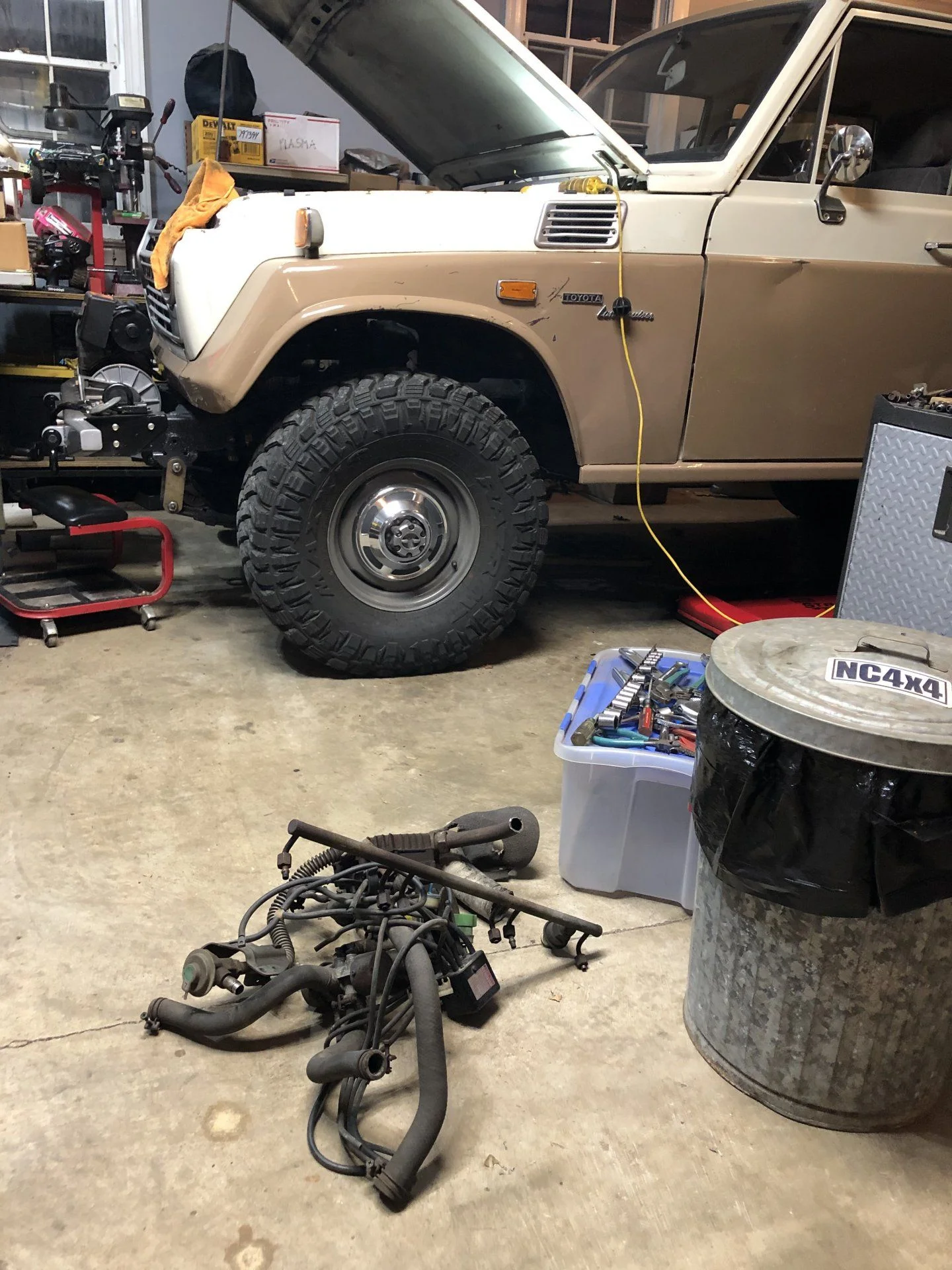

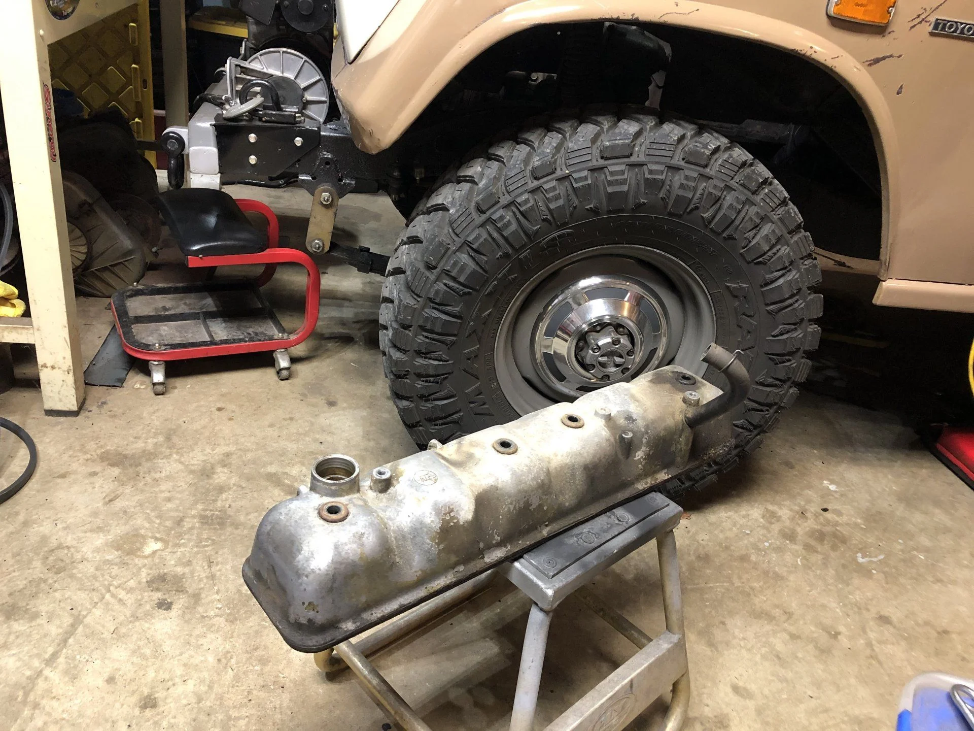

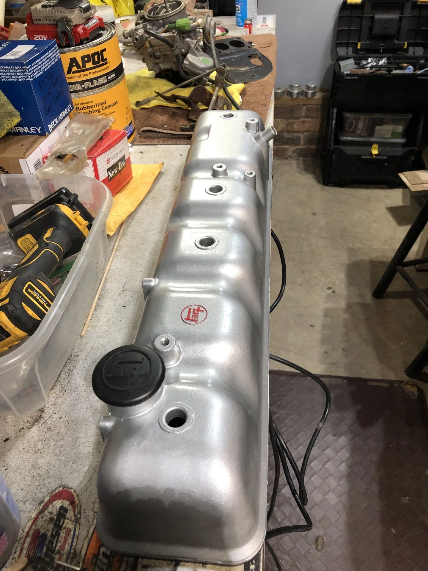

Since I have owned the truck, Bucky has suffered a super annoying exhaust leak from the thermoreactor flapper shaft. I finally got tired of listening to it. The fix something went something like this:
Pulled the carb and all the smog bits (none of which were actually functioning). Pulled the manifolds. I used a plasma cutter to remove the exhaust flapper (which was missing a screw and rattling around inside the manifold) and cut out and removed the flapper shaft.
Machine shop resurfaced the manifold and
tapped the shaft holes in the exhaust manifold for set screws.
Sandblasted the valve cover and sprayed it with VHT cast aluminum engine paint and finished it off with a couple coats of VHT clear engine paint.
Before:
After:
I’m waiting on some Jim C desmog bits to show up so I can start reassembling this pig.
