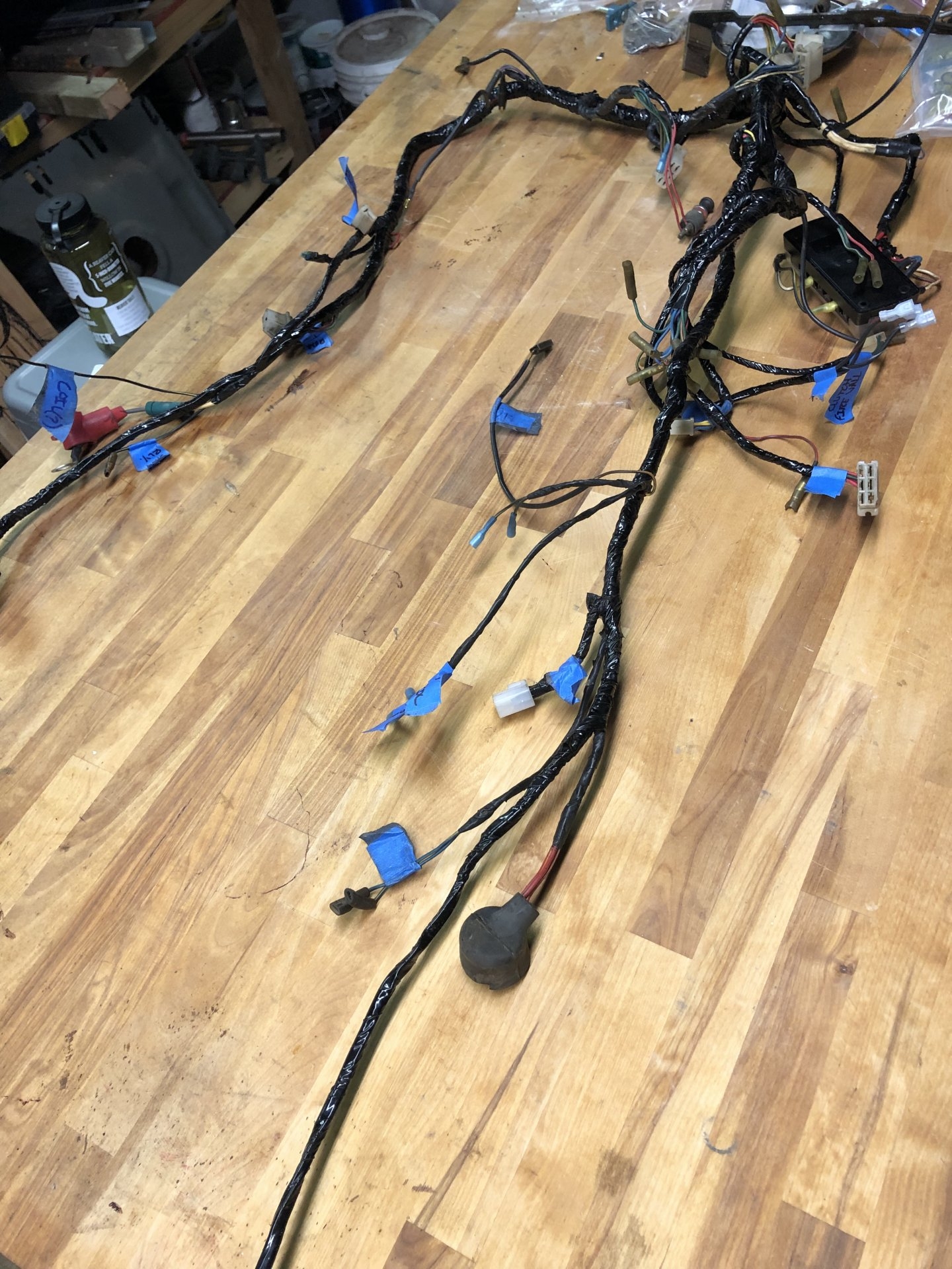

Harness is out. Wow what a pain. If I was on the fence about getting rid of my vac transfer case mechanism and converting to a floor shift, I am firmly off the fence. Also why does the front cowl vent have to be so difficult? Bloody knuckles. Anyways....
It looks so simple laid out. Honestly, issues aside, I am glad I am the one going though this exercise because it is giving me a ton of insight into my rig.

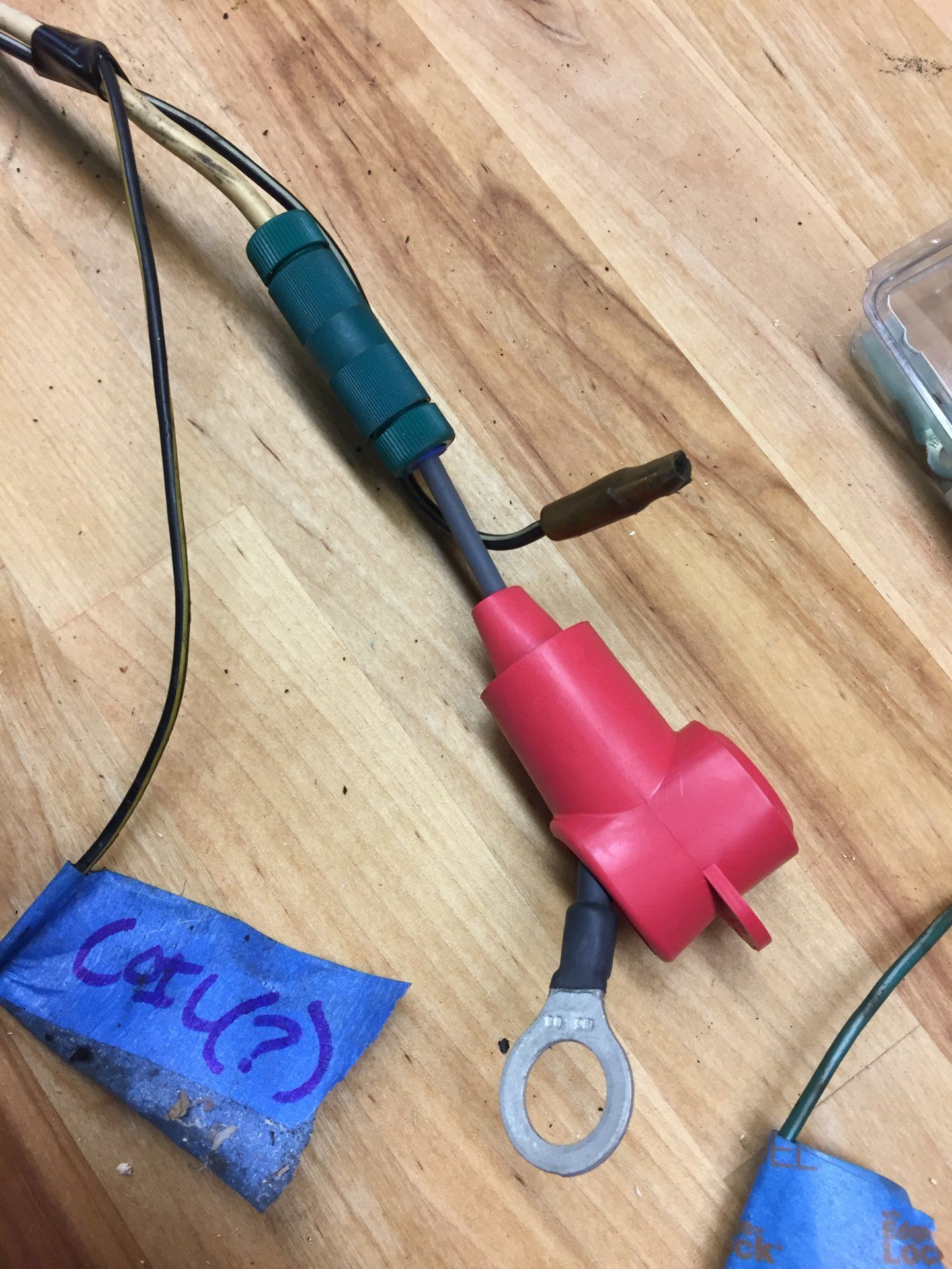

It appears the Black-Red wire from the ignition switch melted all the way back to the White-Blue wire that runs to the alternator. I spent a while removing tape and melted sheathing. I will test circuits when my buddy is around to help but nothing looks damaged other than this one and the melted spot right the top fuse on the fuse block.
Does anyone have any insights into why this may have happened? Based on where the fuse block has a melted spot I am going to focus my attention on the light circuit, however those wires appear OK, certainly not as bad as the Black-Red wire. Perhaps the incident was between the Black-Red and it grounded at the block, just upstream of the fuse (it was not blown)..? Im just spit-balling here because not knowing is bothering me much more than if I knew what happened. :bang:

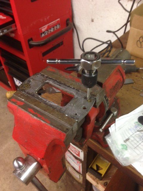

So above I mentioned I plan to switch to the Blue Sea Systems fuse block to have modern fuses. To do so I needed to make an adapter. I got the drawing off the blue sea systems website and added the holes for the M6 mounting hardware currently in my firewall. Then I had one of the guys in my shop cut this out of 1/4 on our water jet. He cut the pilot holes for the M4 cap screws that I only wanted etched, but I told him it is fine because the part is symmetrical.
I cleaned off the scale, drilled and tapped the M4 holes
I am using countersunk M6's to attach it. This will allow the fuse block to sit flush. I am also going to use some synthetic washers in between just to keep it off the fire wall. The window is just for weight and to keep it from touching more than it needs to.

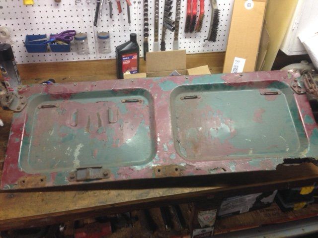

The tailgate rotted out near the passenger side hinge. When I do a 3/4 tub Id love a tailgate rather than the half doors so I hope it can be saved

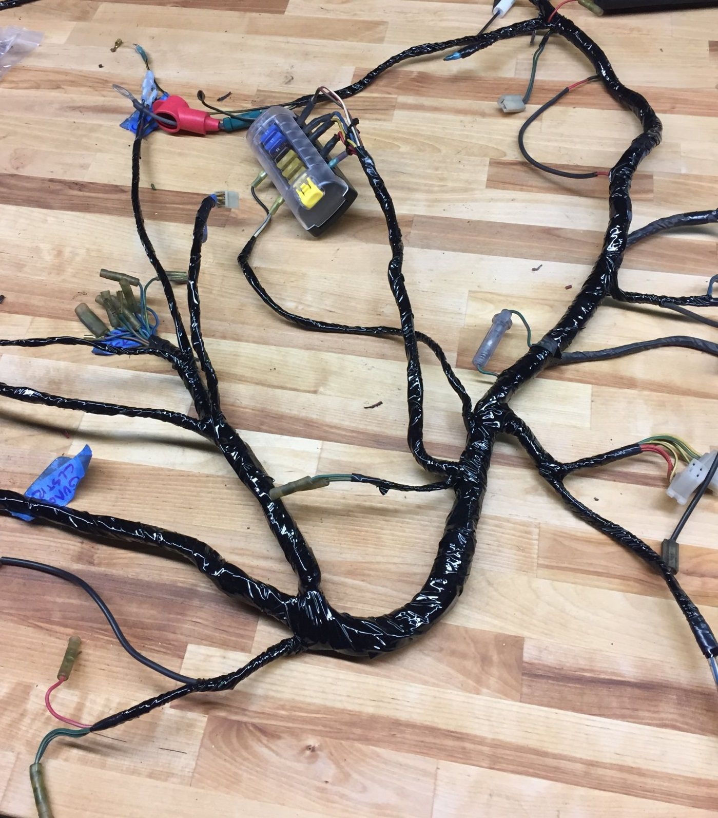

This harness rebuild has been slow going but I’ve learned a ton so it’s absolutely time well spent. Really happy with how it came out and the upgrades made such as marine terminals where I could, some thicker wire in key areas, the fuseable link and the fuse block. My buddy came over and we tested the circuits as well as a few switches so I feel confident it’s ready to go! My fiancé helped we wrap it with the non adhesive tape. That is definitely an easier job with two people! Now time to get it back in my 40

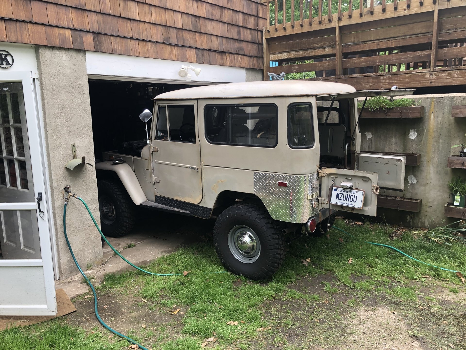

With my tiny 1 car garage just getting it out so I could remove the seats and all the stuff I put in it was a project in itself. Also one of the rear drums locked up on me which explained why it wouldn’t roll at all.

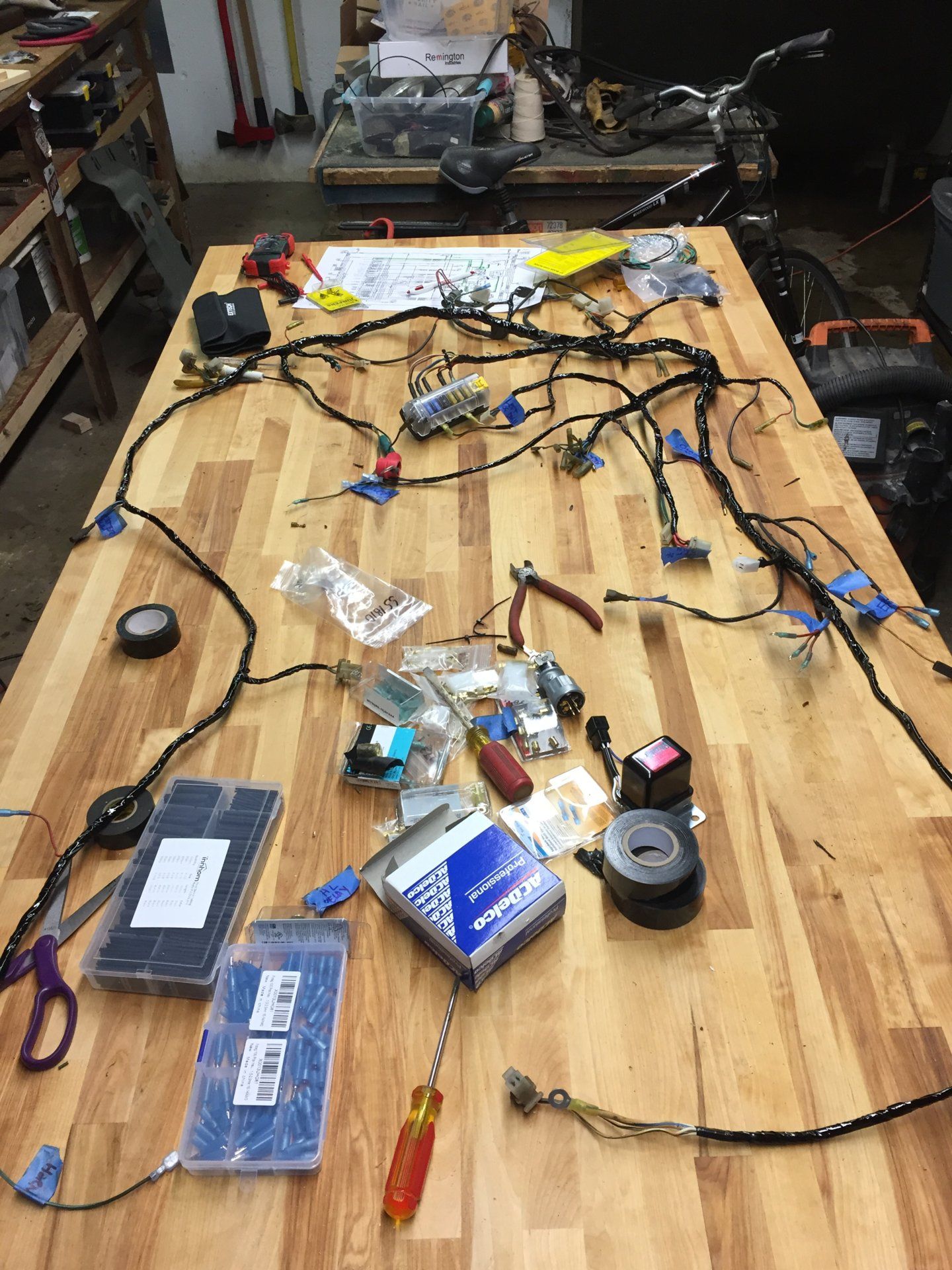

I spent several hours on my back with my head under the dash just sorting things and trying to figure out what changes I needed to make to the harness. I am rewrapping some sections and extending a few wires to make life easier. I deleted the cowl vent which I deeply resent as it’s being the cause of the floor rust I’ve been fighting. The mechanism doesn’t make wiring any easier.
I am also considering a heater delete as well if anyone wants to talk me out of it. There’s just so much more room for activities with it out of the way. The vintage air heater Project Wrong Way used looks nice…
I digress. Get it running. I am rewrapping most of my harness with braided cable sleeve. The plastic wrap was not as forgiving when I realized where I was wrong and this lays a lot nicer. This is a before shot. The kinks don’t look at bad in the photo. I am implementing some lessons learned to make things easier on myself for the reinstall and have a better plan to tackle it.

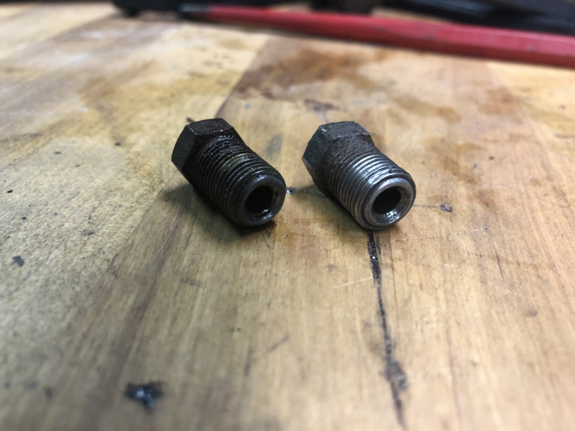

Also the clutch master hard line was leaking. Then it snapped. I’m going to try and reuse these m11 fittings with some new hard line instead of changing everything. Getting the old rusted tube out was a pain but it looks good now and I cleaned them up. Quickest path to back on the road.
Those aren’t the right brake fittings. What’s the build date on your 40?
Its 11/69, and they are from the hard line from the clutch master to the flexible section. What is wrong about them? It measures at 11mm which matches info from a search here. Based on what I read they are discontinued from Toyota, hence SOR and CCOT offering conversion kits to the later model stuff.
Aren’t the early trucks 9mm, w/ 3/16” line?
I think we are talking about different parts. As I understand it the brake lines were 9mm (PO changed axles which included later model brakes) but the clutch master hard tube was 11mm, at least that’s what I’ve read but it matches what I measured
