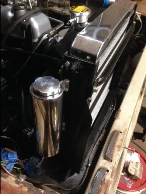

Worth noting though, I did not like how I could not get to the petcock on the Champion radiator so I put together a brass extension and a plug. Its not as nice as a petcock but I figure it is no different than the drain on the block.
I hope it wont leak (knock on wood).
I also installed a coolant overflow bottle. No, its not Toyota, but it was cheaper and SS. The overflow tube extends up inside just below the cap. This should prevent the puddles from the old system that drained onto the floor.

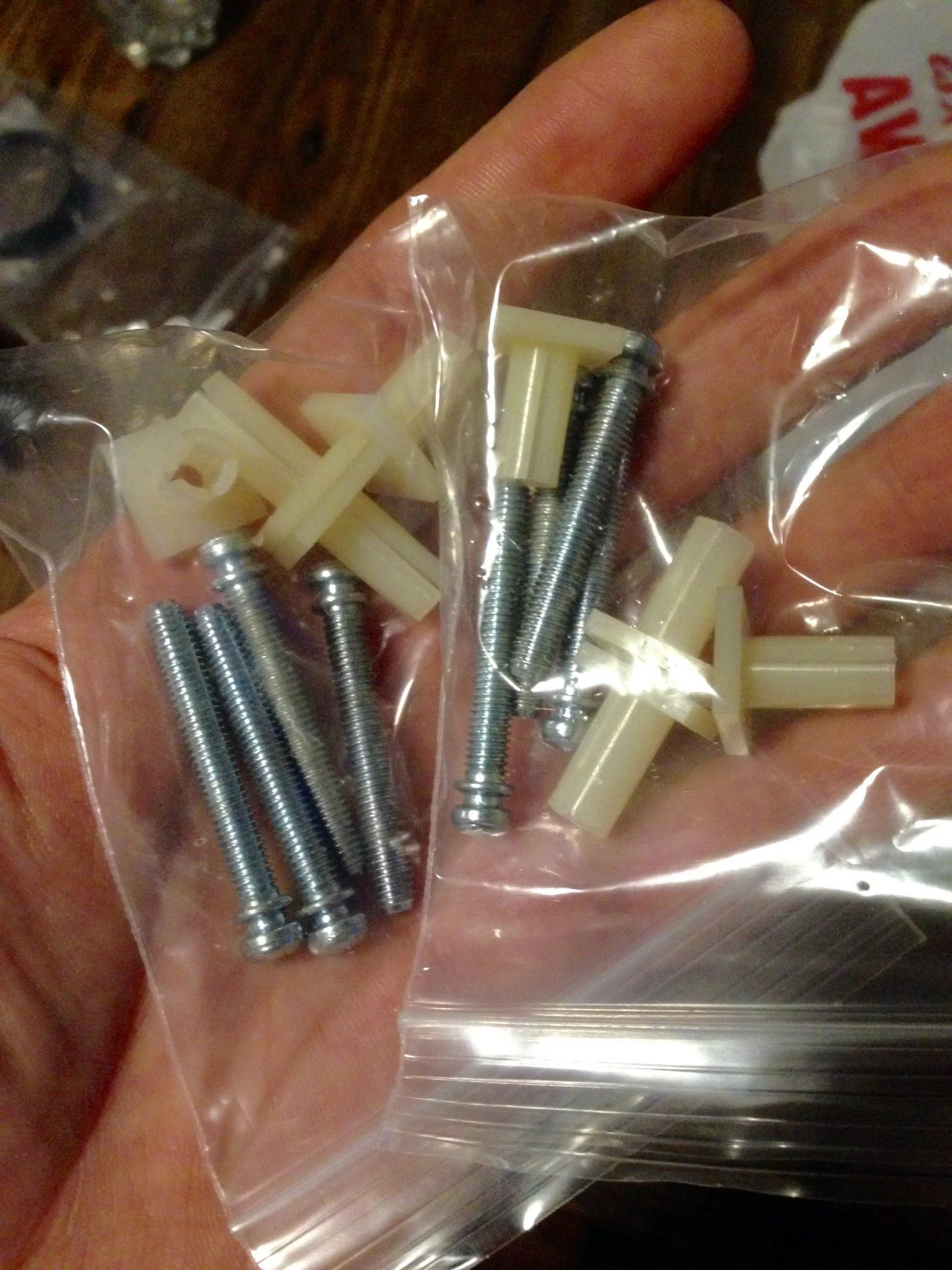

In the meantime I am getting this back together so I can enjoy it. I was super excited to see that @Racer65 sells these head light adjustment screws and grommets because mine fell apart when taking apart my bib. Since I was ordering these anyway, it only made sense to add new mirrors to the order right?

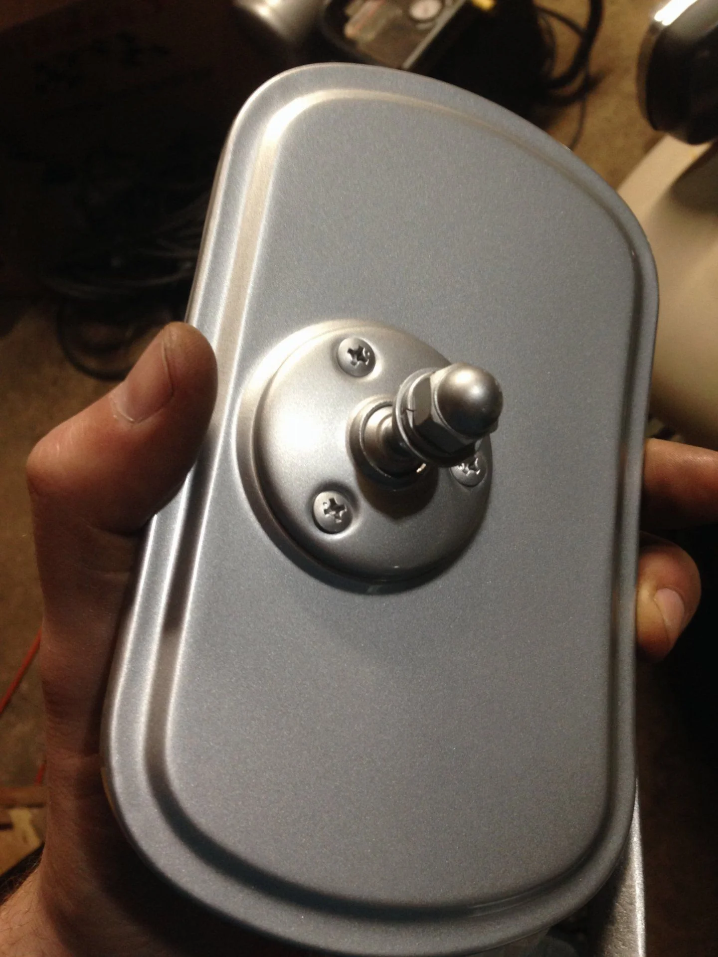

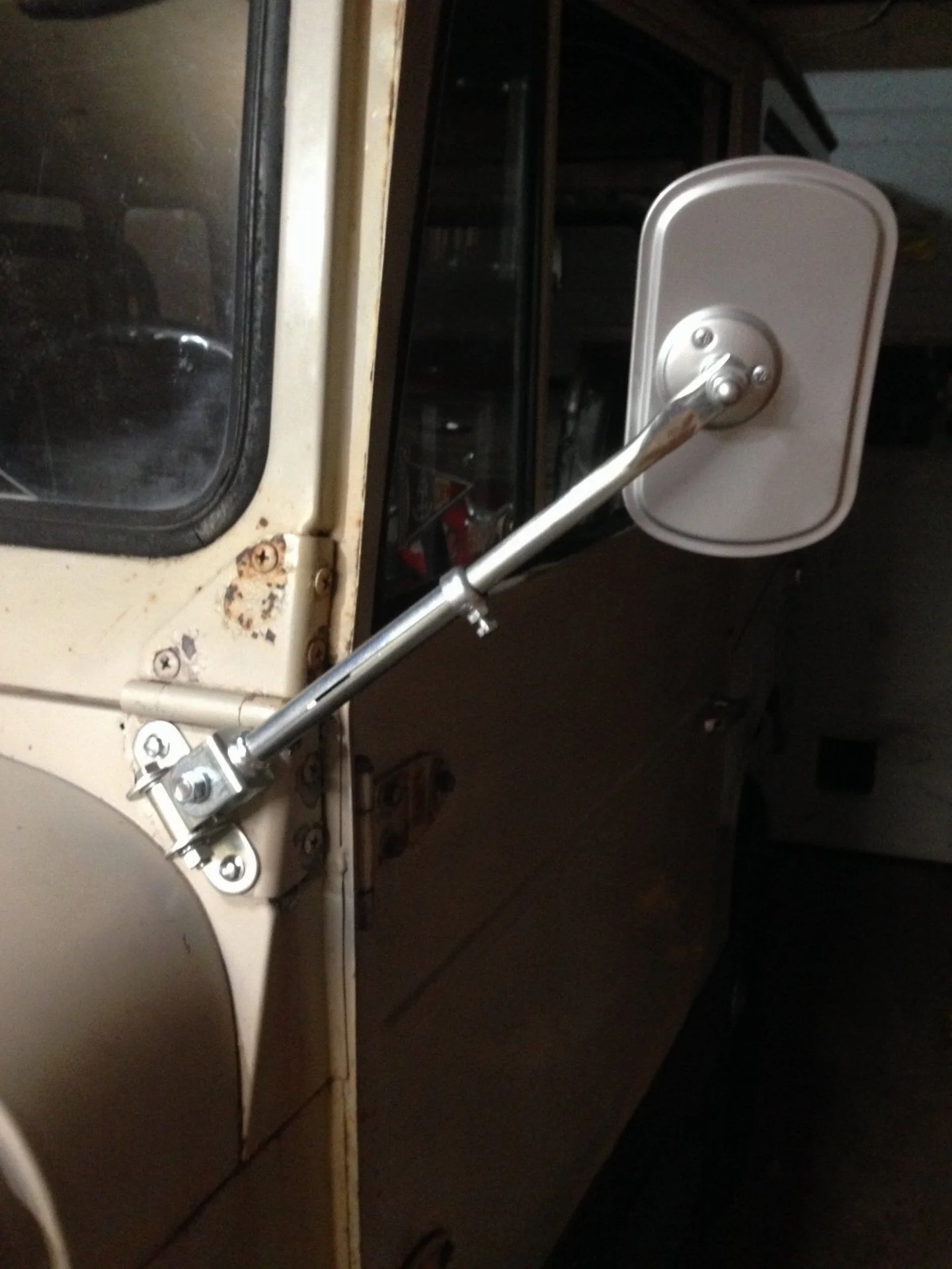

I got the package from City Racer earlier than expected and couldn't wait to try on the new Toyota mirrors. It came with only a driver's side mirror, a cheap looking tiny round mirror. I like the look of the rectangular ones and went with the convex lenses. I must have got the last ones because his site now says sold out.
The old one
New
Toyota, 13mm.... seriously?
I need to weld nuts to the bolts on the other side to try to get them out, that will be on the list for this weekend while I have the welder out.

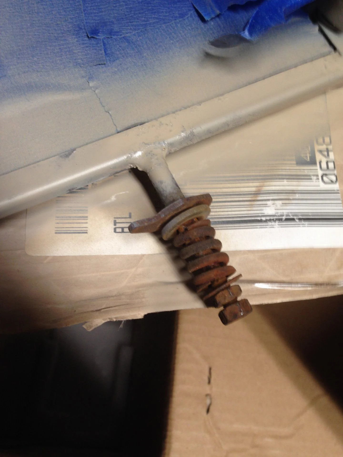

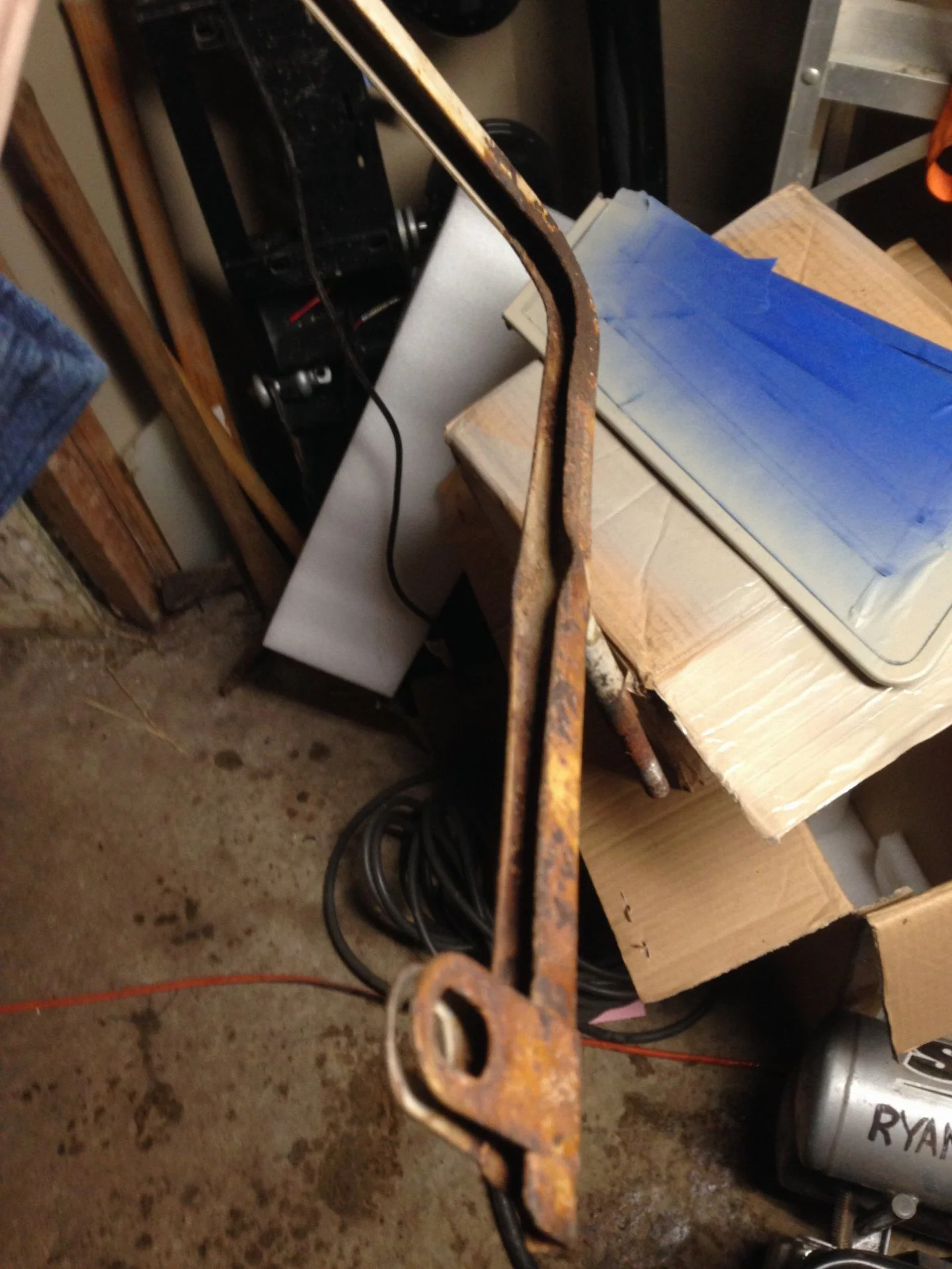

Besides that, I have been cleaning up the engine bay, wire brushing and painting rust and replaced my passenger door vent window. My vent window came with a clearly warped frame and a piece of plexi glass in there that had clouded up so bad I couldnt see through it. I ordered a used vent window assembly from Cruiserparts.net which was exactly what I needed. The new vent window was off a blue truck so I masked it and repainted the frame. Removing the old frame was not very difficult once I soaked it in penetrating oil, the hardest part was keeping nuts and washers from falling down into the door.
The old frame, where it bows out is where it is bent
The cruiser parts window came with hardware. I picked the best stuff between the two. Also put the jam nut in the correct place. The funny shaped stop plate goes over top of a piece of sheet metal inside the door and the washers and springs were under it.

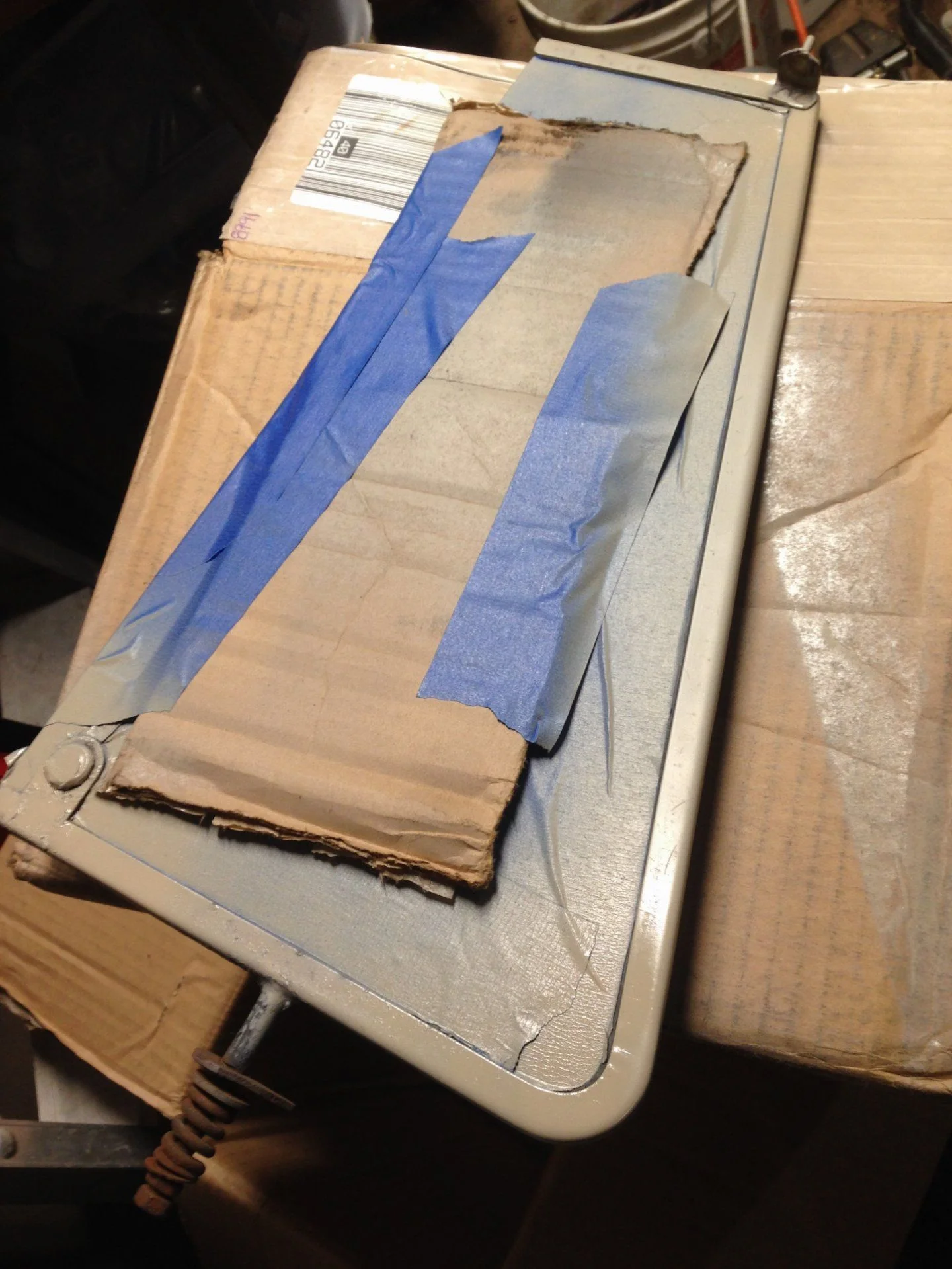

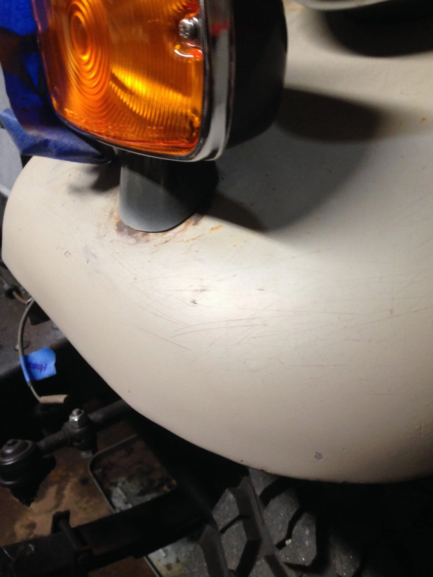

Since my FJ40 is sun faded, has rust poking through and a few spots someone tried to color match with a rattle can, I wanted to touch up some areas just until I can get to doing proper body work. I got this paint from automotivetouchup.com. I did the vehicle look up and am really happy with it! It dries fast and matches better than I could have hoped for. Ive used it for small things like the hinge when I replaced the mirror or to cover areas like between the bib and fenders where it was a lot of exposed rust when I pulled the panels apart.
I sprayed over some brown poking through on the front edge of the fender and never removed the light so part of what you see here is old paint, part is rattle can touch up. It is hard to tell where one starts and the other ends (besides my bit of over spray I am just noticing that I will clean up this weekend haha).

What color paint did you use on your touch up? i was unable to find dune beige on their site last time I looked.
They called it Pluto Beige which matched the PPG Toyota color book I saw while searching. PPG didnt have Dune Beige on there. I wonder is there a difference or did they just call it a different color depending on if it went on a car or a Land Cruiser? Ive also seen Coronado Beige. Either way, it matches well for me.
From my receipt "1970 Toyota All Models: Pluto Beige 1352"
