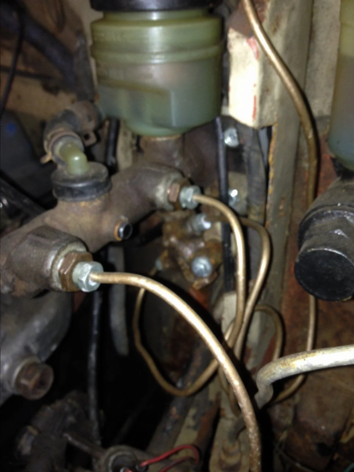

Brakes: My FJ40 has a later model axle in it with front disc brakes. It runs the JT Outfitters adapter plate but has no brake booster so my first inclination as Ive been driving this was to add one.
Turns out that is not plug and play, rather entails drilling and cutting the fire wall, modifying parts and ends up being uncomfortably close to the carb.
img_0156-jpg.1507739
I am on the fence because it would mean more holes in the dash, not something I care about in this tub, but if I spend a lot on a new tub I would not want to do it and would likely prohibit me from ever going to EFI which I am interested in.
