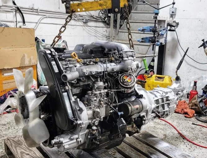

1966 Toyota Stout 1KZT 2WD 5 Speed
(Expecting arrival of truck this month)

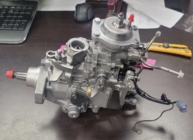

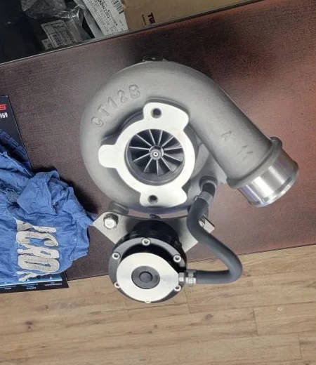

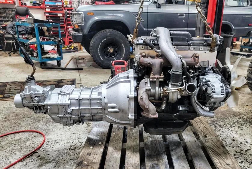

- 1KZT, new head, injectors, high flow billet turbo and 4M40 +30% mechanical pump added. Thanks to Dark Fox Diesel. Grimmspeed boost controller @23psi
- R151 2WD 5 speed transmission
- 1989 2WD pick up rear end
- 1980 Toyota Pickup Spindles and disc brake conversion

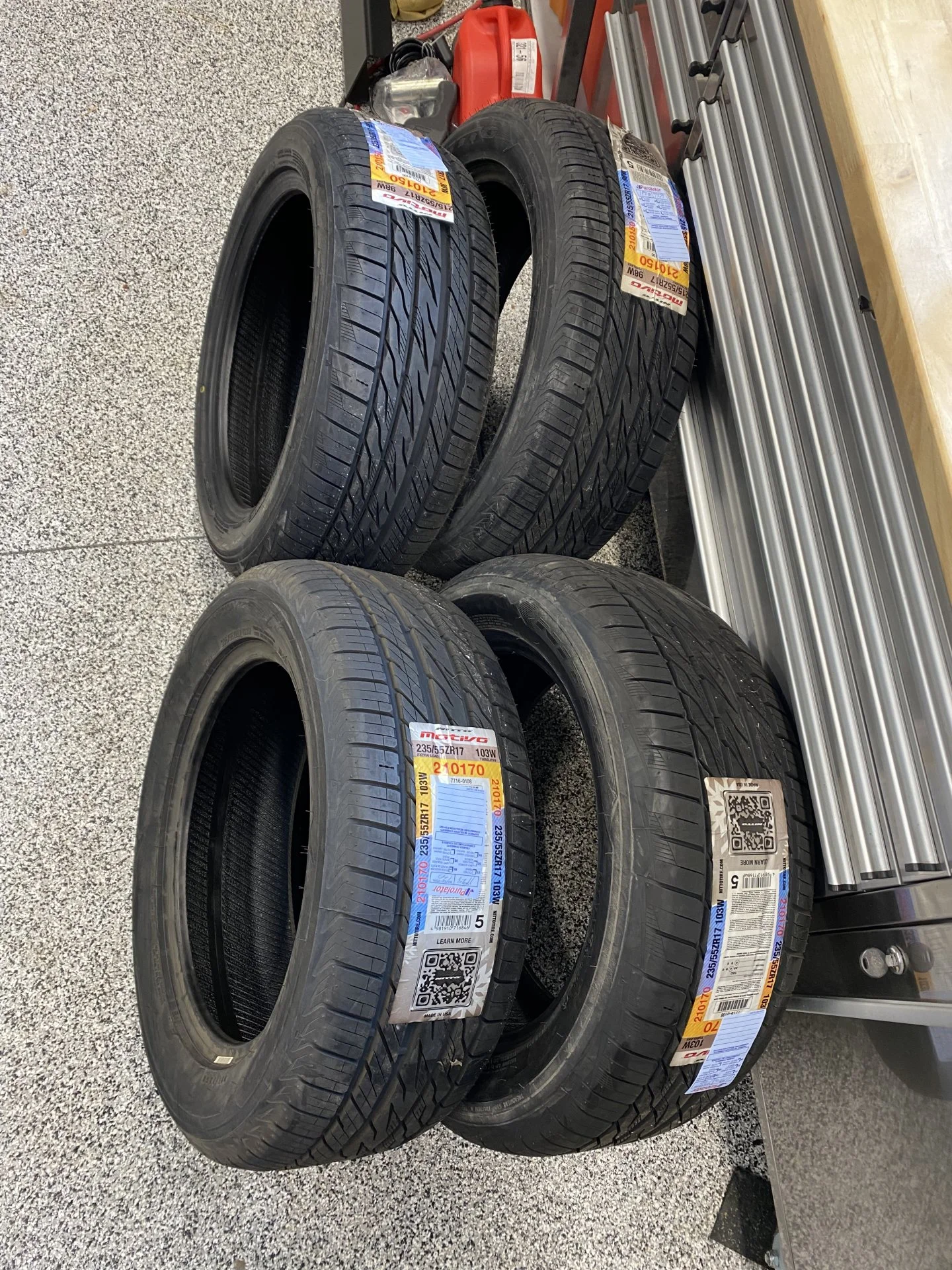

- QA1 Front Coil Overs, rear shocks and 4” drop blocks

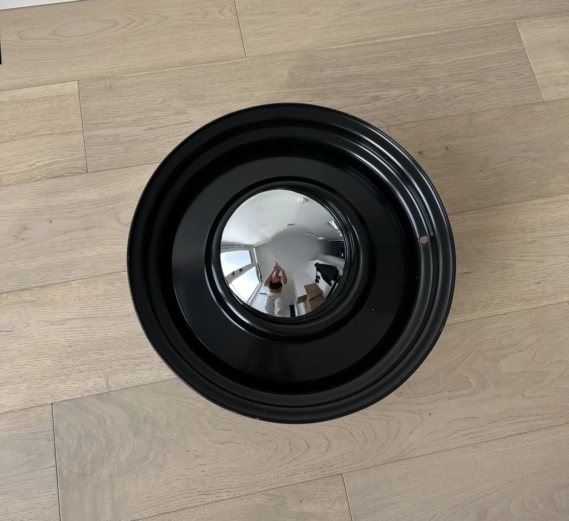

- 17x7/8 Ceco Smoothie Wheels
- 215-235/55/17 Nitto Motivo Tires
Still have stock CT12B Turbo, R351f 5 speed transmission and 1KZT bell housing for sale if anyone needs.
