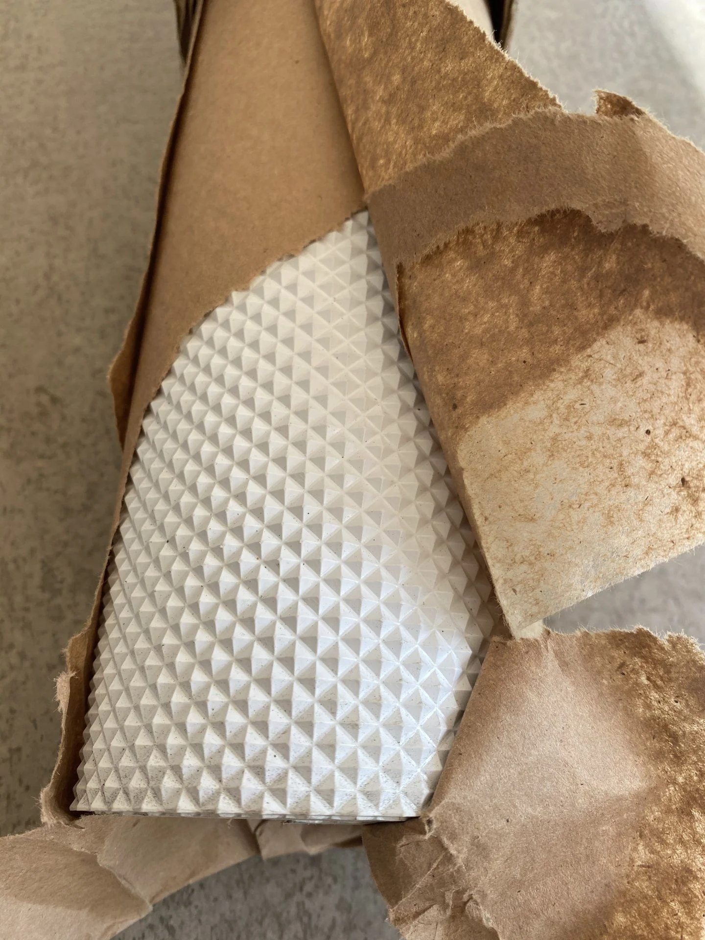

Found the good stuff today. I had ordered a bunch of this white rubber running board material a while back. Finally able to locate it today and plan to get it over to @wngrog one day next week.

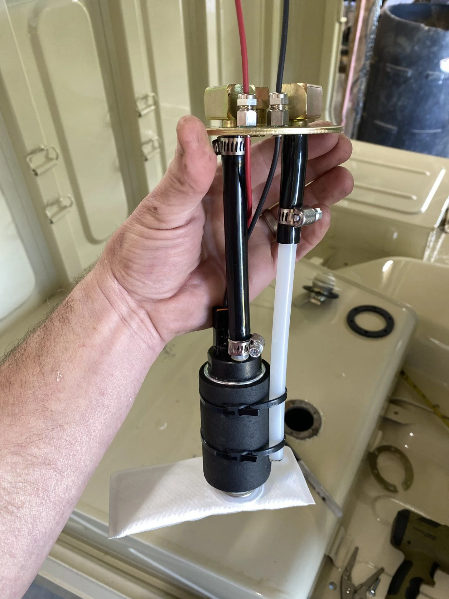

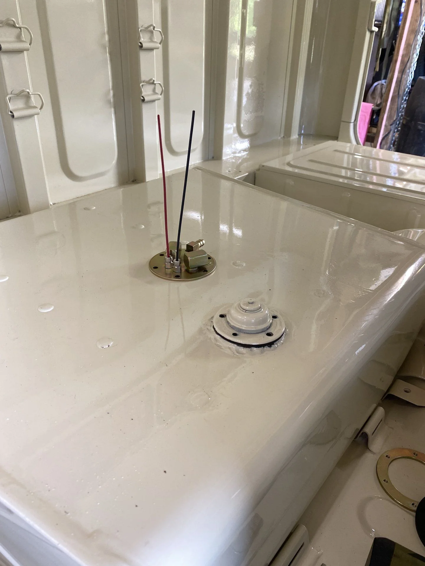

I’m going to go get some of the recommended Permatex for the gasket before I bolt it all up.
Easy kit with Walbro that just requires 4 tack welds to hold the backing place for the screws they secure the pump and return.
This is pretty mandatory for the fuel injection as the old tanks don’t have provisions for a return or a good vent.
Rad you did it with an in tank pump and mini hydra mat!
Looks great! Basically the same one @FJ60Cam sold me for my 60! Make sure you do use the permatex on gasket and threads on each screw. I sprung a couple leaks without it.

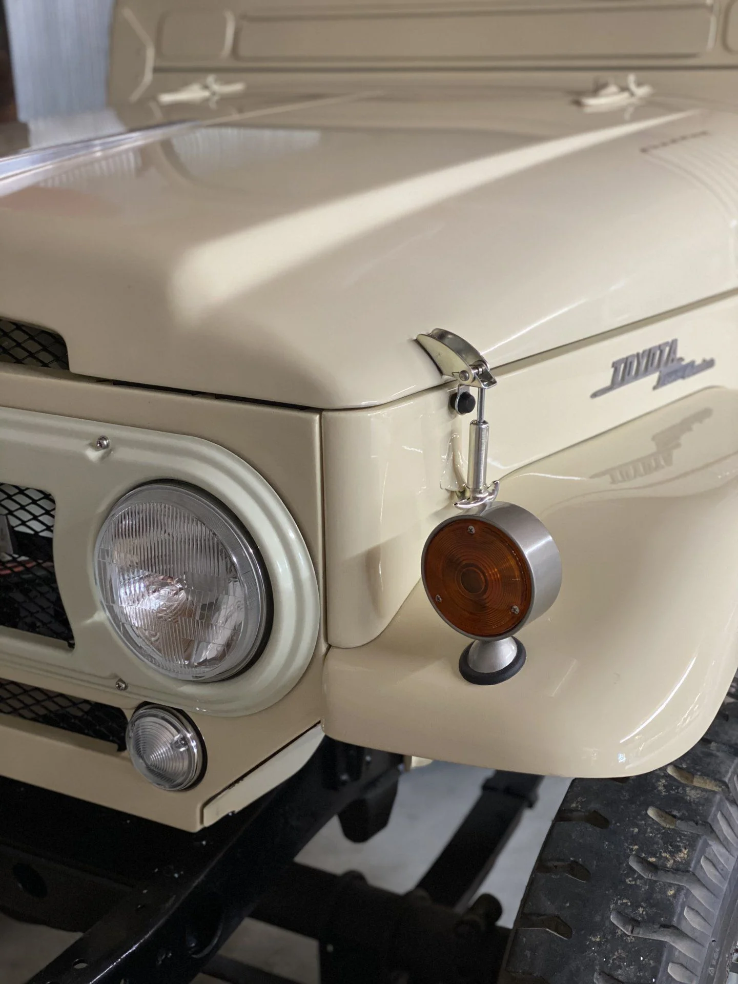

I don’t know how much these shops work on these nicely painted trucks. I scratched everything just putting these 4 parts on.
It’s all got to come off again but man. I needed to see it
That looks great. Working around the fresh paint isnt enjoyable until the task is over. Depending on how well the fenders are coated, a jumper ground to the body of the turn signal light might not be a bad idea. It’s hard to get to bare metal with the mounting stud/nut.
First is giving the paint time to fully cure. It's pretty soft at first.
Next trick is masking tape. Not the beige stuff - the blue (good), yellow (better), or green (best). It's not just for masking off before paint, it's also for protecting the paint when you're working around the painted surfaces afterwards. ;)
Great tip. Thank you

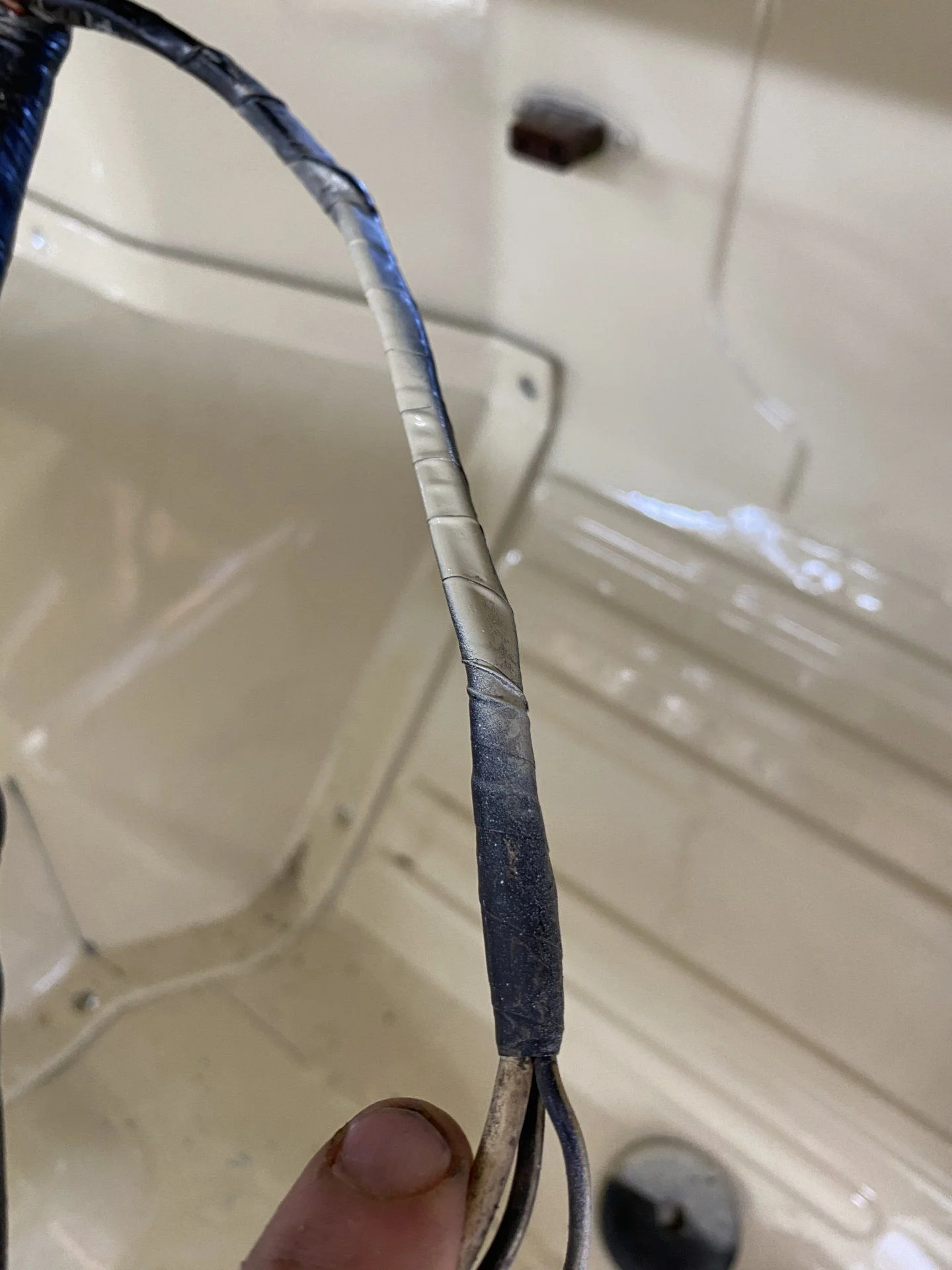

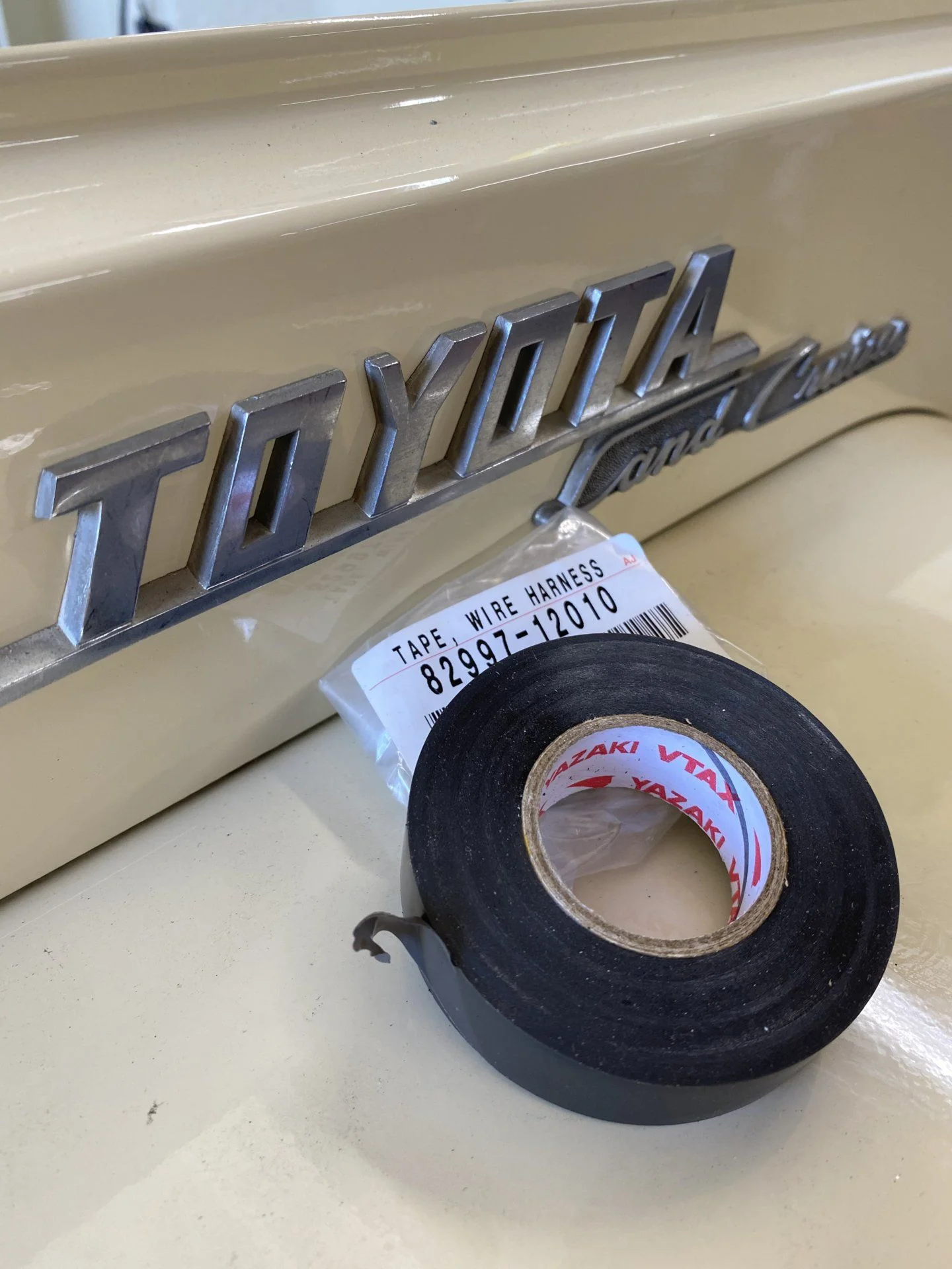

The wiring harness on this truck is beautiful. The only problem is that it had so much overspray. I worked real hard getting the exposed wires clean and was working even harder to get the paint off the black loom tape when I realized Beno tossed in a roll of Toyota tape in the last box.

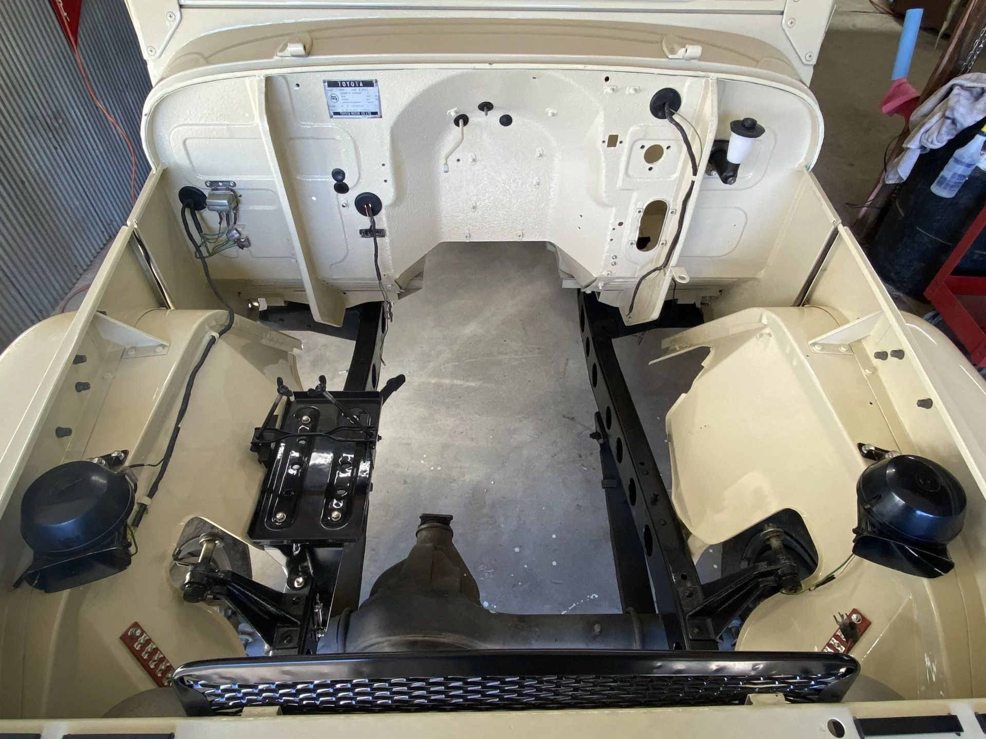

Even though it will have to be taken apart again, most all of the truck will be assembled before it leaves my shop for Mosley Motors for the drivetrain install. A lot of this stuff will be out of the way so it won’t have to be uninstalled

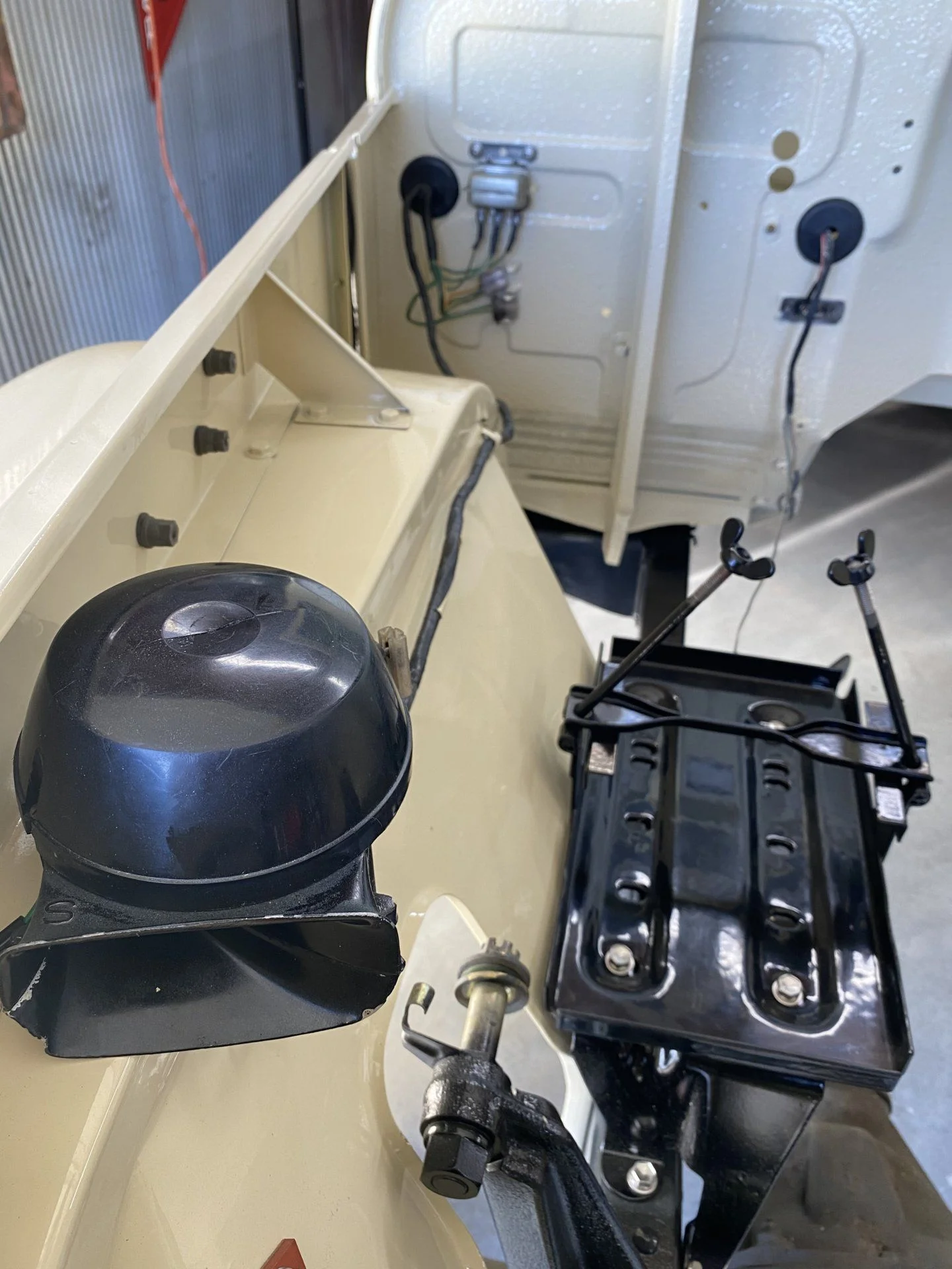

I love an Elephant Horn. Does anyone make the repro stickers for these? @SMG?

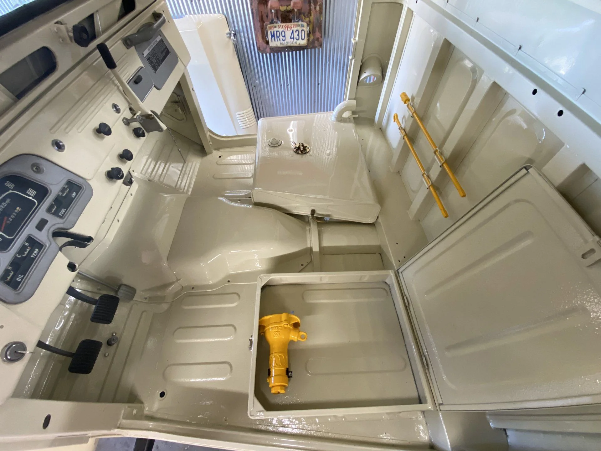

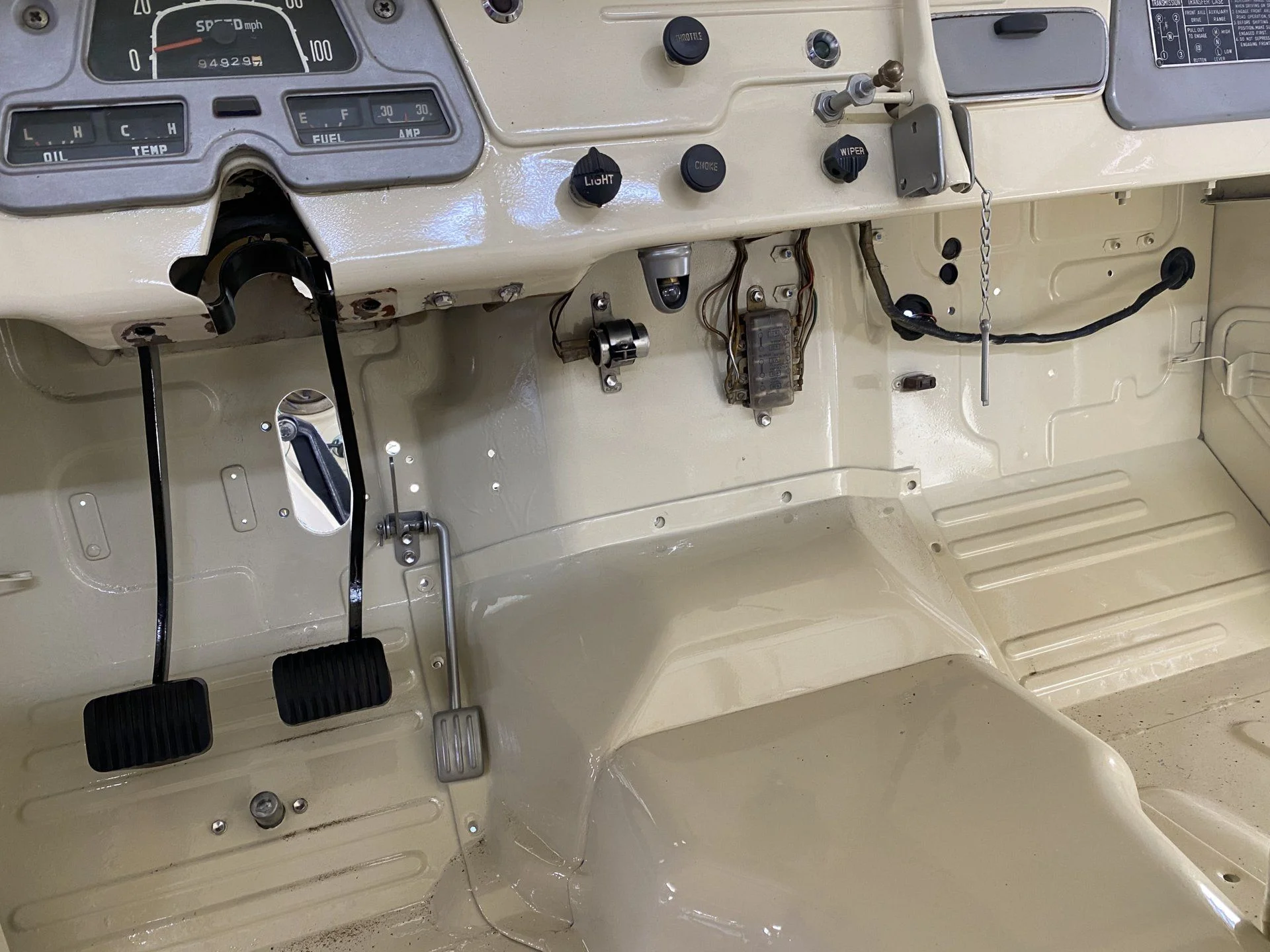

Interior stuff. It still has the stock fuse box cover

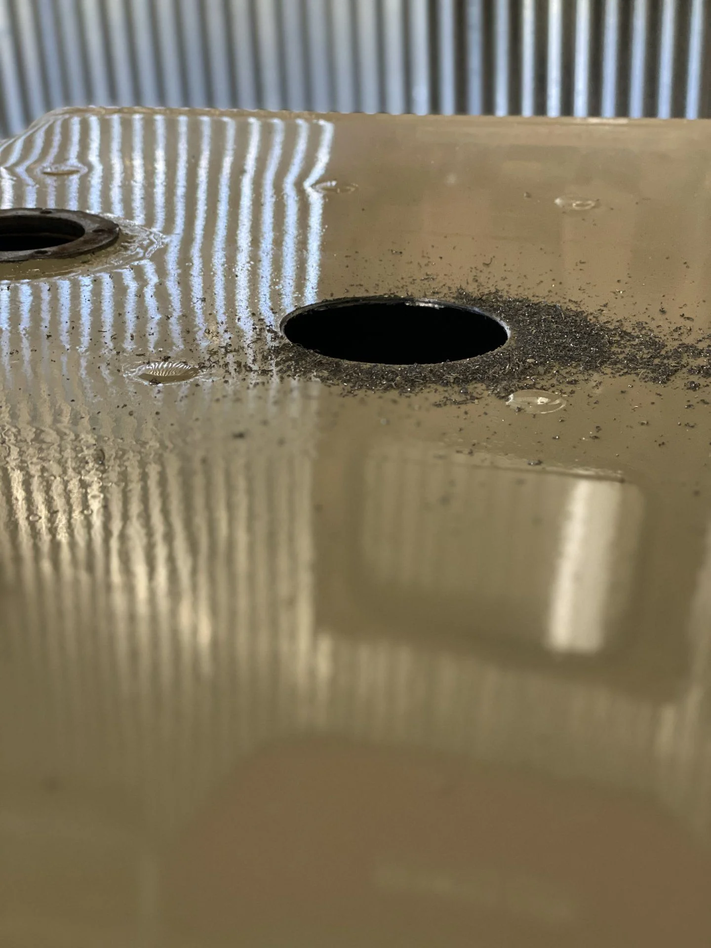

The firewall has a few extra holes but I’m getting them plugged

Check horn wiring at relay.
Is the main harness getting any protection?
