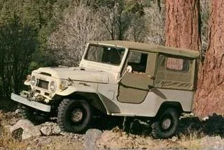

Plan is to repaint exterior tan, just not much on black on any FJ40. Im going for the look of the picture below.

Ive considered painting Volcanic Beige, Hot Rod Flatz Desert Tan or just spray can Krylon Camo Tan (simply for economical reasons). Would this decrease value?

Cool Alex! Glad to see you will be bringing the old girl back!! I like the sound of your plan, as for the color Lilly White would be the color pictured on the '61 you posted above (two of my '62s were this color). Also I believe there is a little more accurate color chip sample burried some where here on mud, as the one above has some errors in names and such. I'll see if I can dig it up.
Again glad to see you brining the old girl back and I look forward to the build :beer:
