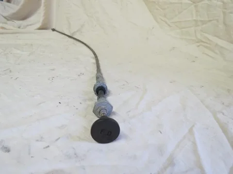

Just another pic of 62 cable with broken end.
I am missing the knob.
This cable & knob I found by posting in WTB area of Classifieds.
I guess I'm confused. Picture is of a cable with broken end and it has the knob. The one your buying is of the complete unit but only a picture of a cable with broken end is shown.:confused: Thought you found a cable in the vehicle minus the knob and the end was broken. I hope you don't mean your buying a broken cable. I have never torn one apart and remove the vacuum switch and cable as one unit. May come apart but afraid I would end up breaking it. No sense and tearing apart something that isn't broke.
Your right and now I'm confused too.
I asked if it was broken and seller said it was not but end had been soldered together, but picture does not show it attached to vacuum switch.
So is it in that case broken???
How hard is it to find just the knob?
I know there was a forum member who was making custom knobs (www.knoobs.com) who has since quit doing this.
I'm going to go pull entire vacuum switch or take photos. I've been storing the truck in my tobacco barn which is a few miles from my home so my wife doesn't have to look at it.
I know the vehicle this came off of. It is really a 61 FJ40 and was the oldest known survivor until it was parted out. Here is a picture before the vacuum switch was removed. The cable was still attached. I have never pulled one apart so how easy it comes apart I don't know. I believe the end of the cable a forms a eye and moves a lever inside the switch. It more of a pain in the a$$ to fish the knob end out but that is always how I tackled these.
