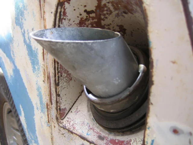

Ya the FJ40 FST model had the same door opening as the FJ25 until the 64 models. I currently have a 62 with those door openings. The wheel open changed as well as the gas fill. The FJ40 had the same fill neck as the hard top. The FJ25 FST had a opening in the nagle section and the tank has a neck attached that fit directly into the opening in the tub. They also had tube in the center you could pull up and pour gas in directly out of a jerry can. At the bottom pof the tube was a screen to filter the gas. The picture doesn't show it but the gas cap chain attached to the tube and that is how you pulled it up.

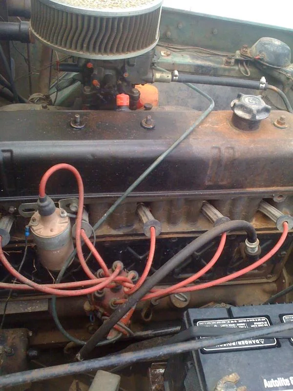

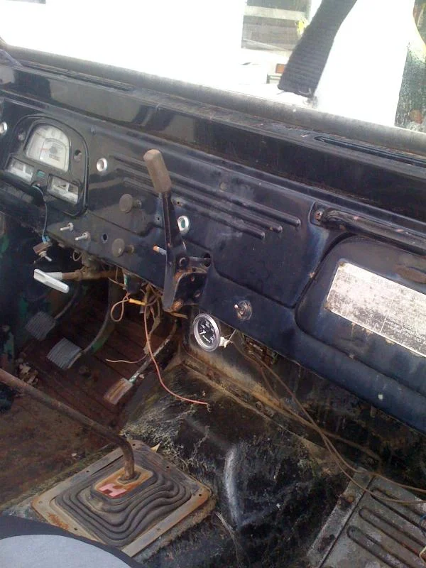

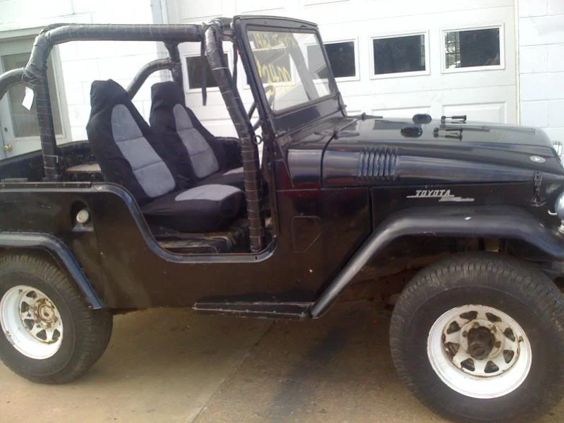

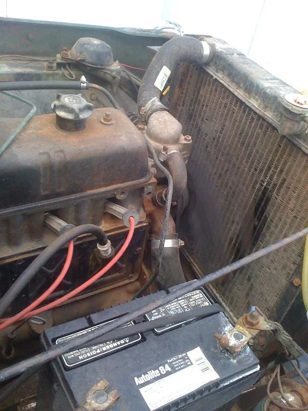

Looks like a later F 155 from the early '70s, so not the correct F135 for this '62. Should have had a column shifter, and not the floor...bench seat and not buckets...no roll bar, and stuff like that, but looks decent.

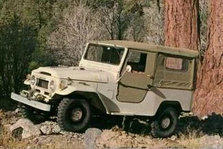

You can put an F135 back in, OEM rims with 700R15 tires, and look like the picture below...which is still one of my favorite cruiser pictures!

I know I wish I had an early rig like the one below...just not in cards to ship one at this point in time :frown:

You can add wrong transmission and transfer case. Haven't seen a early cruiser yet that had a newer enging that the T/T was updated too. I picked up a 63 out of a junk yard. The engine was intact under the hood. The parts of the T/T were laying in the back. Figure the early T/T broke and reason it ended up in a junk yard. F135 lasted until the 68 model. the early T/T ended mid 63. Only a few hundred or so FJ40 were imported the first couple years. Many finding part for the T/T hard. A floor shift was a option on all FJ40 even these early ones. But the floor shifter is a lot harder to find then the transmission.

Does not have the correct windshield either, the correct one would have had the vent at the bottom. If it drives nice that's probably a fair price. I love the post on the making your own softtop. Shopping for a used walking foot sewing machine now.
It really does matter what you're going to do with it. It's not worth any more and probably less than a similar shape later model 40. ;)
Poke around with it, and run as is: Price is OK.
Return to original: Not enough oriiginal left, overpriced.
Modify into an awesome trail rig: Your buying a tub and frame everything else will eventually be swapped out, what's a tub and frame worth to you?
