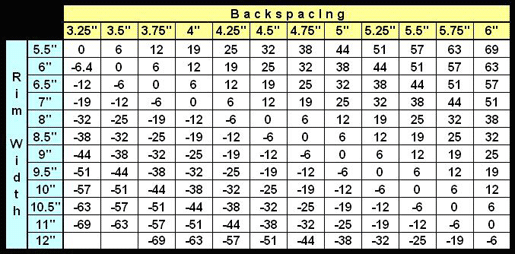

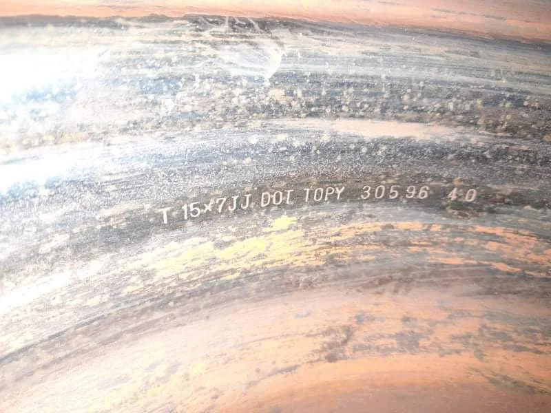

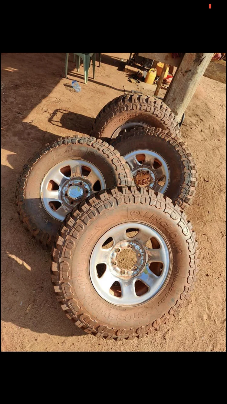

Hi guys, I am trying to get a set of steel wheel for a 1992 75 series pickup. I came across this set locally. But I am not sure about the offset. The seller can’t tell me the ET number. He doesn’t know the offset too but he sent me a photo. From the photo I am not sure what the offset is. Maybe you guys recognize this wheel and can tell me if it will fit on my car. I don’t intend to use spacers. And I read on the forum (the chart is from someone posted on the forum) that for 3.5” backspacing with 15x7 wheel, the offset should be -12. I am not sure if I get that right.
Just measure with a ruler for a rough measurement since you have access to the wheels physically. Backspace will be the distance between the hub and the flange (from the back). Factory BS seems to float between 3.5" and 3.2" across all OEM Toyota wheels for the 6 lug 70 series HD models. 70 series Prados are a little different.
My HZJ77 has factory OEM alloys 15X7 -20 offset which is about 3.21" backspace.
