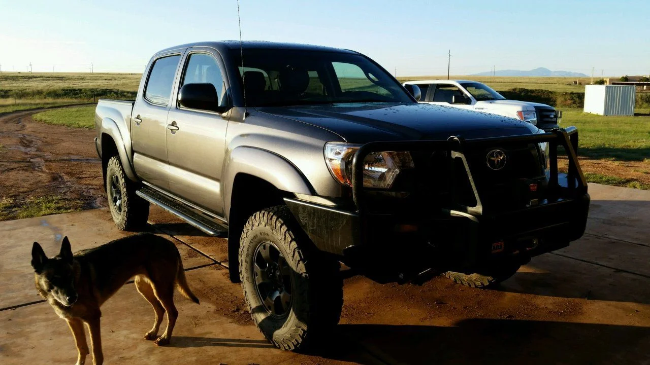

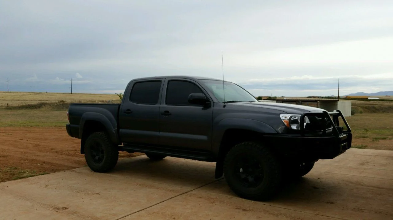

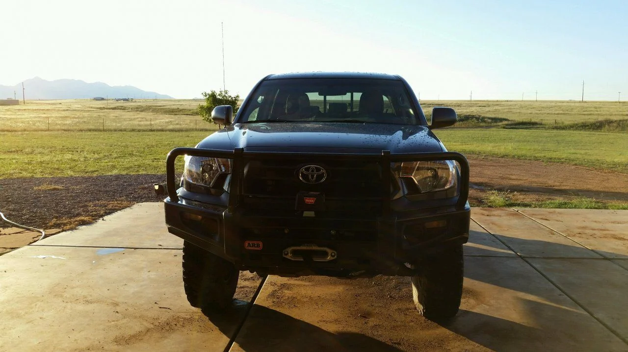

Forum rules state that if you have a Tacoma with a bullbar then you must post a pic :)
I'd go 886s. You can always add spacers down the road if it needs it.
The 886s are great!!
Absolutely perfect with the Slee sliders and ARB bull bar with an M8000S.
