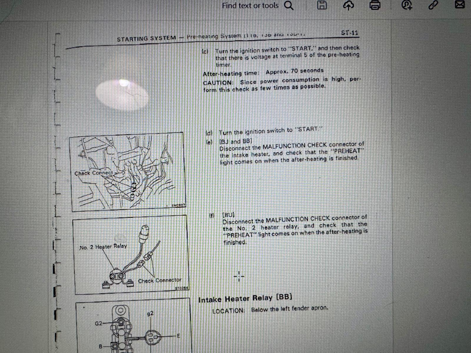

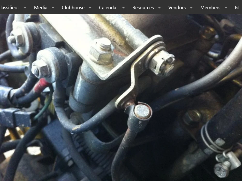

I am looking for some help identifying some wiring for the glow screen in my 89 BJ74, maybe someone could have a look at theirs and let me know what it should look like.
The previous owner removed the connections at the glow screen and I am attempting to bring it back to life, but I'm having a difficult time finding info.

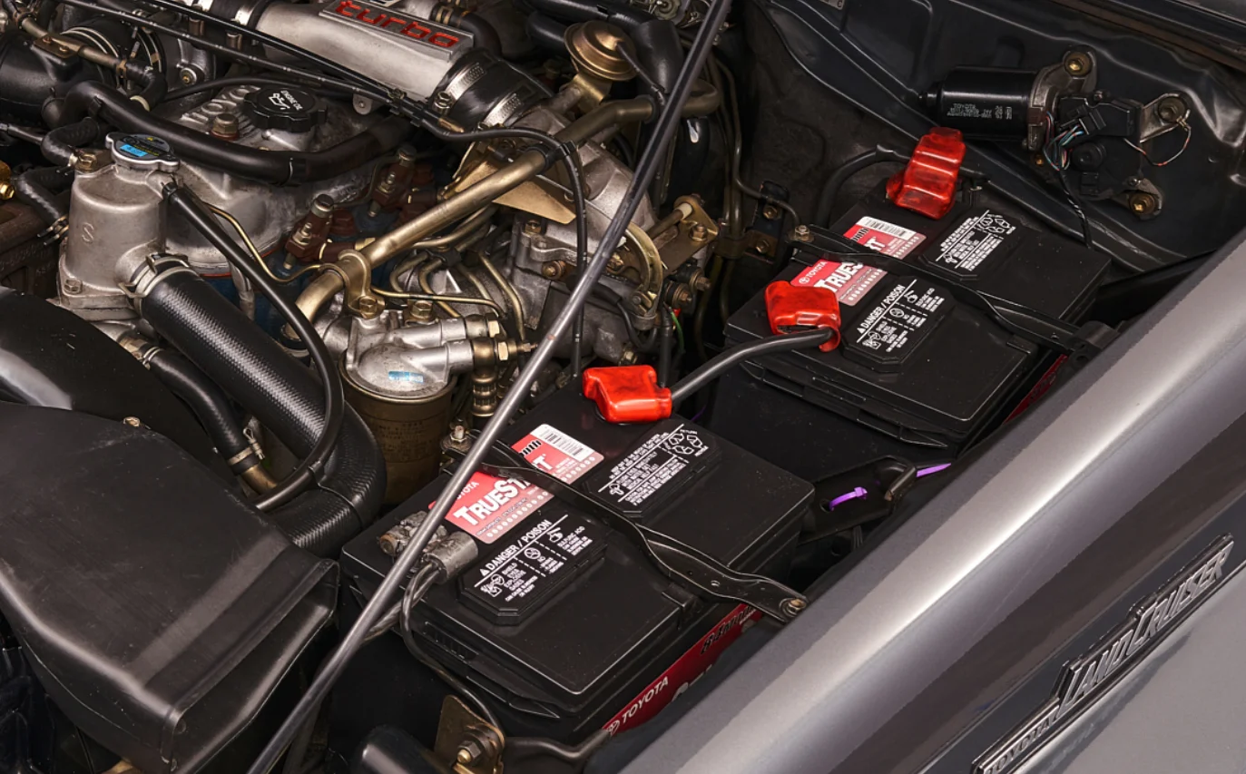

I have found some photos of the stock setup (pic 4) and I'm wondering, what is the green cable on the ground side? I have found a single wire with a connector on the end that exits the loom 4-5" below the black and red connections.
(circled in red pic 3)
The FSM mentions disconnecting "the malfunction check connector of the intake heater" is that what the green cord is and I am just missing the part from the connector to the glow screen stud mounts?
Any info helps

I am still looking for some assistance with this.
If someone with a 13bt could take some detailed photos or measurements I would be grateful. I am hoping with the correct info I can have @ToyotaMatt replicate the missing section of my glow screen wiring connection.
I would like to confirm that the green wire is meant to connect on the left terminal, and get some dimensions and wire size so that it can be recreated as close to factory as possible.
Below is the best example I have been able to find of what the stock wiring connections should look like.
Thanks,
Rodger
