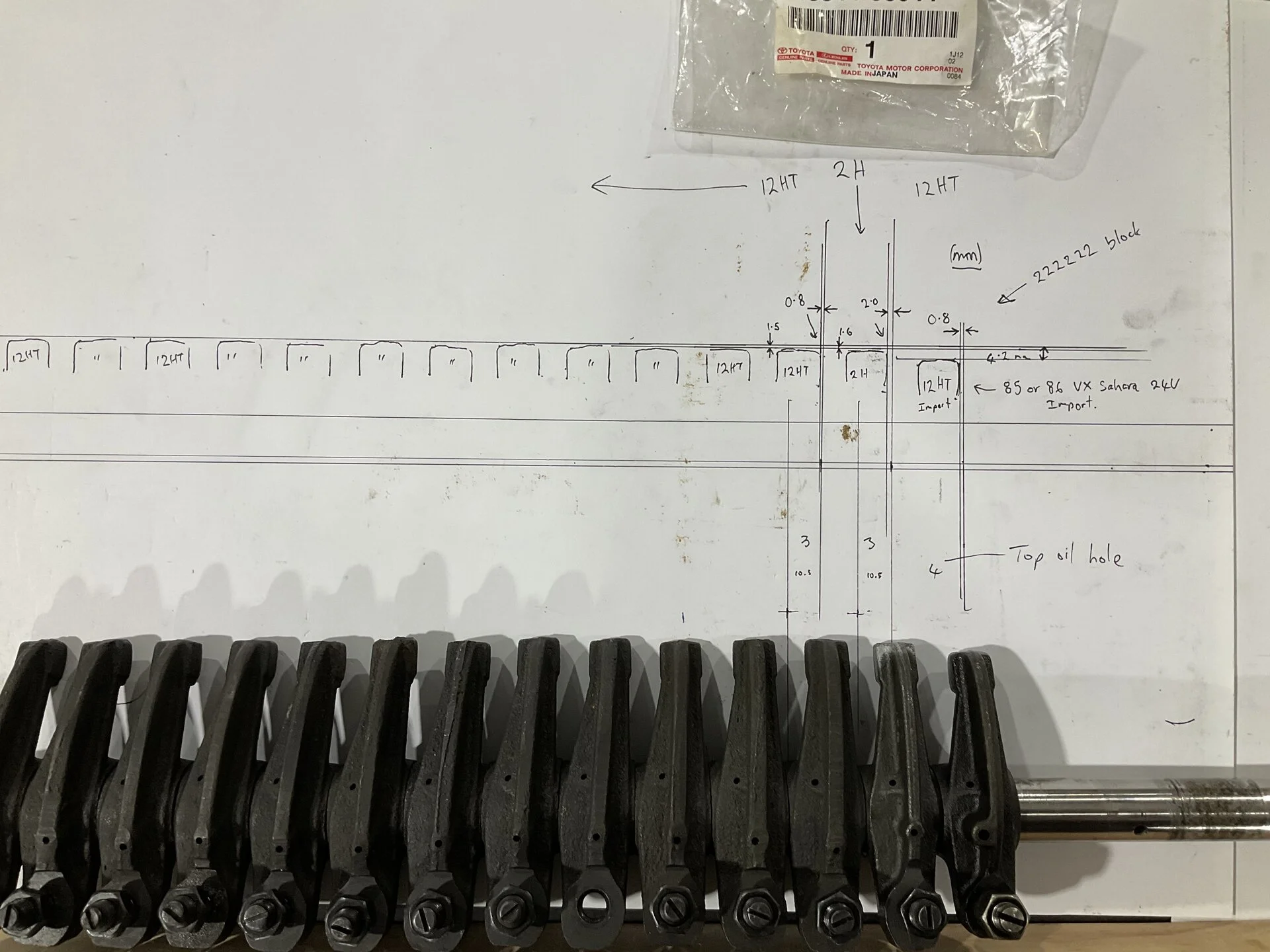

Hi, I just bought a new 2h rocker arm and did a bit of a comparison with my 12ht rocker arms…. The first set of 12ht rocker arms (I’ll call set A) were very similar, but slightly different.….

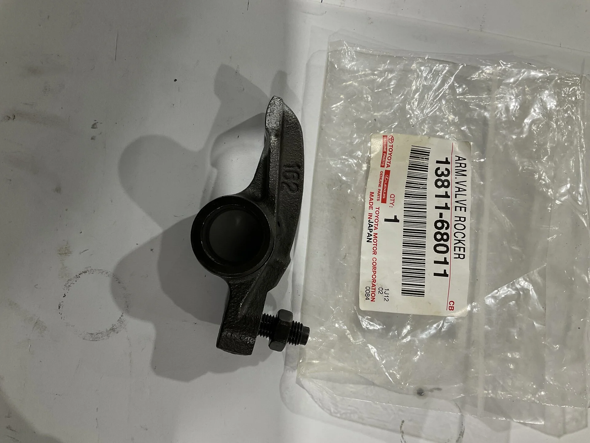

In the first photo, is a row of 12ht rocker arms (engine set A), 2nd from right is the 2H rocker (part number above) and furtherest on the right is another 12ht rocker (set B) off another 12ht engine that I am building.
As you can see, there is a small variation in all of set A 12ht, with the 2h being the same length as the smallest of that set A.
The oil holes are similar in size but, the 2h top hole is in a slightly different position (doesn’t look like it would be any different in effectiveness). Oil holes look to be 3mm diameter.
The other 12ht rocker arm (set B) is a lot smaller in length and also has a oil hole position like the 2h rocker, but the top hole is 4mm in diameter.
On the paper you can see the 2h has slightly more offset from the right compared to both set A & B rockers.
The set A rockers are all slightly thicker in the valve contact tip compared to the 2h rocker and are all slightly “heavier” in the rib area.

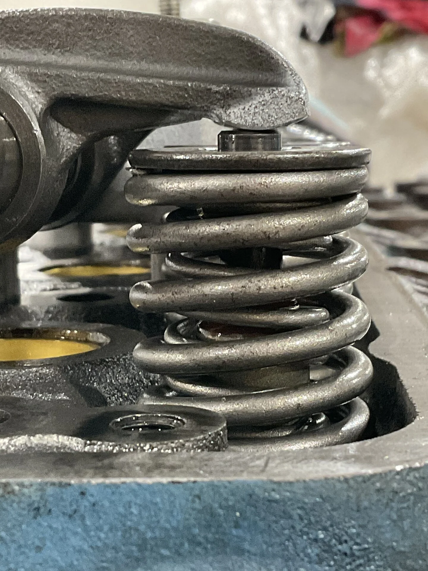

Above is rocker from my set A, put on the head/rocker shaft of 12ht set B. Note Rocker tip to valve tip.
Above is the 2h rocker arm on the same set B 12ht head

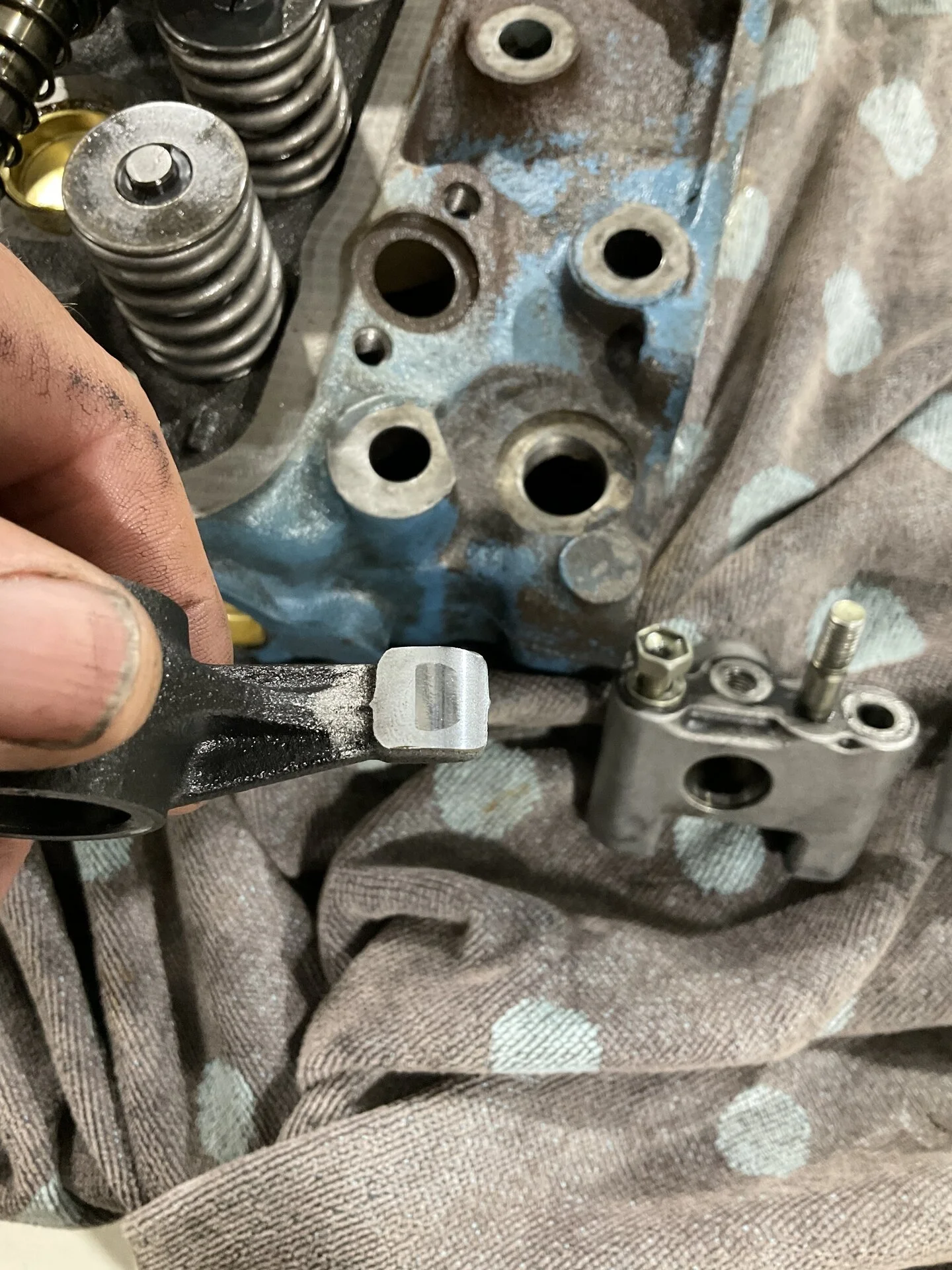

rocker off set B & it’s contact wear mark
Above, from left,12ht rocker from set B (push rod end of rocker on a block of timber, for height comparison), 2h rocker, set A 12ht rockers (showing thicker contact tips).

All of the rockers from my B set have different numbers in them (14, 12, 12, 21 etc…), no numbers on the set A rockers and 162 on the 2h rocker
