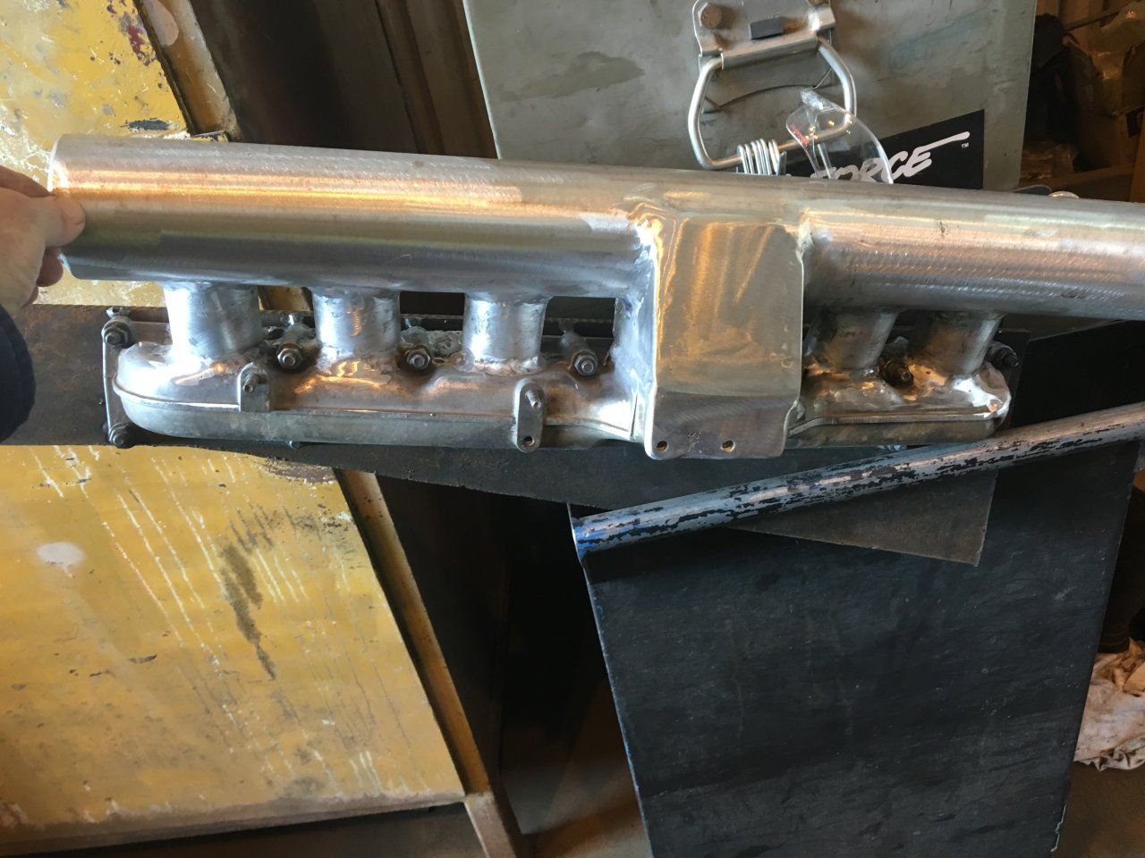

I don't have any vacuum issues, I have removed it all. Even the butterfly gone now. That is my intake now straight to a front mount.
That looks intriguing but I'm not quite understanding what I'm looking at... how does that work
That is a 12ht intake manifold modified, no longer need the heater element or butterfly because I have replaced injector pump with a rotary pump with has a electric stop solenoid. In the pick I just have it bolted to some flat steel so when I welded it kept its shape.
Other than the obvious lack of vacuum hose spaghetti what advantage does all that give? Not really too familiar with mods of this sort just yet but maybe one day down the track
It allows for more air to be forced in evenly.
And pump is for more fuel higher pressure then you can run bigger nozzles on injectors.
