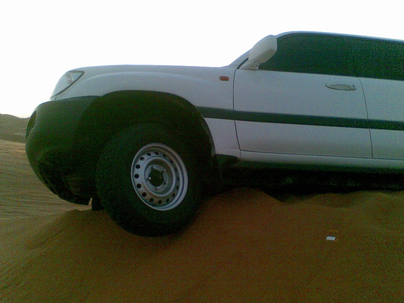

hks3sgte said:
I'd LOVE these
What's the width on those? They could be a bit more practical than the skinny splits are...
I dig mine though, and will put a tall skinny tire on them. Side wall roll is of course an issue, but it's easy to adjust to.
they're the standard GXL 100 series 16x8 in Australia

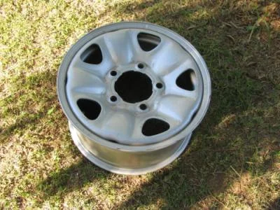

Hey IFS folks. If any body wants these rims i can get them for $320 each +plus ride from Michigan 48060 to your door by what ever carrier you prefer. They will be brand new from Toyota warehouse; type A steel rims for 100 series. I can get other overseas rims and parts as well. PM me if interested.
Are these the same as Type A? Looks like it may be wider?
hks3sgte said:
Still pricey :bang:
No kidding, I had the centers cut out of the Type A steelies and mounted to a 16x7 wheel, shipped for less than half that:meh:
Sent from my iPhone using IH8MUD
Akella, Would you happen to know what the offset is for the Type A 16x6.5 wheels?
Not out of my head.
I have seen it before somewhere here on mud, but i dont remember where. If I find it i will post it here.
