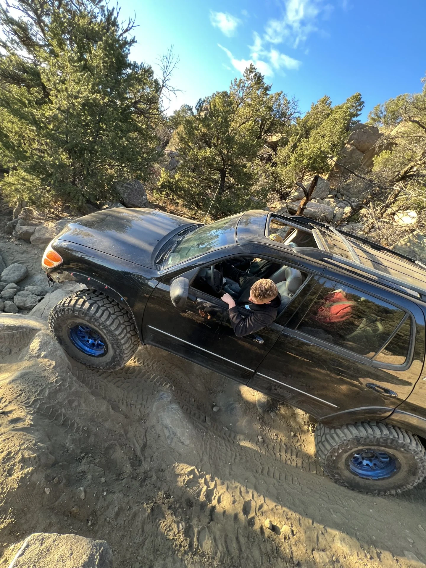

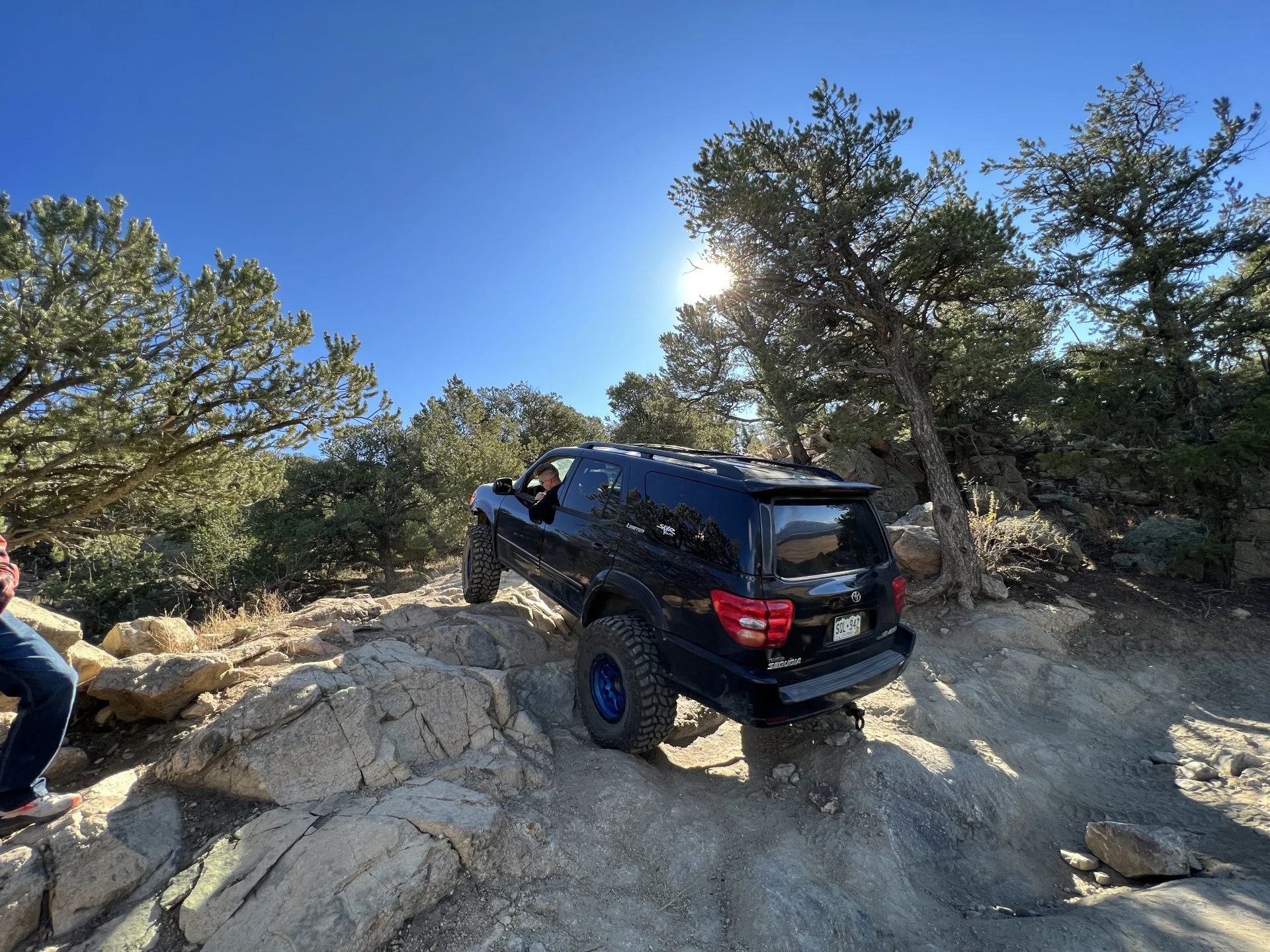

This one has 360K on it, running like it’s new. IFS is always the least common denominator that makes everything suck, and the 100 series has torsion bars that make it suck 100% more.
I’d get the Sequoia all day long, and it’s much easier to find them in good condition vs. the 100 series, and less expensive. They have surprisingly good clearance lacking the usual rocker panel clearance loss and everything is tucked up into the frame rails nicely with the very tall roofline - compare to a say 4th gen 4Runner, it’s an enormous difference that makes up for the wheelbase.
I used to run 34’s (285/75/17) on this without any trimming, just a little pinch seam hammering, with a basic 2.5” lift (still installed in the front in these pics on 37’s). They are awesome trucks and have so much more daily utility than a Cruiser. They fit in about the same places, I’ve taken it up Peak 10 in Breckenridge that has super tight switchbacks. I’d get an ‘03/‘04 that has the low range gear shift over the ‘05-7 dial, you’re past the initial issues with brake size and other early model stuff, but not in the more pure electronics era. The VVT engine and 5 speed don’t really make much difference in these things. I have that drivetrain in a 2004 4Runner and that lighter truck really expresses that configuration.
