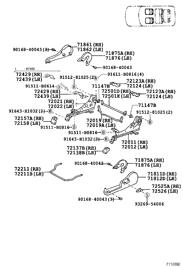

Can anyone get me the picture of the LC100/LX470 seat frame? (without foam)
The purpose of this is my car have a very low end handle seats and the foam started tearing apart. I thought of installing LX470 since both vehicles share the same platform with new seat covers from LeatherSeats.com and adding motors to it. I found that my LC has the electric seat cable right under my seat meaning that I can hook the motors straight up to the car for it to work.
Now I just want to make sure if both electrical manual seats share the same frame and whether to change the whole seat or just need some brackets to install the motors.

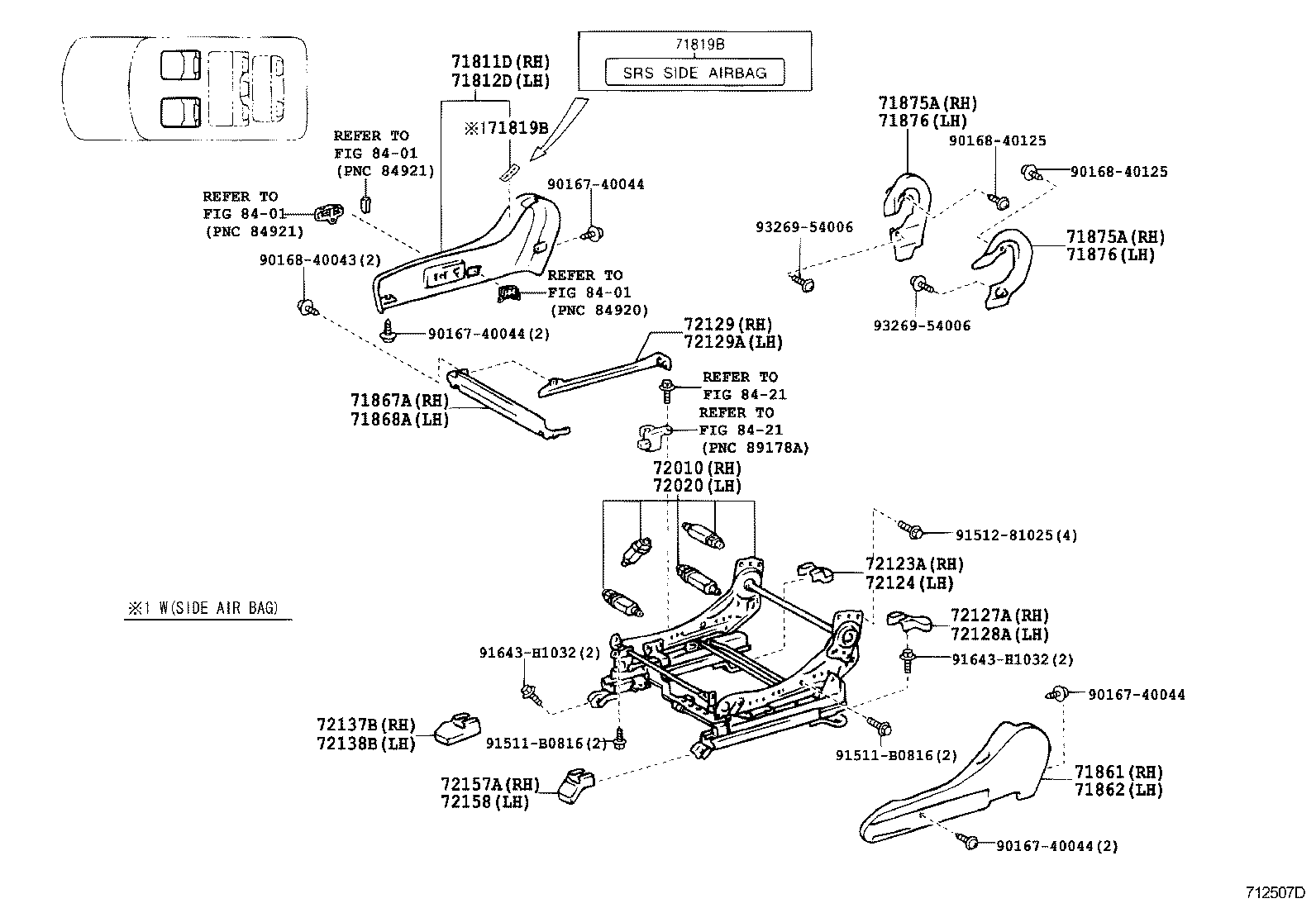

Found it.
and to my understanding the adjuster don't share the same parts.
Bummer :(
I've done the exact same thing on mine and it worked out great. All you need to do for the seat to work is to connect the positive and negative wires of the harnesses together. That's all there is to it... at least in my case. 2006 US spec UZJ-100 seats installed to my HZJ-105 G trim. But like a lot of previous goof ups I've made, this could be a disaster waiting to happen.
