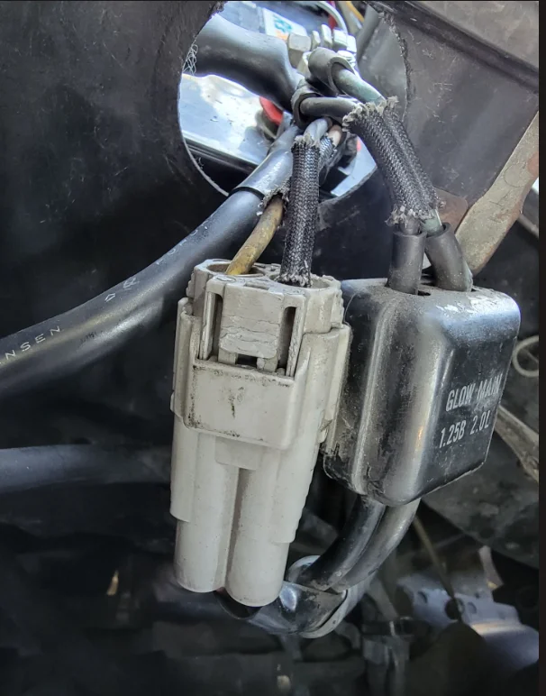

from this
to this
I'm interested in that. Looks like there's a decent supply out there
I’m questioning this because fuse link wire function different than fuses.
But in the 100 series with 1hdft or FTe variants it seems they went away from fuse link wire.
Did you ever do this? doing the same seen it done on here. Just can't find original post I seen.
If you did do it , How'd you wire it in? Cheers

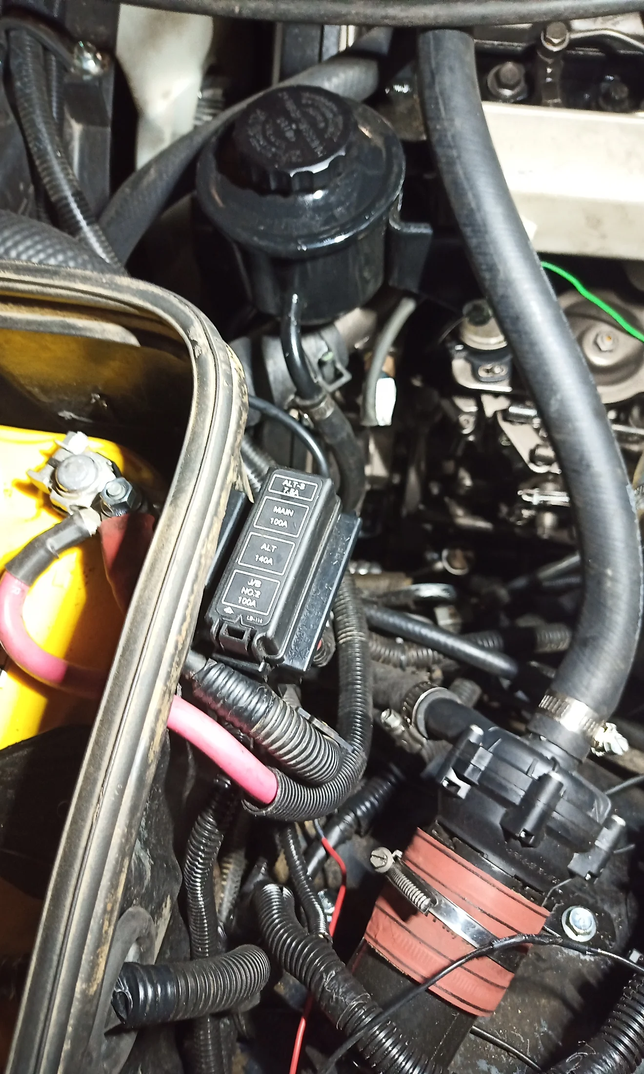

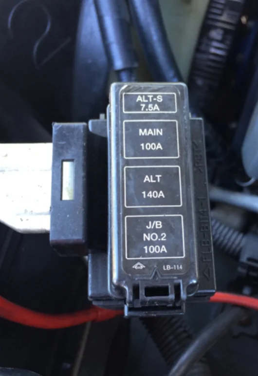

I did it on my build. running smaller fuses then what a 100 would run except for the alternator ( I used much larger cable then a stock 100) highly recommended. lots of AUX power taps if needed, better then a bunch of wires off the terminal. cleaner look then factory and safer. those bigger fusible links nearly start a fire if they go. Still have some wire loom cleaning up to do.
I did it on my build. running smaller fuses then what a 100 would run except for the alternator ( I used much larger cable then a stock 100) highly recommended. lots of AUX power taps if needed, better then a bunch of wires off the terminal. cleaner look then factory and safer. those bigger fusible links nearly start a fire if they go. Still have some wire loom cleaning up to do. View attachment 3973264
Ended up doing the same. Going to buy another for the left hand battery for the accessory's. Tight fit with the intercooler pipe though. I'll do a write up for future people looking
