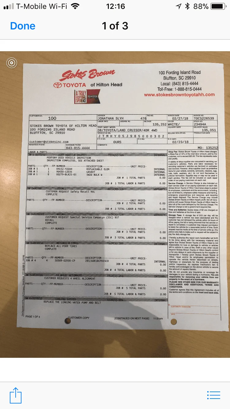

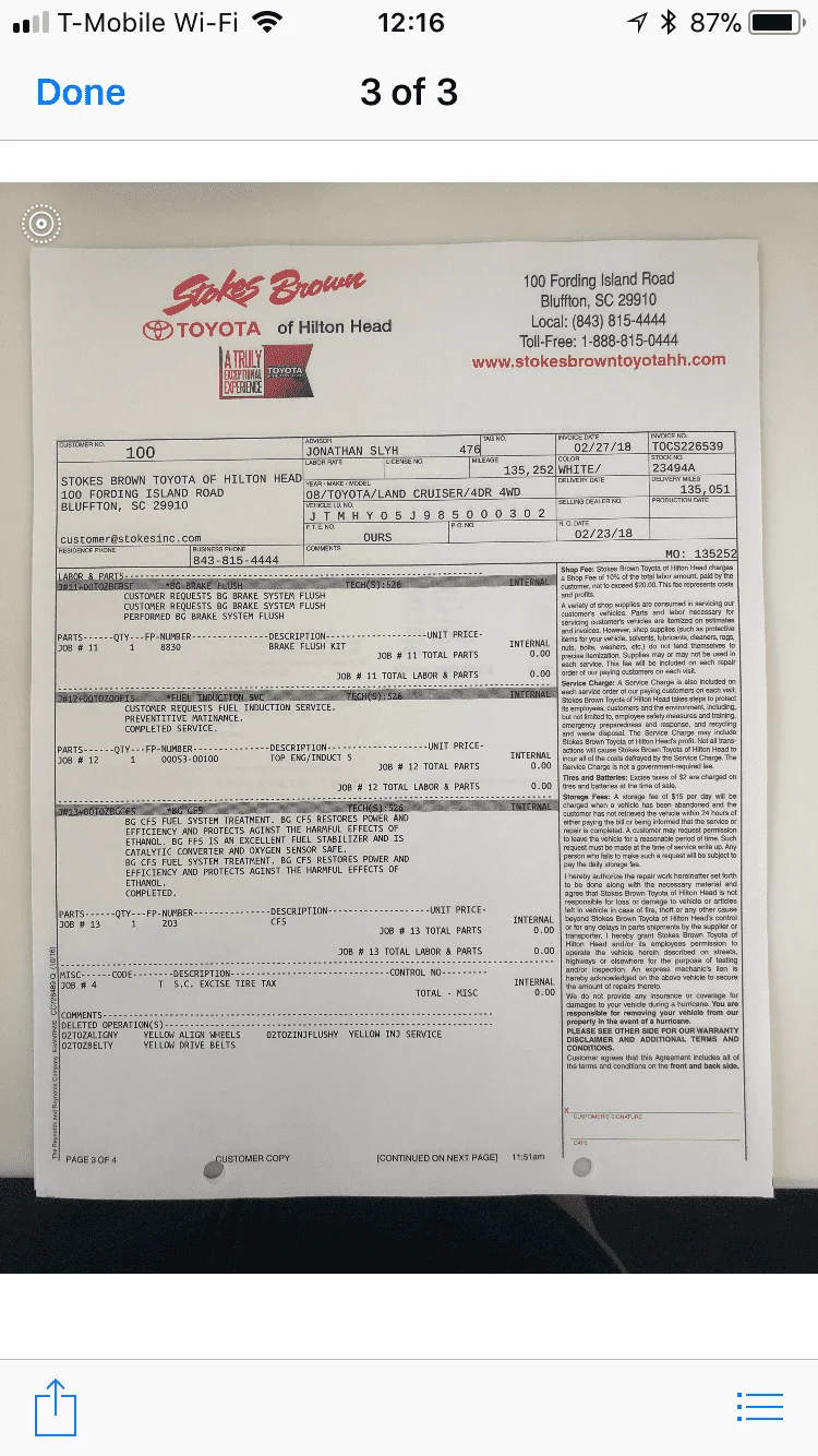

1 owner truck, local to Bluffton SC. bought new at this dealer almost all service has been done at this dealer as well. some of the maintenance records are attached. It looks like the water pump was replaced recently, new tires and an alignment for what thats worth. I facetimed the salesman and he crawled under the truck and it looks really clean. I plan to go see it in person this weekend.

It looks like they're changing the water pump and serpentine belt which is great. But while they're in there they should do the heater hose tees and the thermostat. On the second page, job 9, they mention changing a Element Sub-Assembly. What is that?
If there's no records on anything else then expect to do a transmission fluid swap, transfer case, 2 diffs, brake rotors and pads, and sparkplugs.

The dealer put the wrong oil in - should be 0W-20 synthetic, not the 5W-20 bulk they used. That alone would make me question the ability of that dealership to properly service a Land Cruiser.
