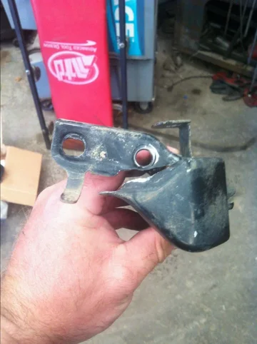

Stopped on way back from San Antonio; dealer said needed pressure switch 700.00; and if that didn't fix it then ahc motor- 3300.00......
Needless to say I went home and great cruiser head baker tire put it on rack and found rear sensor bracket broken in half.... Allowing sensor to be out of position....
Removed braket and welded.
All fixed!
