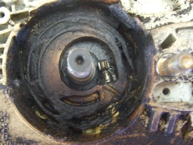

The polymer gear looks good and when turned by hand the gear on the oil pump turns. I blew out the tube from the tank to the elbow and blew out the elbow itself.
The only thing I can see that may be causing my problem is the drive sprocket. When I reassemble everything, the drive sprocket has a fairly sloppy fit. Sloppy enough that it doesn't seem likely the little coat hanger wire thing that wraps around the polymer gear would stay in the notch on the sprocket.
My question is...How snug should the fit be for the sprocket?
I think I may have answered my own question. I'm missing the needle cage. It wasn't there when I disassembled.
