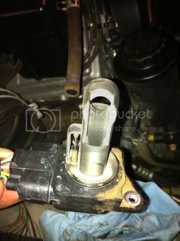

Quick follow up - did a search on MUD for MAF and Tacoma, and a reference to K&N filters fouling MAF's came up...I've got a K&N in the rig. Pulled it out and when back to paper, and will pull the MAF and give it a once over when it isn't 20 degrees with snow coming in sideways!
Would it be wiser to try and clean this (i.e. with carb cleaner?) or just pony up and replace with an OEM? Don't want to try a "shotgun" approach to troubleshooting but...
From everything I've read, use denatured alcohol and be very very careful. And definitely avoid K&N air filters.

I picked up a can of CRC's Mass Air Flow cleaner for $5, I'm going to follow the write up in the referenced link Friday (merry Christmas to me - a rig that'll start every time!) and see if that resolves it...given that I've NEVER cleaned it (I'll admit it) I am hoping that it will take care of it. While I have the air box assembly out I'll probably give it a thorough cleaning too, just to remove any oil or other residue from the K&N while I'm at it.

Followed the instructions in that 4-runner write up, man that MAF was nasty...
Got it cleaned up with the MAF cleaner (in stock, $5.98 at my local Baxter's), simple green'd the air box and scrubbed it down, reset the EFI, and ran like a champ on the way in this morning...I'll see if that resolves the odd starting issues I've been experiencing as of late
Got it cleaned up with the MAF cleaner (in stock, $5.98 at my local Baxter's), simple green'd the air box and scrubbed it down, reset the EFI, and ran like a champ on the way in this morning...I'll see if that resolves the odd starting issues I've been experiencing as of late[/QUOTE]

Hopefully that will be the end of your issues, that K&N oil didn't do you any favors.
