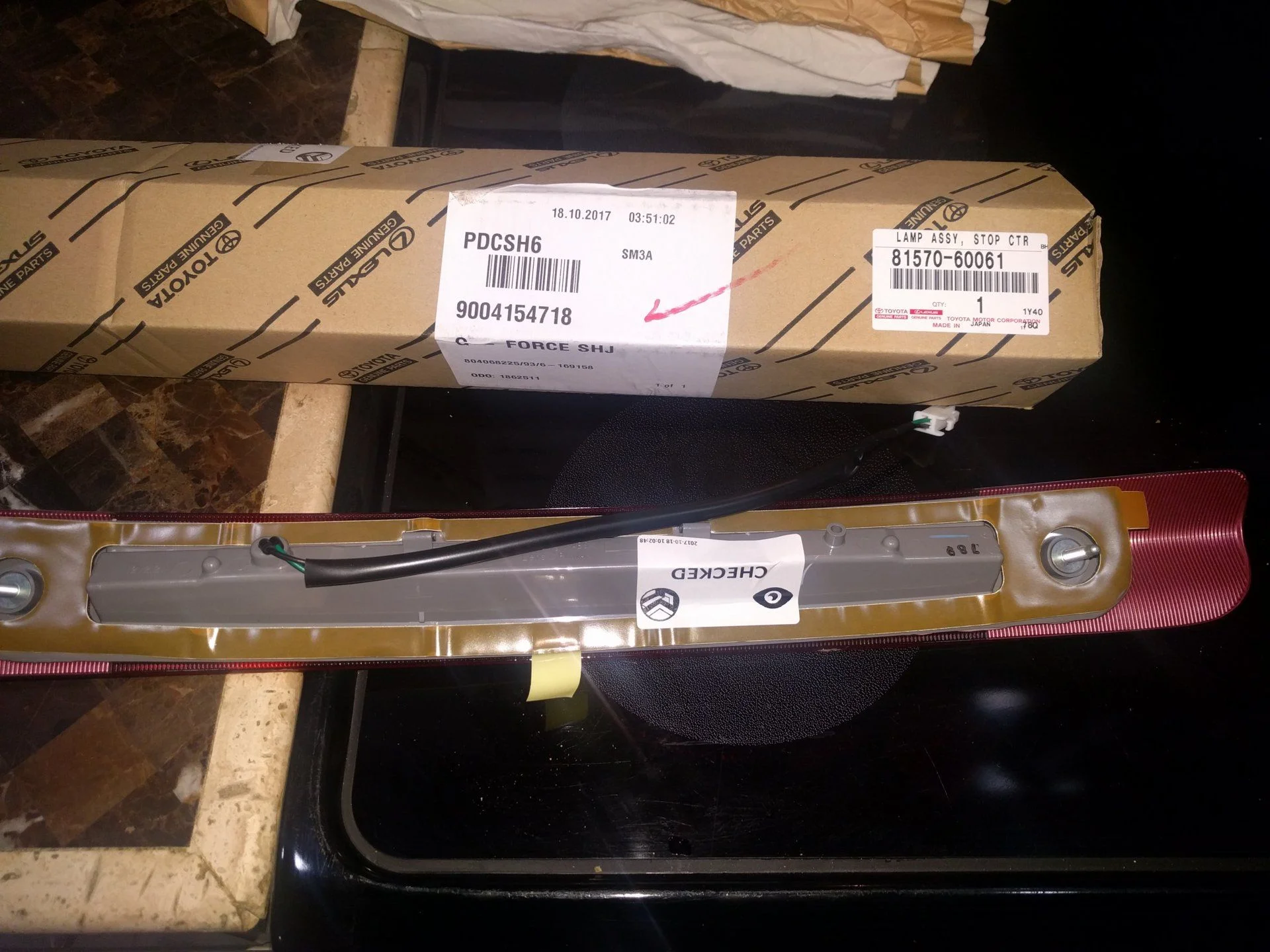

Hello! I replaced the third brake light properly. Not a terrible job. I left the inner rear hatch trim off for the time being to check for any other leak sources.
We did Ok through several rains (some of them heavy). Then I took it through the car wash for the first time after third brake light replacement, and I saw a literal waterfall streaming into the rear cargo area from the driver's side of the rear hatch. The water was gushing in as fast as the carwash sprayed. Had the inner trim piece been in place, I would likely had not known there was a leak. The water would have gone into the inner trim, and run down the sides, and then onto the rear carpet.
