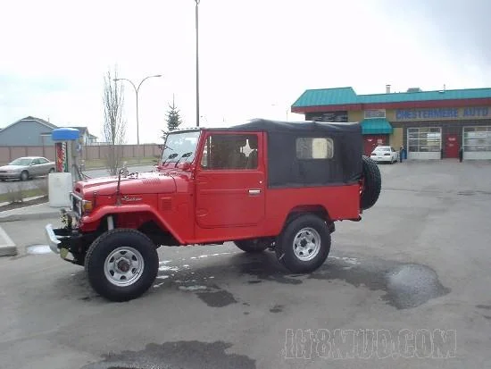

Picture was stolen from crushers post :)
I bought the same rims for my BJ60. Like em a lot.
