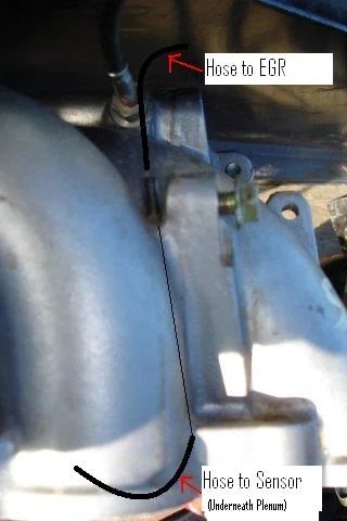

I'm going a little further than all this, I'm changing my valve cover gasket at the same time. So I removed the plenum. Here are a couple pics of the EGR tube going through the plenum. The tube is a straight shot and is about 3 inches long. At the bottom side there is another small hose that bends immediately towards the front of the vehicle. Be careful sharpening anything to go through here, don't tear the hose. Also, high pressure air through the tube may result in popping the hose off the VSV under the plenum. I imagine it would be a PITA to put back on with the plenum on the engine. In the pic showing the tube at the top, the thin black line shows the route through the plenum and direction of the hose underneath. The other is the underside shot.
I originally used the 1/16 drill bit method, too short. When I pulled the hose underneath the tube was just as clogged. The hose to the VSV was clear. BTW, the tube you see on the right of the underneath shot goes under the VSV and up the other side, so it could get clogged as well. Mine was clear.
I guess if you had the plenum off you could run the 2" long 1/16" drill bit through from both ends, instead of making a longer drilling tool.
