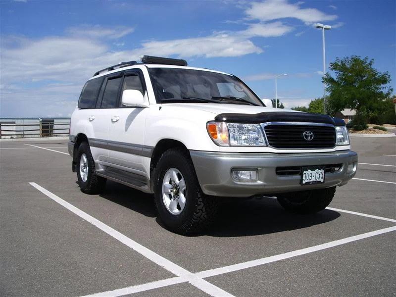

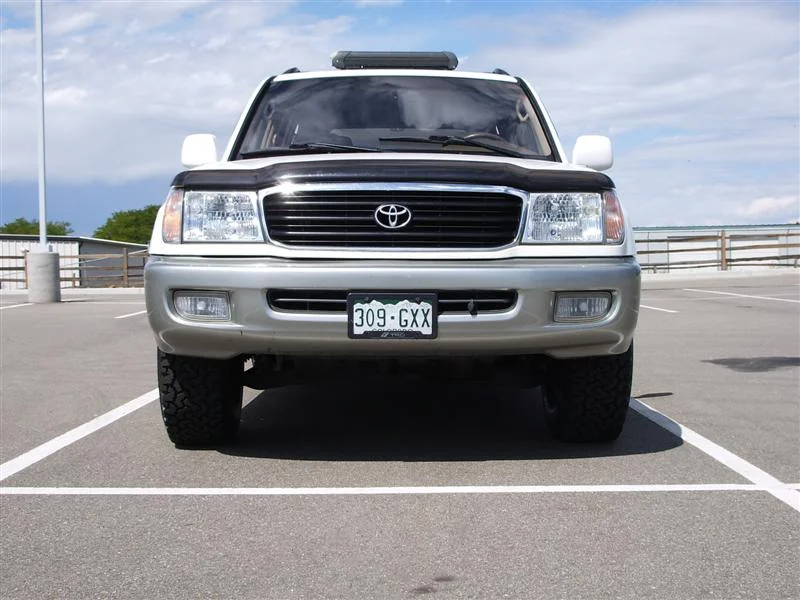

EDIT: I'm getting (5) new LT285/75/R16 BFG TA KOs installed as we speak
I'll post some pics of the new meat tonight when i get a chance.

here are a few pics of my rig:
