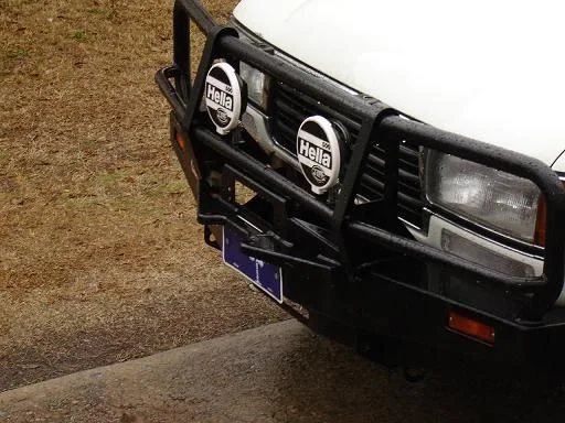

I just mounted the ARB Bull Bar on my Cruiser, and it looks fantastic. (Pics will be forthcoming). However, it really bothers me that I have that big cutout where the winch is suppossed to go and nothing in there (yet).
I believe the ARB site says the Bull Bar is made to fit the Warn M8000 and M12000 winches, but are these the only 2 winches I can use?
Assuming that I can mount a different winch in there, what would everyone recommend? Is Warn even a good winch?
