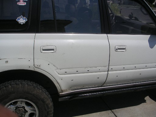

A couple shots of the side with all flares and panels removed. There are well over 50 holes per side. Removing the clips and screws holding the panels on were easy. Because I didn't plan on ever using the panels again -- and they were not in sellable condition, I just pulled the panels off. Removing the adhesive used to seal the edges of the panels was a MAJOR PITA!

The holes were covered with metal tape. I toyed with the idea of filling with metal or tack welding in some carriage bolt heads (for a kewl "riveted" look :D) or filling with metal plugs, but all these ideas meant a lot of extra time and/or $$$.
