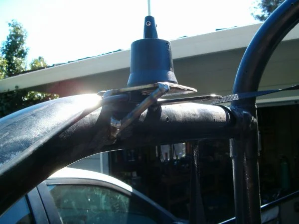

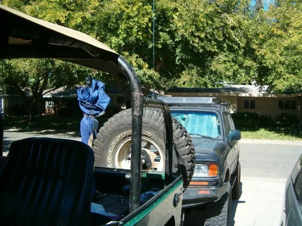

Here is a pic of the radio in my FJ40 (radio is 2 years old, same model) and the antenna mount I just made today for the rollbar. This is my 3rd antenna mount, still looking for the ideal spot. BTW-I learned something yesterday. This is a 1/2 wave antenna. Anyone know why?
It is only 1m long.
Do I win a prize?
Seriously, I don't know jack about hams (this is a ham?) except you need a licence to use one. Do you need a licence to buy one? and what is the penalty for using one without a licence?
It is only 1m long.
Do I win a prize?
No prize for you. The 5/8 whip length is the same. Good try though. When Jon sees this he will know since he is one of the high powered guys with a general license. I keep threatening to take the general test and will at some point.
Technically, you don't need a license to buy one, but every place that sells them will ask for your call sign. Bandit use will cost you $10,000 if caught! Not worth it when the tech test is trivially easy.

Notice you have an 80 series sittin' in the driveway there...do you have one of these radios mounted in that one? If so, how'd you mount that one in that rig?

That antenna does not appear to be a half wave. Now think back to your tech exam and tell us how long a half wave is at say 146.000 Mhz.
Jim-It has a base coil. The base coil is different on the 5/8 antenna. The whip is the same on these Larsen antennas. Otherwise, I agree about the length of a simple dipole.
The reason I went to 1/2 wave is because it's basically independent of a ground plane. A 5/8 wave antenna would give better performance IF the FJ40 had an acceptable ground plane/counter poise. The 1/4 wave antenna that I had before on this truck was far from ideal, and Radio Dave at Rubicon was telling me my signal was 1/2 the strength of everyone else running 2m in the group. He was at the start of the trail, when we were past Little Sluice. So, I'd been meaning to address this for some time. I will find the optimum arrangement the week before I sell the 40!
I may remount the antenna lower on the rear rack if the whip bangs into too much stuff. I was chatting with you yesterday on 5w, though I know the repeater is doing 90% of the work.

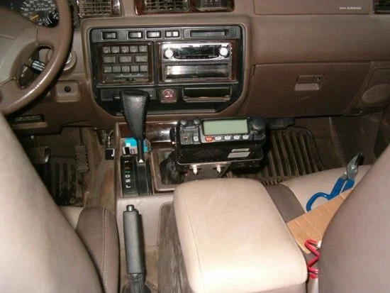

I made a bracket that attaches to the bolt in the well of the center console. This sort of shows it.
Eventually, the 80 will get a remote mounted dual bander, but for now, this quick and dirty mount has worked really well.
The antenna on the 80 is on a lip mount on the rear hatch. I run a 5/8 wave Comet antenna most of the time, but I have a flexy Comet SBB1 1/4 wave for trail/trips where the longer 5/8 wave would bang on trees and stuff.
