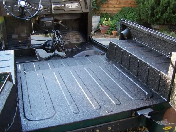

fireflyr Nov 9, 2008 Sorry it took a while to get back to you. The product is called Durabak. Here's a link: http://www.nonslipcoating.com/automotive.htm I sprayed it with a $25 undercoating gun (available from most paint shops). If you try to roll it on, it becomes very abrasive like 10 grit sandpaper. It only took about 1/2 a gallon, but I also used it to undercoat my fenders. Pat
GarnerFJ40 Nov 10, 2008 I did mine with Herculiner, but this looks like a finer grit. I like it, I think I'm going to do my second tub with it, instead.
