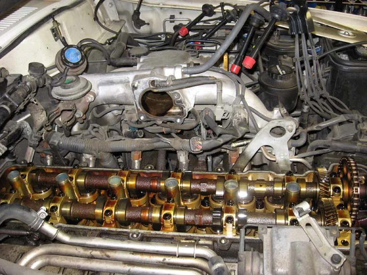

I romoved the TB to clean it and change out the old hoses. Well I thought i was awesome and could remember where all the vacum lines go, well turns out I think more highly of myself than should.
What i need is a good picture/diagram/cave drwing of all the hoses under the TB connected. I looked around in the FSM but couldn't find anything.
TIA:bang:
There should be one on a sticker underneath the hood. If not, there is one in (my 96) FSM.
Got her all buttoned up finally, this pic was quite useful with the diagram on the hood (thanks Adam!)
https://forum.ih8mud.com/attachment.php?attachmentid=237199&stc=1&d=1213160412
My pcv inlet was completely clogged with dense cakey carbon build up. Using a pic, mirror, flashlight and vacuum it broke up pretty easy just hard to get to. The tb was dirty too but not as bad as the intake, which i think was the culprit to my egr cel. Also change out all old vacuum hose while under there. Two I would have done differently; more than 3 feet of hose is needed and mark EVERY hose/pipe. :bang:
