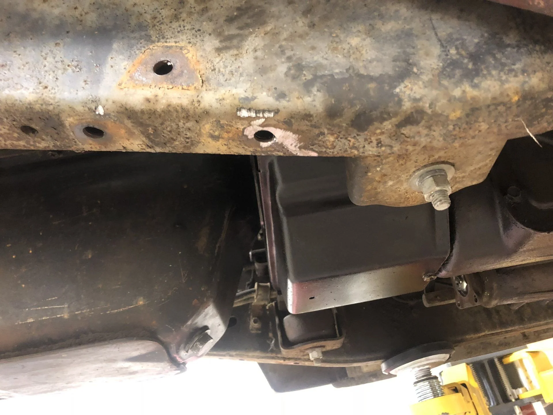

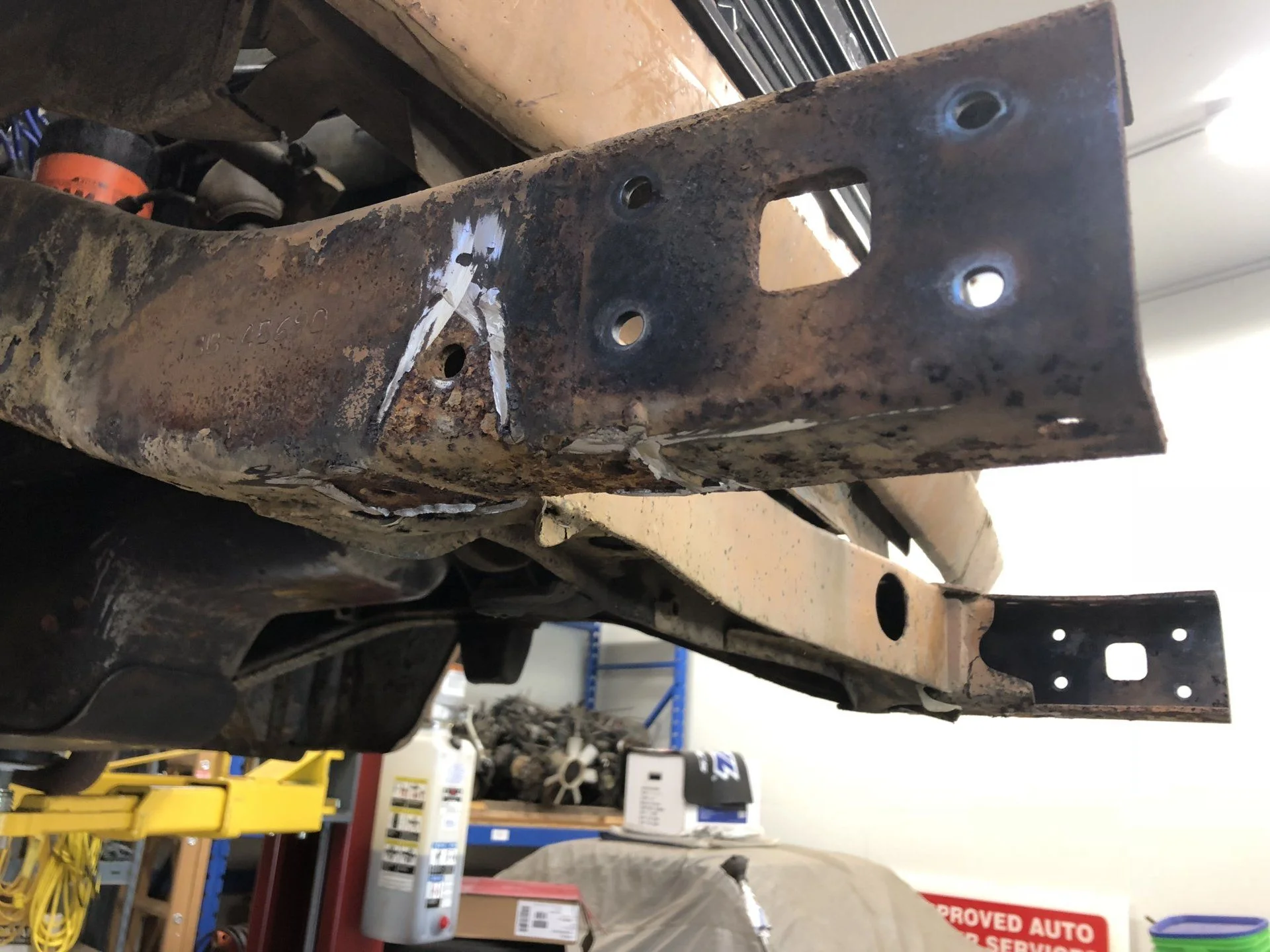

A little progress tonight, ground/drilled/air chiseled the spring hangers off.

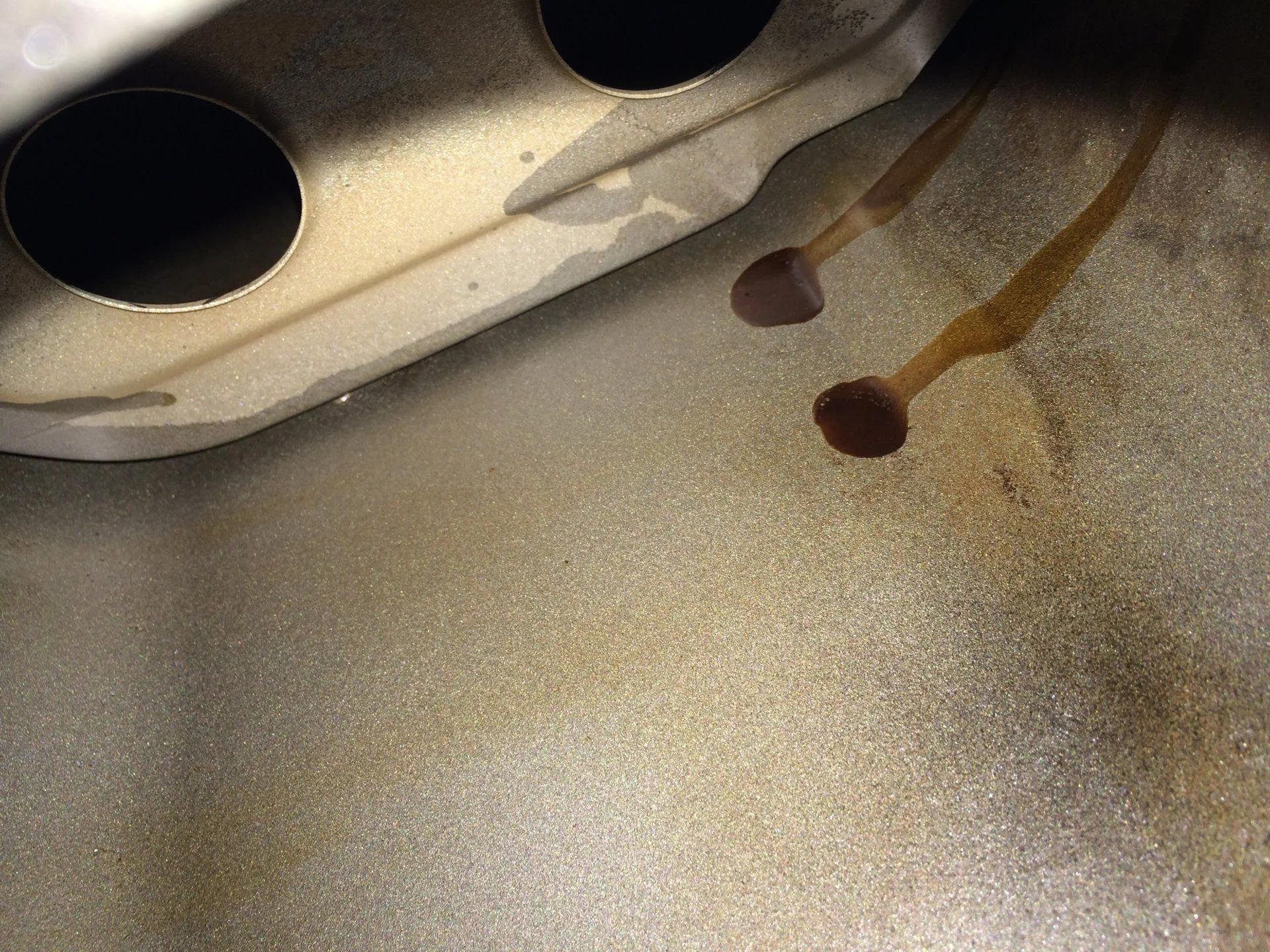

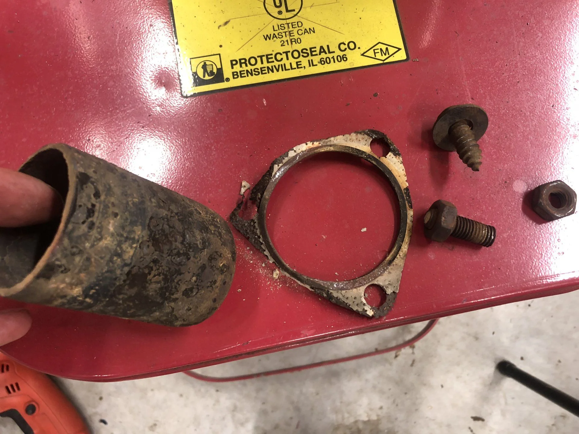

Had to detach the exhaust to get at the one rivet, wasn’t on by much...and I now know why it leaked so bad.

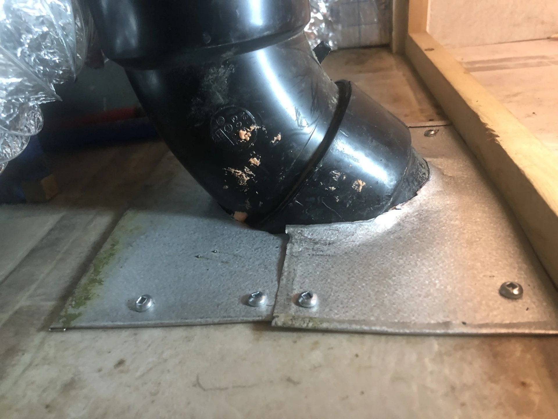

Been busy cleaning & repairing the travel trailer from the winter/spring visiting vermin, hopefully this will slow them down
no fun...also no time on the 55.

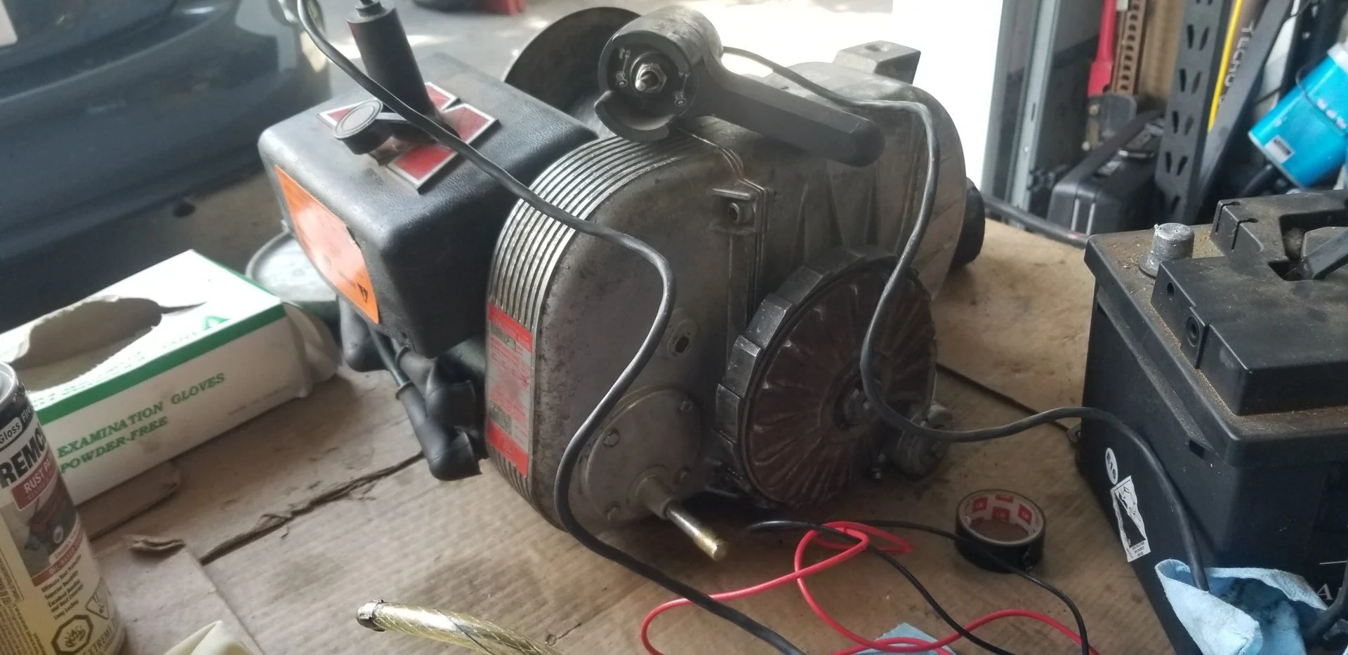

Tonight I did slip over to grab a freshened 8274 from @AJAEbj42 , thanks eh!
Need to source the correct machists knob for the clutch, if anyone knows?

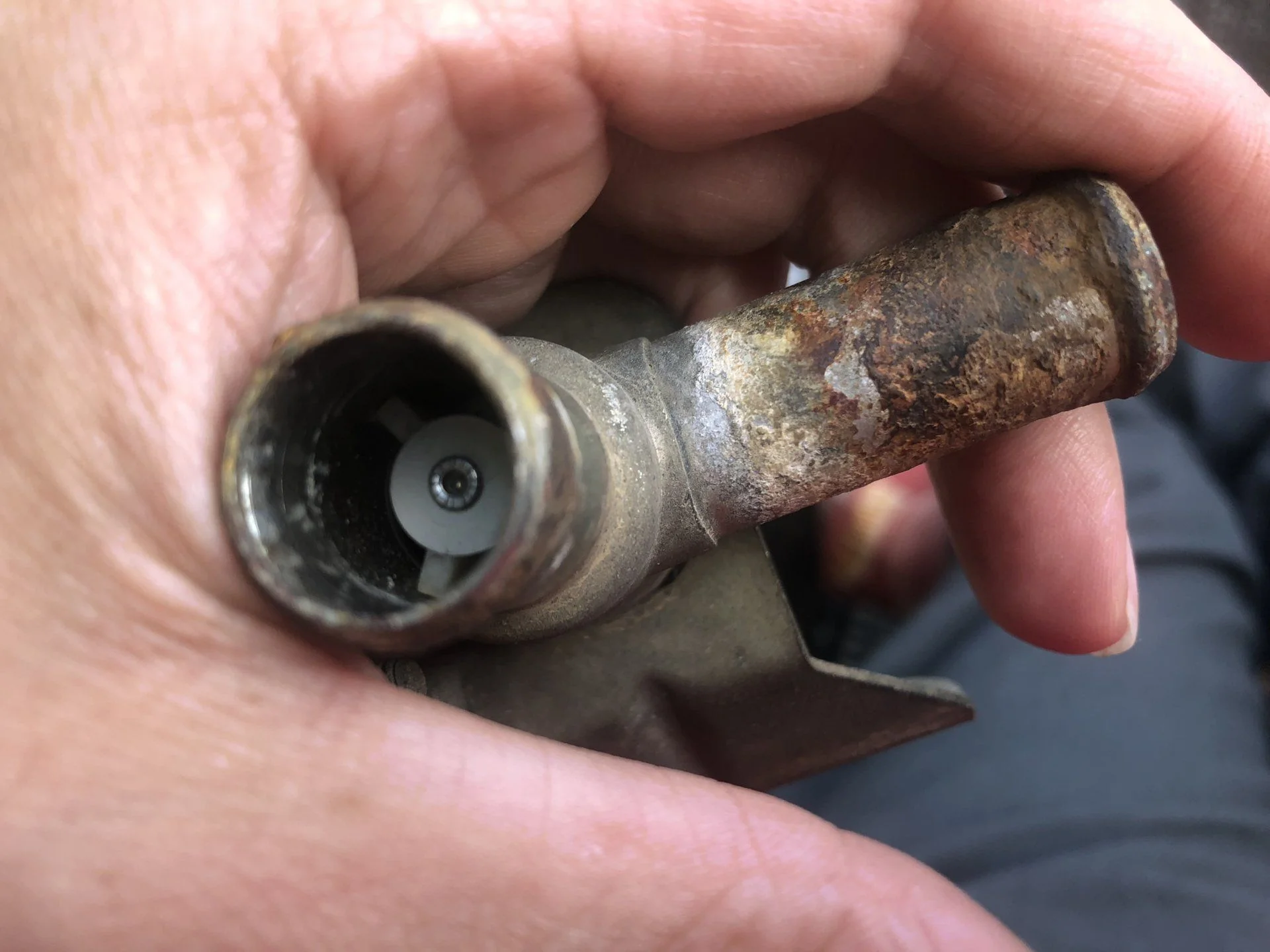

Went South at lunch and picked up my heater valve from @Pighead , wow it’s mint inside, thanks!

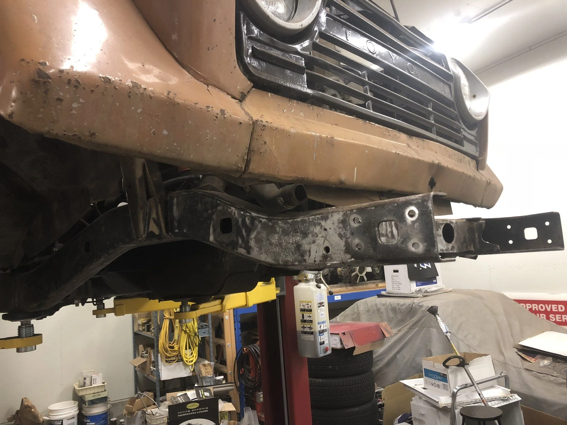

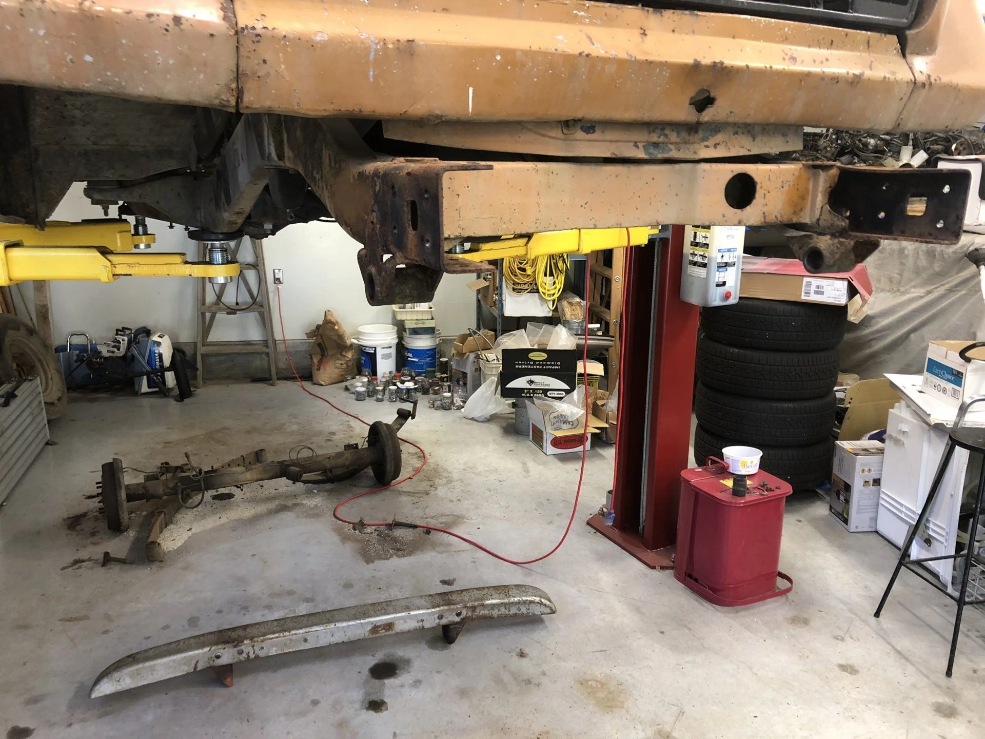

Bumper off
Front hangers off

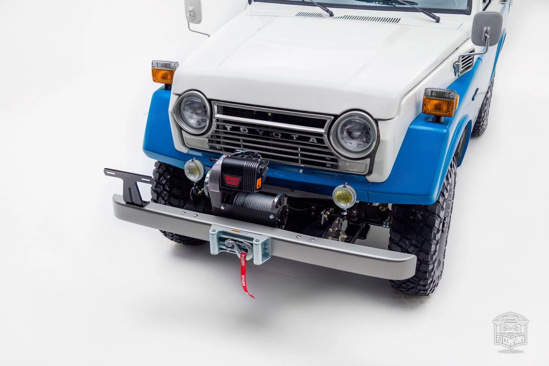

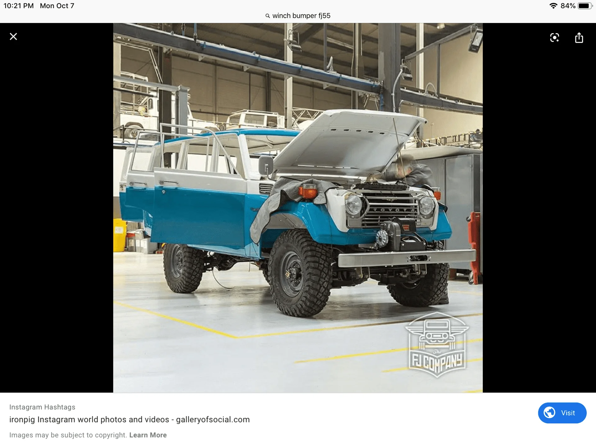

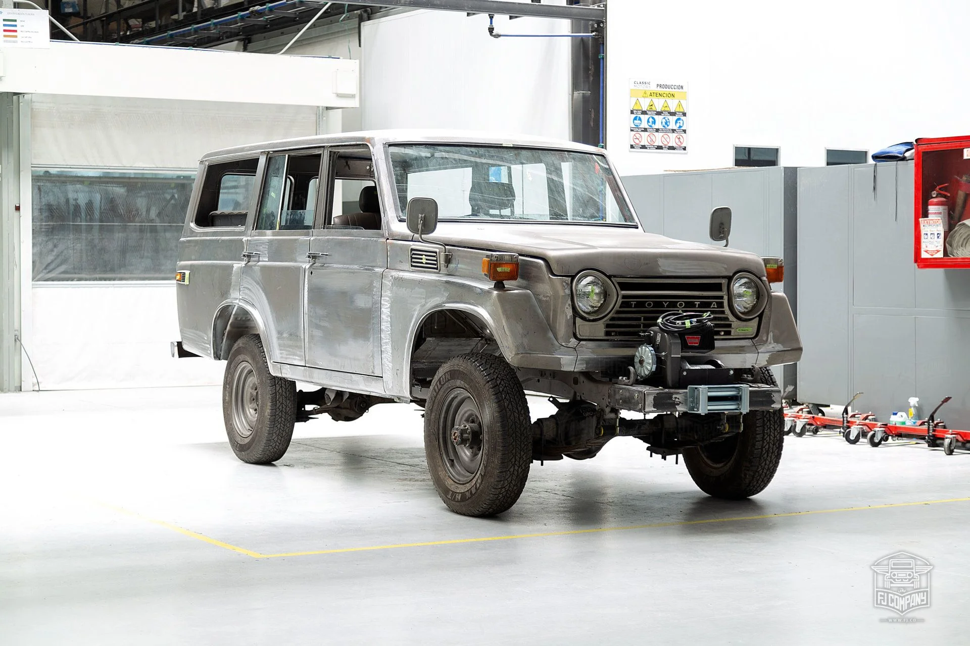

Found my winch mount inspiration too...would love to see a bit more detail if anyone is in the know.
Found a few good pics over at the FJ co...man it’s too nice to use!
That looks like the original front bumper with a winch plate and of course a hole. I'm thinking about going that way with mine and using something like this: 8274 Winch Mounting Plate
Winch cradle boxed in between the frame with the mount plate along the bottom of the rails, stock bumper with a opening cut for the rope and four bolt holes for the fairlead. Easy-peasy, lemon-squeezy.
Yeah I’ve got a pretty good idea now of how I’ll do it, I’m going to box out a fair amount of the stock bumper too I think.
