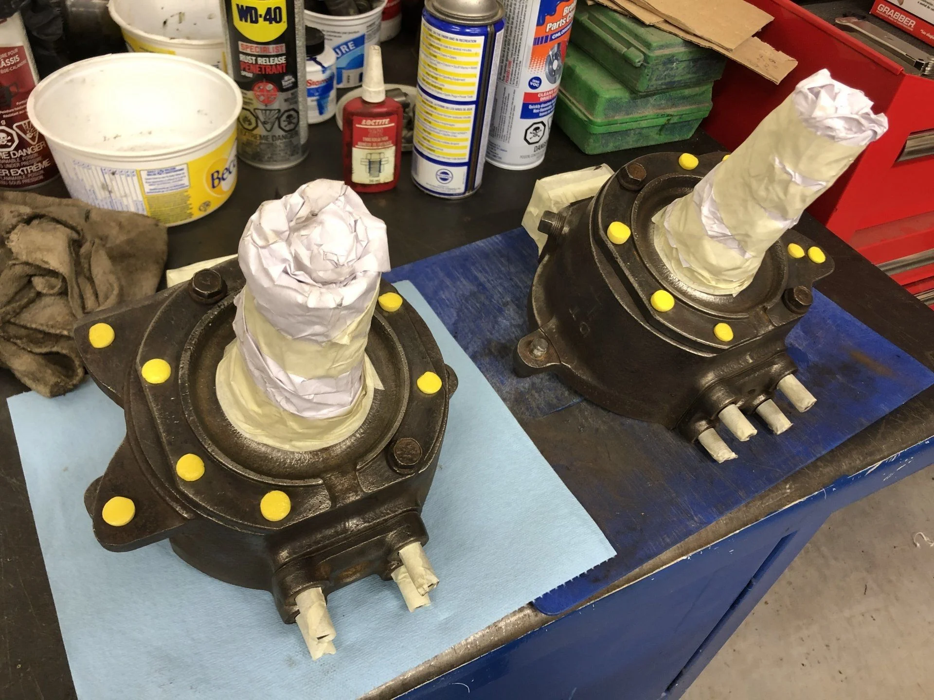

Chasing threads and cleaning today...like therapy.
I think one set of upper studs in the knuckle is beyond use as are all the spindle bolts, man that was a rusty axle.
Prime & paint tomorrow is the plan, almost like summer here today.

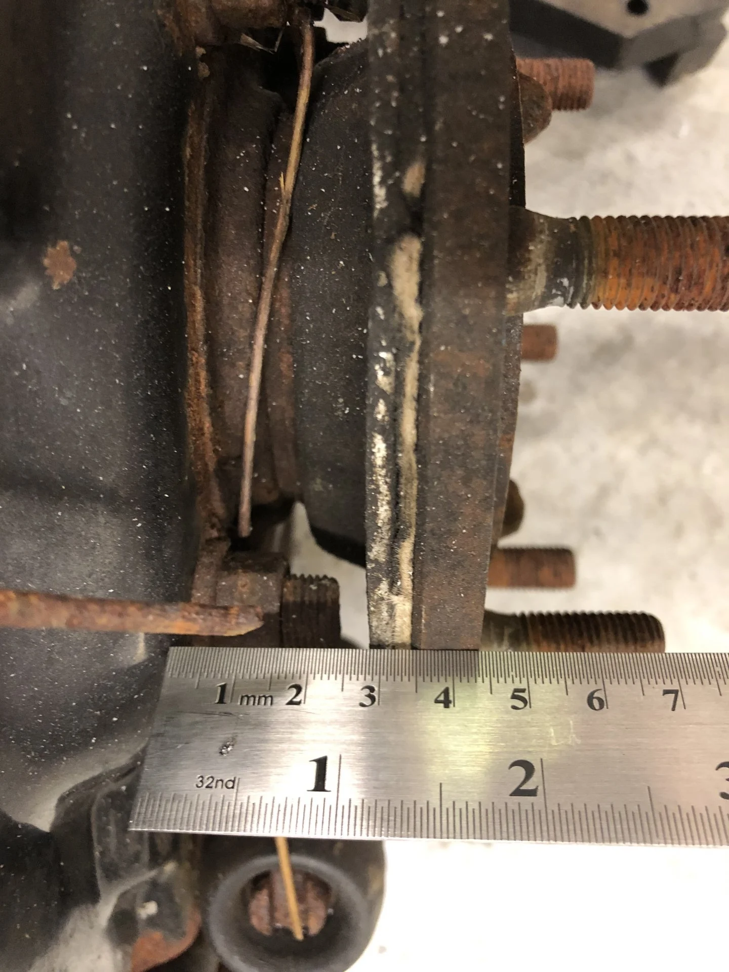

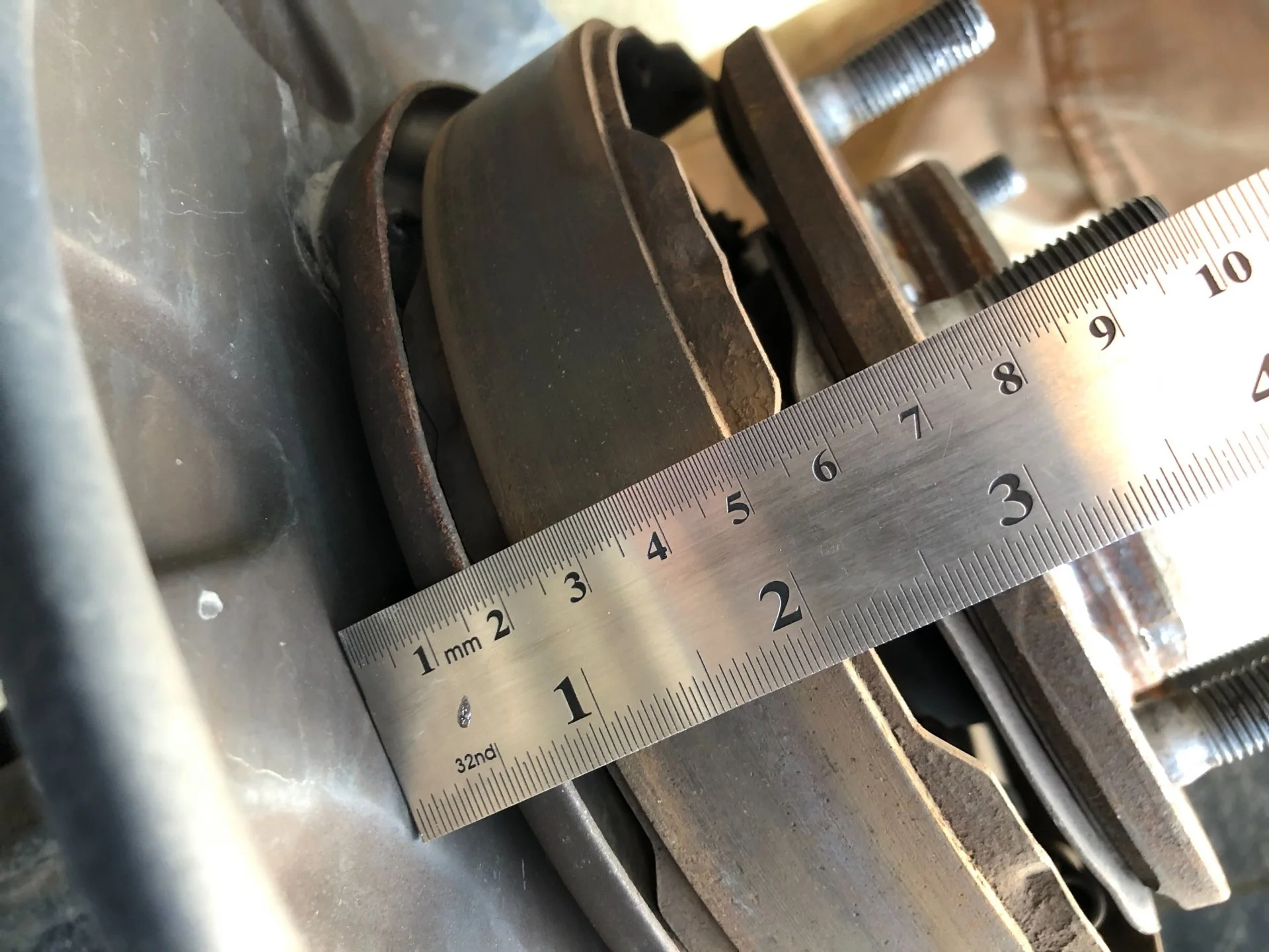

So a little research on the GX rear disks yesterday, they will fit the 15” steel wheels but I don’t see the parking brakes happening with the difference in offset between flange and housing. I was going to buy a whole axle for parts but now thinking just grab calipers & rotors...can fab caliper mounts to weld on.
60 housing
GX
Pretty big difference. Still not sure what the recipe is for going disc on a 60 rear and retaining the park brake 🤷🏻‍♂️
I think you could offset the backing plate and massage the linkage to squeeze it in there, most of the park brake is outboard of the flange location...but I’m retaining my T case brake so not needed at this time.

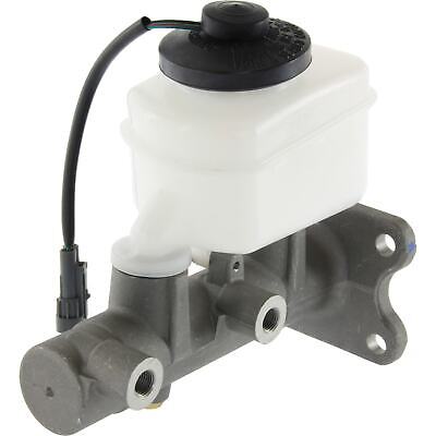

So tell me you’re finding something similar to this? 1992 - 1994 4Runner/T100
What I can’t seem to conjure up is the bore spec. The consensus I’ve been seeing for the front and rear discs using 4Runner hardware is 1.125” MC bore.
