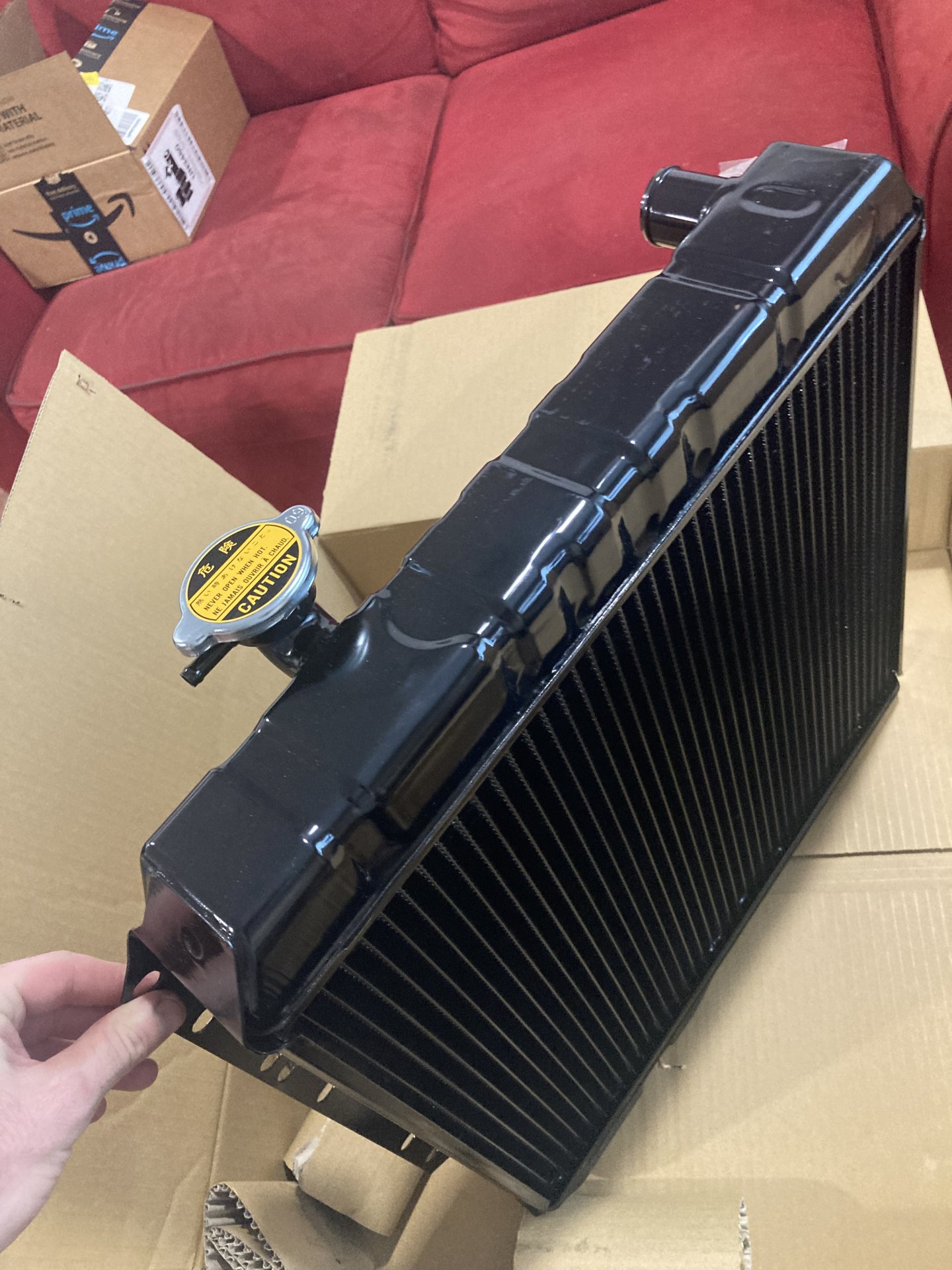

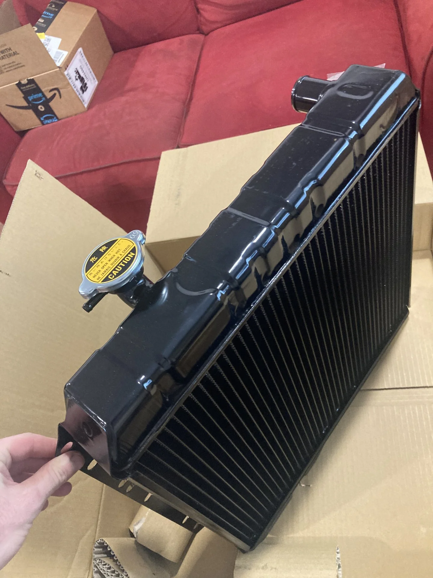

Ordered a new radiator from toyotapartsdeal, it arrived with a damaged box and a dent in the bottom tank. TPD is offering a partial refund if I keep it. Would you take the discount and run it or spend the time to wait on a another new one?

Can you pressure test it? I wonder if enough water pressure would pop that out any assuming it holds pressure. Since it looks like the bottom…depending on the discount… eh, I’d probably wait on a new one but it’s a close toss up.

Eh, it's not that bad of a dent. Find a friend with a spot weld dent puller and a slide hammer. It'll probably pop back pretty easily.

I might take that to my local radiator guy, ask what it would cost to drop that pan, massage it straight and re-solder it back. Make it perfect again. Written estimate if possible.
Add in your time and trouble.
Inform seller of cost to make you happy.
If they say no, roll the dice and have them send you another. Do you have a lot of time?
If yes, make it perfect locally or run as is, your choice.
1. Given the shape I've had radiators show up in after shipping you actually made out pretty good. 2. I would pressure test it before install (as I would any new one, dented or not) but I would not have it worked on--once you do that you own it forever, no recourse at all. If it passes the pressure test beat the discount hell out of the seller and run it 'till death do you part.

Looks like yours was packaged the same as mine. Wish I wasn't unlucky!
I started to order a CST 2888 per @GA Architect recommendation. Ended up with some time on Sunday (hard to find with small kids) and decided if the Toyota radiator pressure tested I would install it. I pressurized it, could not find any leaks with soapy water and dropped it with all new hoses and a flush of the engine.
Working fine and according to the gauge the engine is running 2 needle widths cooler ;)

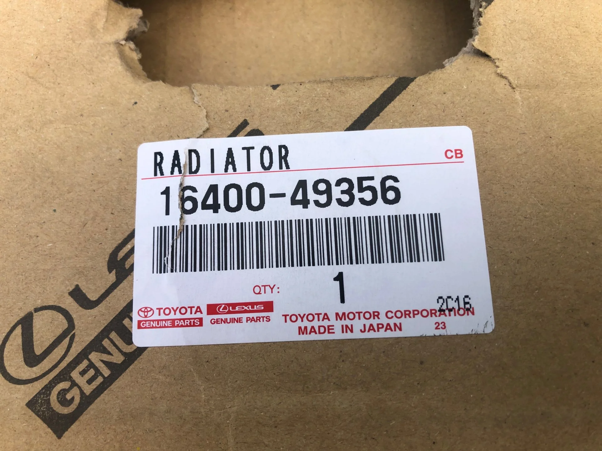

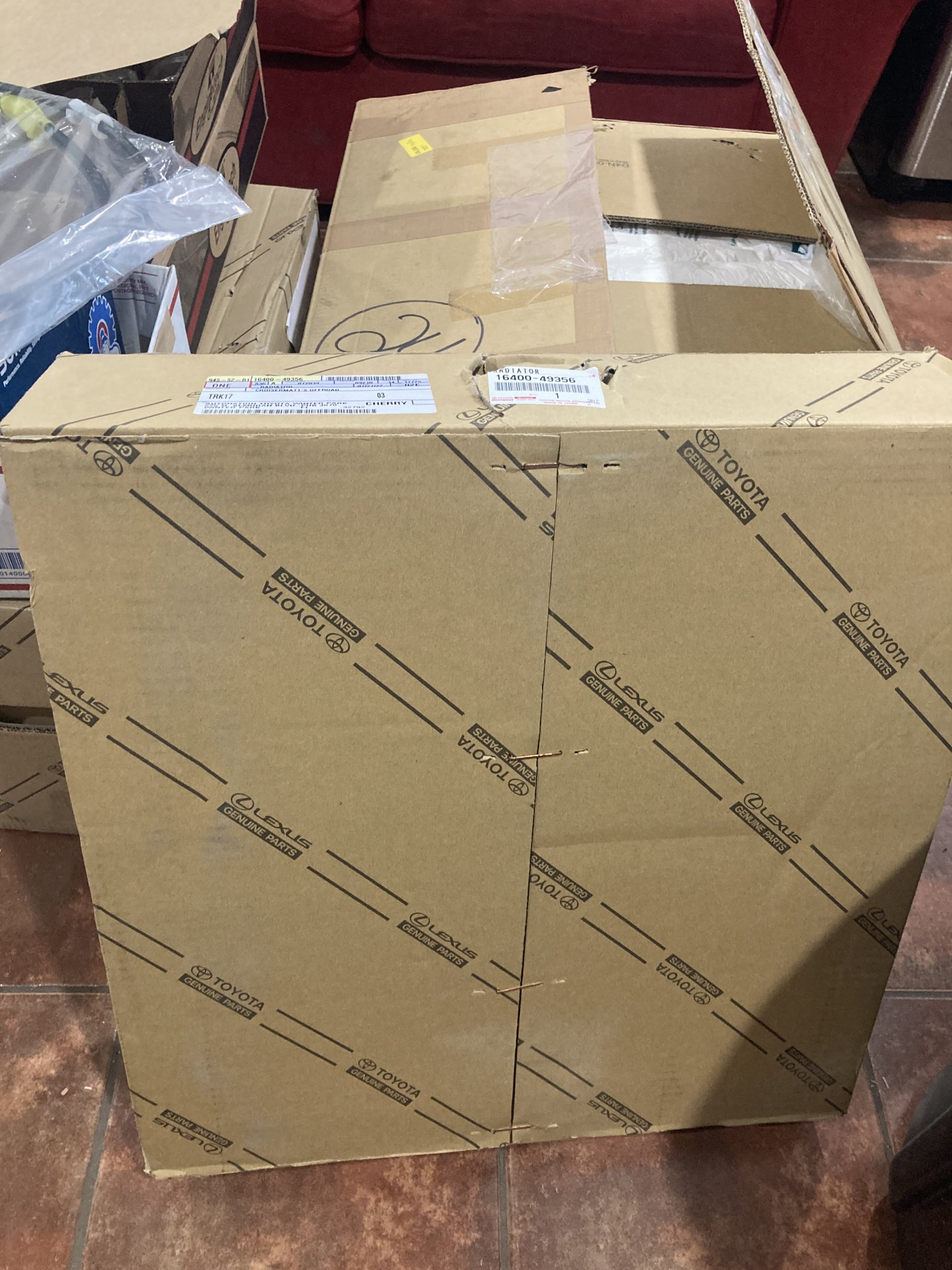

Ordered a new OEM 2F radiator from City Racer. Roger does a wonderful job of packing it up. It arrived in the original Toyota box which was inside another box. FYI: the 2F radiator fits our 1F 1970.

I would so sooner run a non-OEM than a damaged one; not saying that good OEM ones can't be found. I once soldered shut a break on a '73 radiator with electrical, inner fluxed, because it had a break, not far from the shipping fold pictured on the brand-new one in the initial post. Who knows how well it will hold up to heat cycling, etc. Plus, the analog meter on the combination cluster will give you a good sense of whether or not a generic radiator is working or not.
