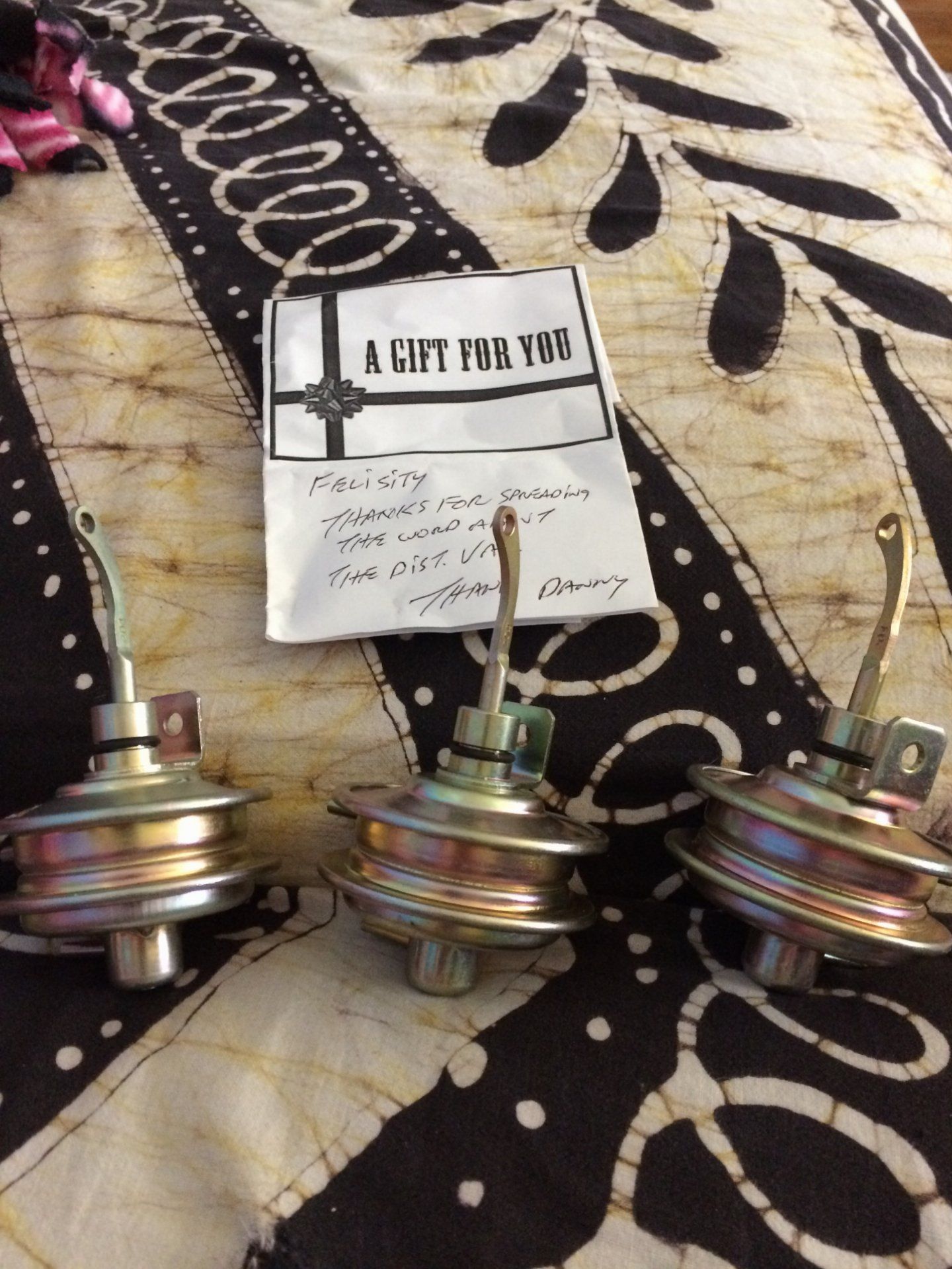

Yes I get that. When I found that my inner port on my vac adv on the diz was blown I swapped the line for the outer and advanced the timing to about 10.
Last night I backed the timing off some and have since capped the vac adv on the carb. I also added a paper clip to the secondary diaphragm rod on the carb. Took it for a hard drive up and down the twin hills I live on and neither time in third and WOT or forth did it move so I'll be swapping out the spring on it. I'll say I noted the pop pop on decel and downshift to be far less since tweaking her back.

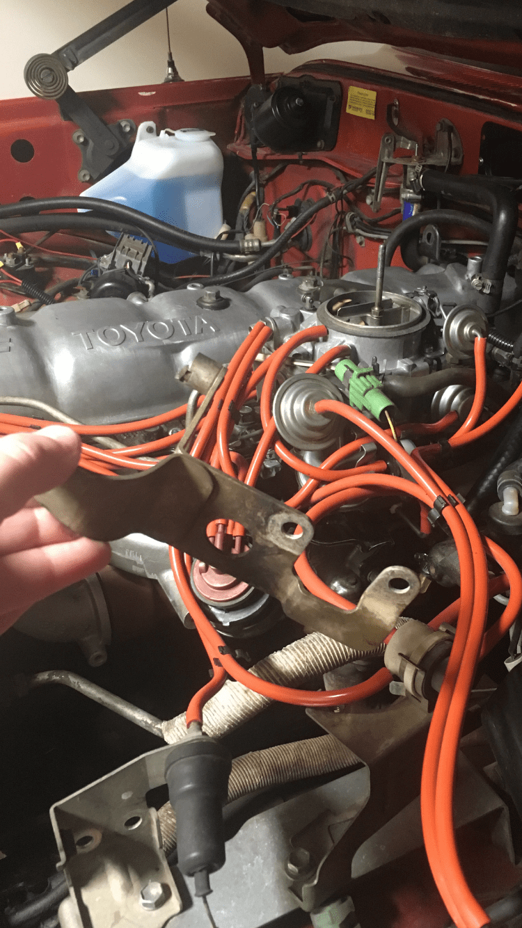

I am so dragging ass on pulling the manifolds again to swap the gasket w/ a remflex I picked up a few weeks back. I know I've got some leaks along that far right edge near the firewall. My son will be w/ his dad on the longest stretch ever, 10 days starting 7/7 to 7/17. I suppose that will be the time. Lots of swearing, a beer or two and many bloodied knuckles on the horizon. Woohoo. I know one of these days I'll be able to look back and see how far I've come but some days it just flat out pisses me off at how much work I've done and I'm still struggling.
Hang in there, F. You'll find that it will go MUCH fasted this time around. You know where everything goes, what order to remove and replace, and none of the bolts will be seized. It makes a huge difference.
