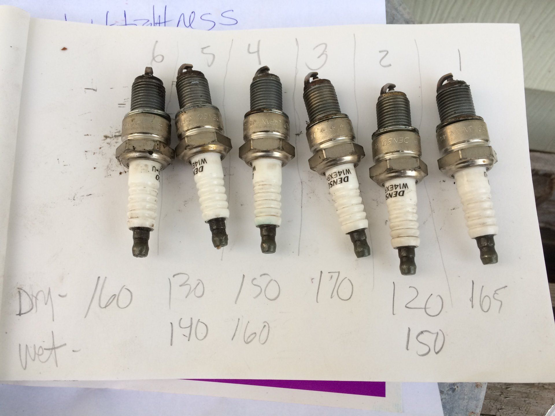

Compression test today. Thoughts from the mud crowd? About to do another valve adjustment since I've got the plugs out.

Mud folks who know compression numbers... what are your thoughts please. Seems like after last nights adjustment that seemed to go so well quickly went south today. Can't get the truck to idle off choke for squat.

The compression numbers are a concern, could be some ring wear, but they are generally within 20% of each other after the wet test. . .
What did the sparkplug electrodes look like? Are all the plug wires snugged?

Plugs were gray and in fairly decent shape but they haven't been driven much. All plug wires snug. I'll check the cap again tmrw after work. Maybe get do another compression test. Who knows... I had the chart infront of me but it was dark (tho I had a light), maybe I messed up.

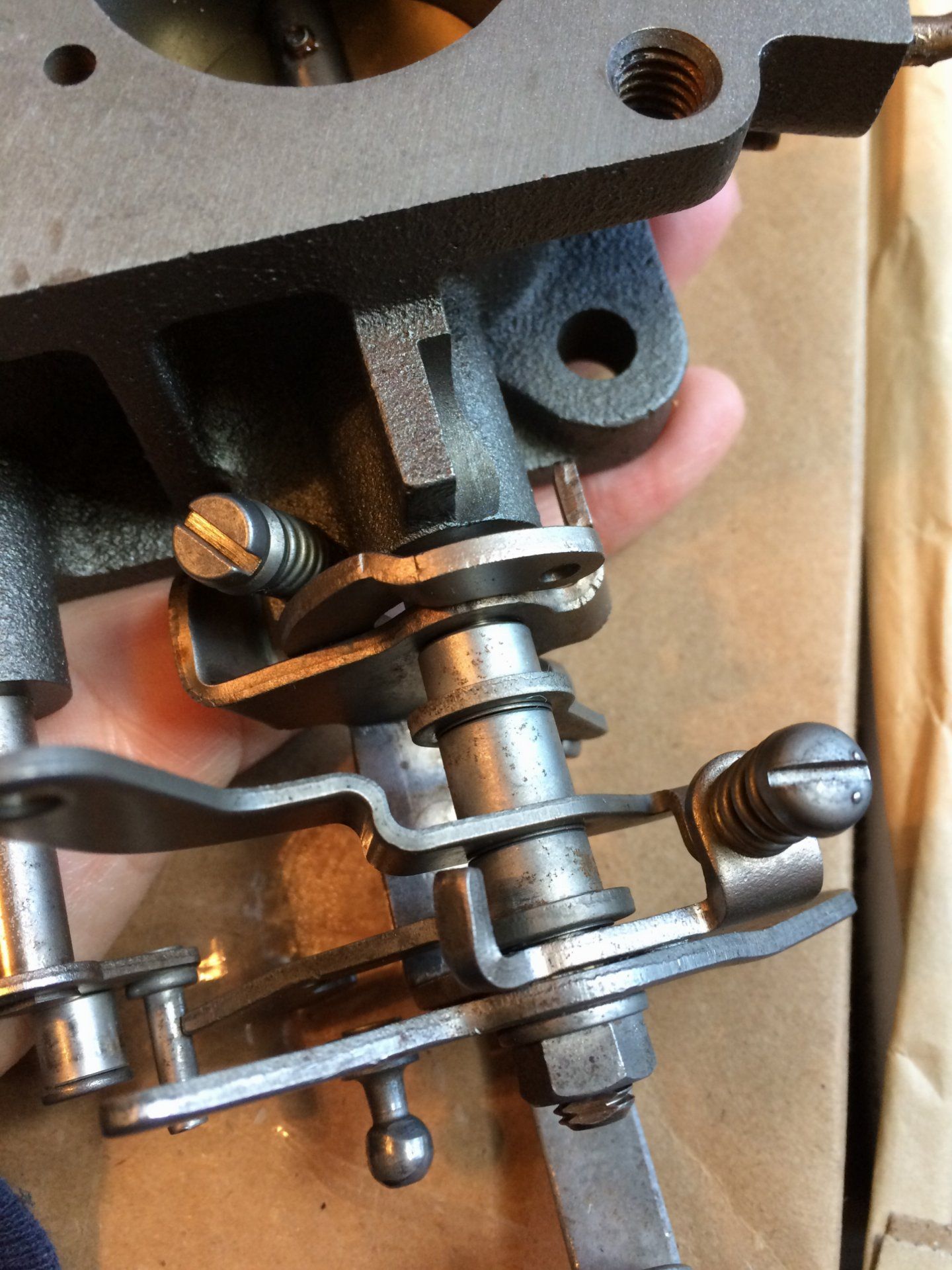

So my carb base is on its way back w/ new throttle bushings. Huge thanks to @mwebfj60 for a set of plates as well. The carb guy, Mark said they are like brand new pristine pieces compared to the stone age hand poured, hand cut and hand hammered ones that were in there!

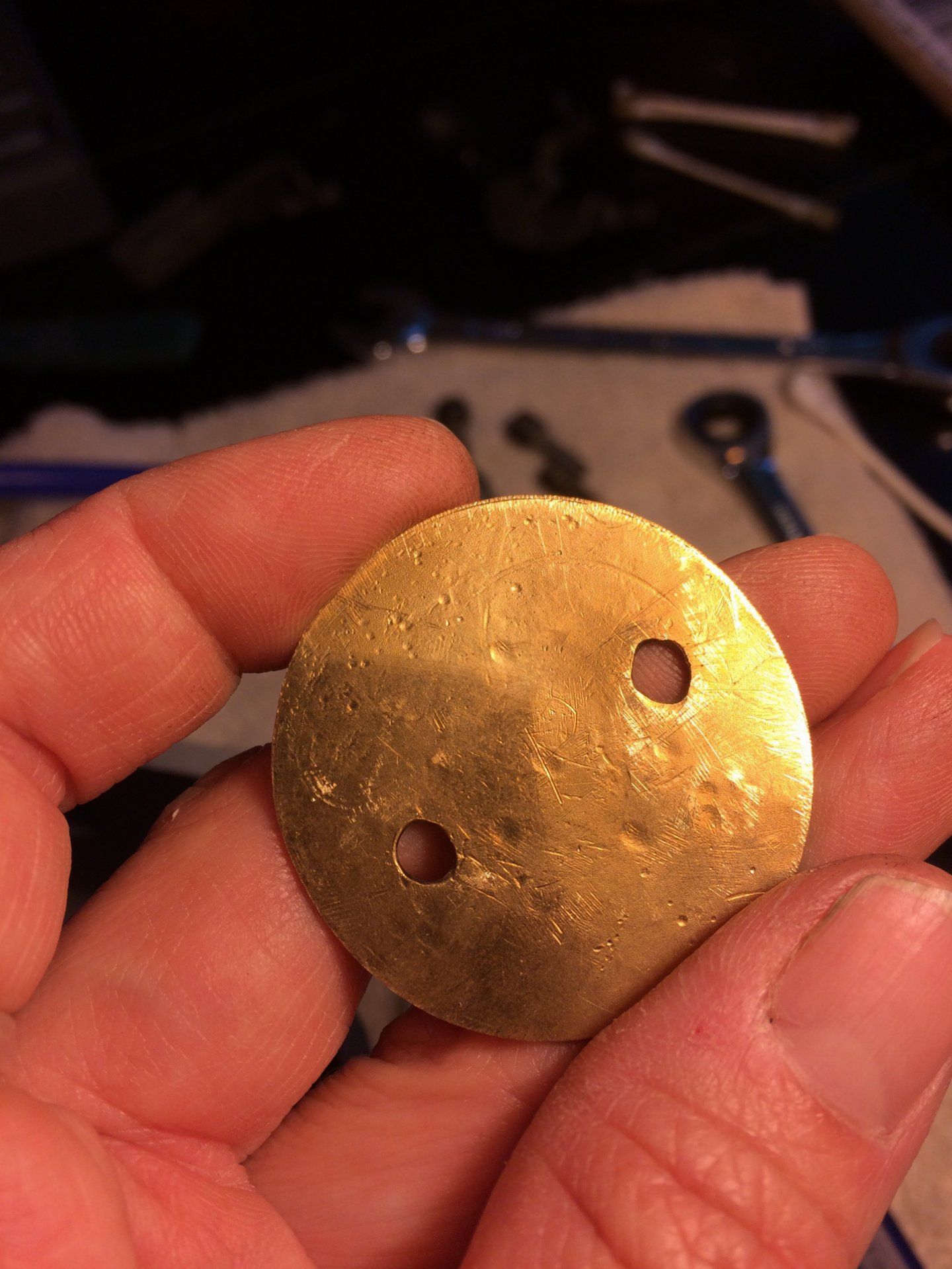

Welp she's back and she's beeeeautiful. $80 for a new primary throttle bushing and he swapped out my plates for a set in much better condition from @mwebfj60 w/ new screws as well. He resurfaced both sides and cleaned her up big time. As well as he checked out my IM screw and smoothed out some rings it had embedded in it.
Checking the power piston as the carb guy suggested. Pulled the acc again and soaking it since it's been out for awhile and was pretty dry.

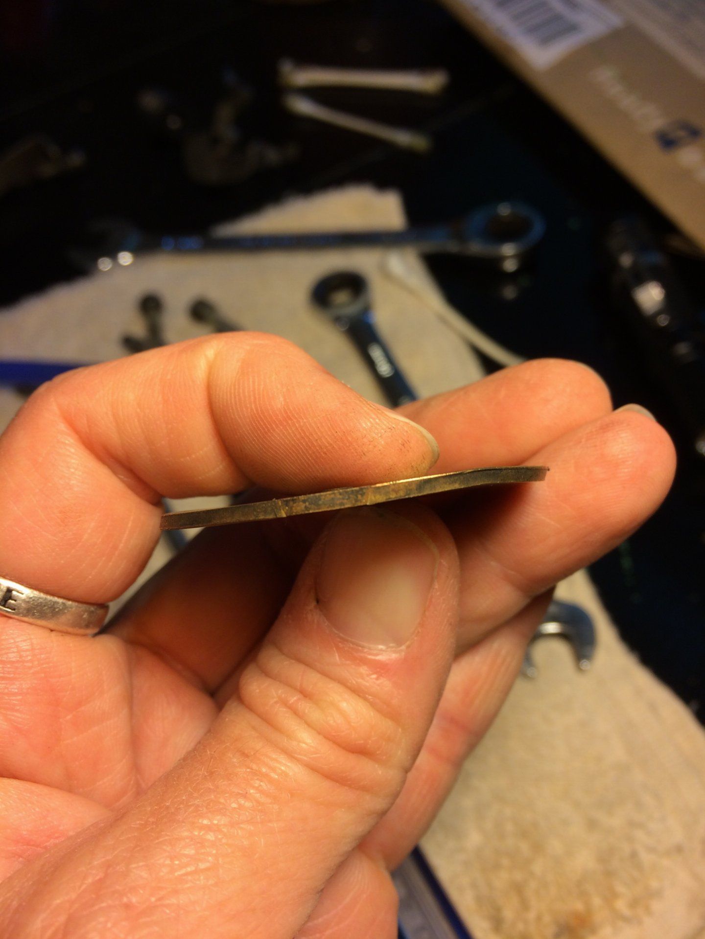

My primary plate literally had cut ridges in the edge as if it was hand cut. As well as the fact it was bent.
A or R? ;) someone's personal stamp maybe.
