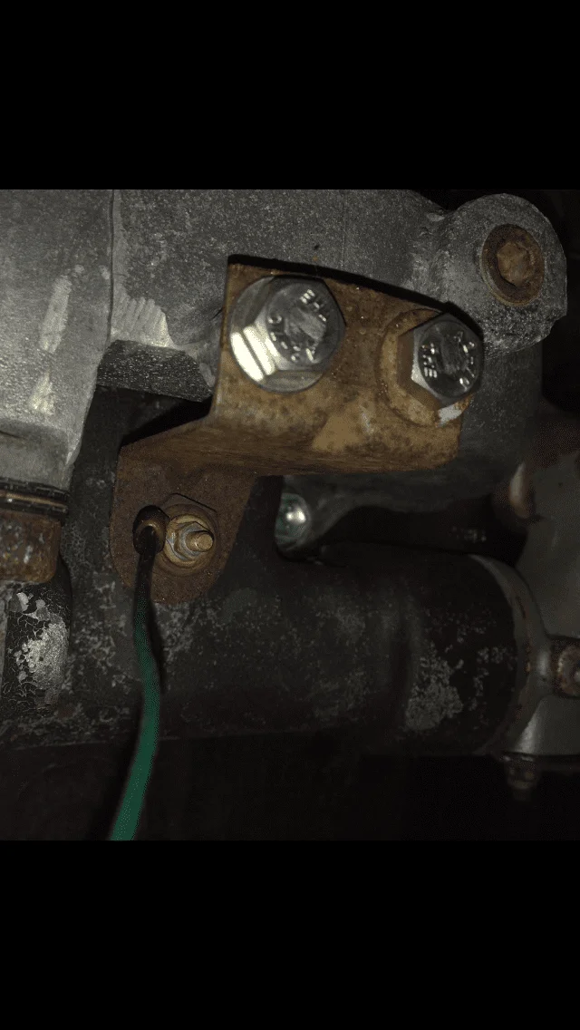

Manifold heat sensor. It's mounted to the pcv hard pipe off the exhaust egr. Cut it off, file it, make a new ring (18g wire is what I used; it goes to the carb fan plug), then mount it to the two holes that it matches on the intake manifold. I'll get a pix in a few minutes when my battery is more charged up.
@LittleRedWgon, Scuse how ugly. Like I said that high temp exhaust rattle can paint blows. Wire is a third from the ICS. Often it's hanging out of the loam broken. Require it w/ a small ring and add it to the temp sensor and mount w/ new bolts and washers. I don't remember the size. I think whatever size holds the carb insulator plate down worked.
