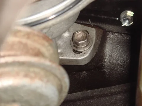

Added the timing light and even at tdc and the bb my gut is telling me I'm off by a tooth because the diz bolt is not centered at all in the gap on the housing. Pulled the diz cap while at TDC on #6 and someone confirmed it looked right. I've got some more reading to do....

When I was getting ready to adjust the valves on my '84 FJ60 on Thursday, I made a note of where the #1 plug wire on the distributor cap was relative to a bolt on the side of the cylinder head (in your photo it's the bolt just above the bend on the blue vacuum hose, just to the rear of plug #4). It was pointing slightly to the rear of the bolt centerline. In your photo, it would also be aligned directly with pushrod #8. I then checked the pointer relative to the line on the flywheel, and from what my old eyes could tell, it was pretty much lined up. I did the same with #6 after adjusting the first set of valves. I'm very sure my distributor is installed in the correct orientation - I've owned the vehicle since new and I know the distributor has never been removed.
It looks to me, but don't take my word for it, like your rotor is pointing a little forward of where mine was at TDC. Could it be one tooth off? I don't know. Maybe someone who knows a lot more than I do will chime in also.
When the distributor is installed correctly, when set at 7° BTDC, (the round ball on the flywheel) the lock bolt for the distributor will be pretty much centered in the distributor curved slot. Like in the picture below.
If you're suspicious that maybe you're a tooth off, you don't need to pull the dissy to find out.
Just move all the spark plug wires on the distributor cap up to the next terminal number - or back to the previous number depending on if you think it's too advanced or too retarded.
Example: move spark plug #1 wire on the cap to terminal #2, and wire #2 to #3 etc. Then -try- to start the engine.
If it runs like Royal Crap or not at all, move all the wires back two terminals (1 to 6, 6 to 5 etc) and try that.
If you find that you are a tooth off, it's best to pull the dissy & try stabbing it again. It will get too confusing if your spark wires don't match up with the cap.
@OSS yes that's exactly why I think I'm off. The bolt is at the top most of the gap for TDC (making it crazy retarded) which I knew after seeing it again for the second timing trying to time it that I was right.
