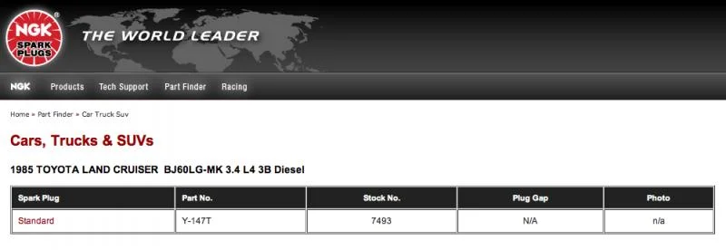

On the other hand, the NGK site itself has the 3B in its database and lists the plugs shown in the screengrab below:
Can anyone verify either of these parts as being the right match? Need 6V 9.8 A plug here.
This thread https://forum.ih8mud.com/diesel-tech-24-volts-systems/270949-y107r-vs-y147t.html says the NGK plugs are 10.5 volt which is not good with my functional superglow system.
