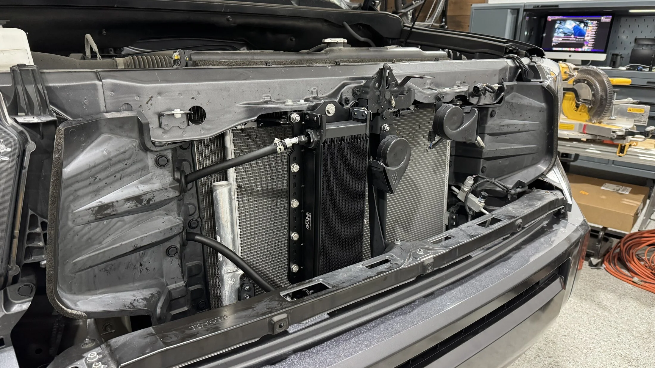

I have a 2021. I went with the plug-and-play but expensive Genuine Cooling Systems kit.
I'm pretty sure you could source everything in the kit for cheaper but I needed to start towing and didn't have the time to figure it all out. I've been towing a 7K lb trailer all over and I'm seeing highs on the torque converter around 230. Unloaded I'm 190-210

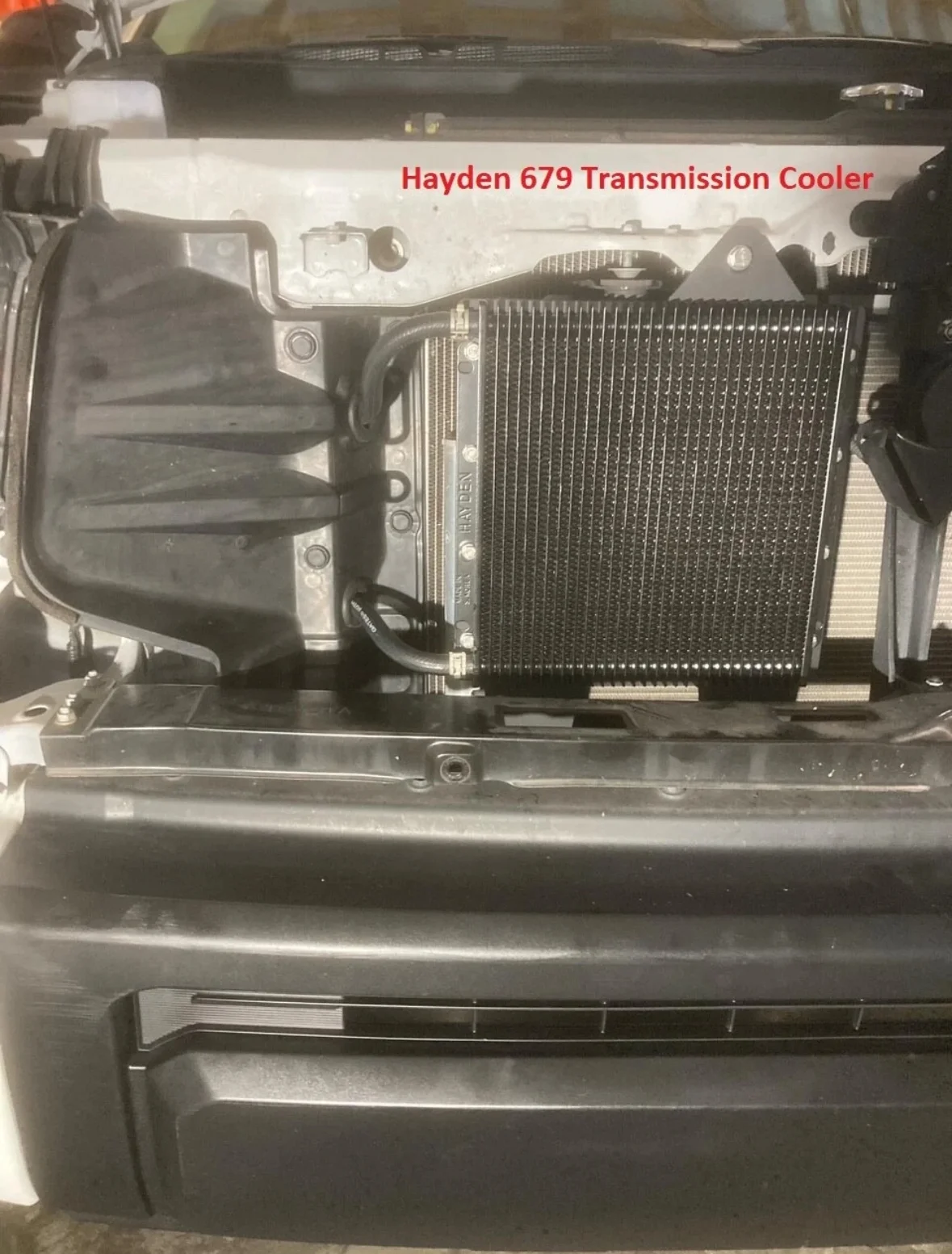

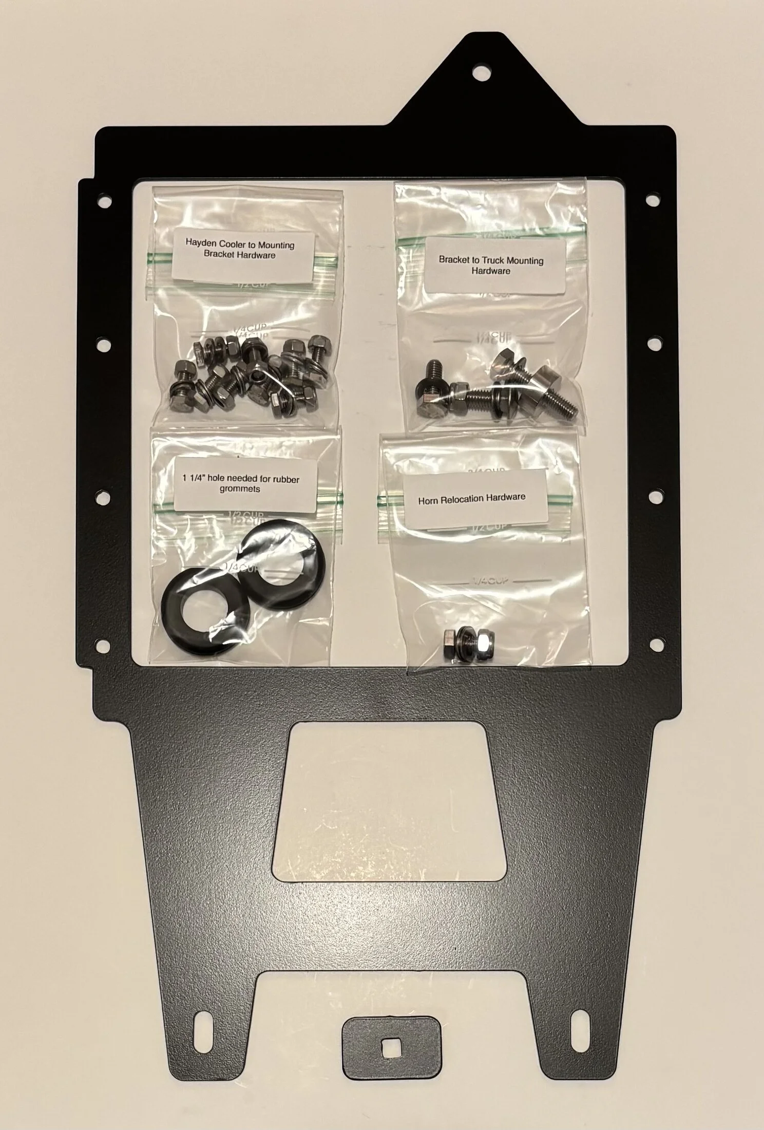

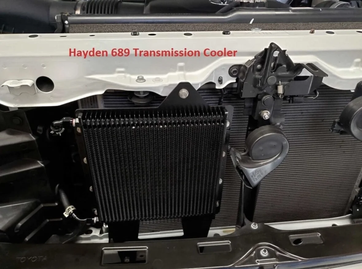

I’ve produced a mounting bracket for Tundras and another for Sequoias that use the Hayden 679 or 689. I have these listed on another forum and on eBay. I’m going to get around to posting in the classifieds. I choose these Hayden’s due to their rated capacities and cost. I prefer the 689 due to the AN fittings and smoother hose routing.

I prefer the Hayden 689 cooler for the use of the AN fittings. The bracket uses factory holes/threads in the radiator support. I can always send more information via PM if needed.

This is what promoted me to create the CAD file for the bracket, I’m a DIY oriented person. You got a deal on the labor at an hour. It takes me a few hours to install and do a fluid check.
