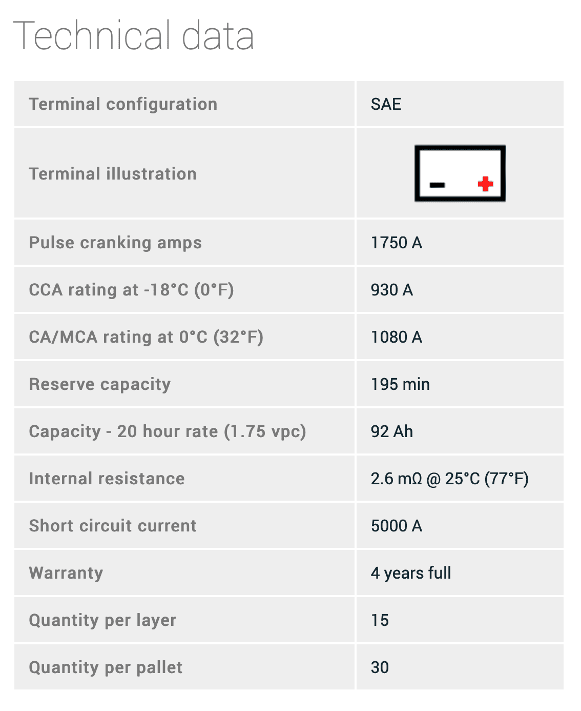

Northstar 27f $355

I think the Northstar is the only AGM that’s the 27f size, not that other sizes won’t fit.
Im running an X2 power from batteries plus bulbs that’s a rebranded northstar, they had a rebate when I got it so it was cheaper than the Northstar, so far it’s great.
Unfortunately no Batteries Plus near me. And the discounts don't include delivery...
