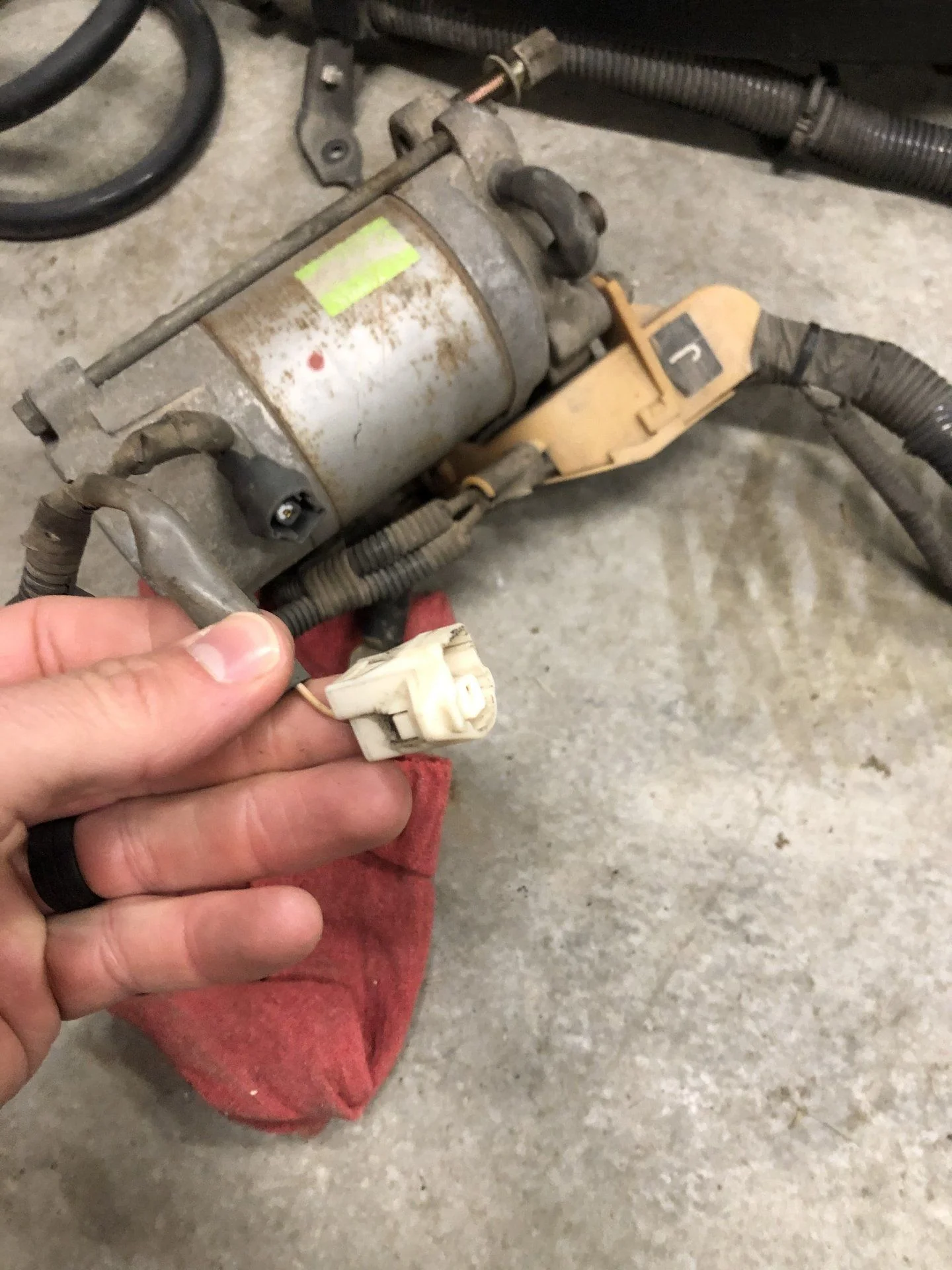

Trying to finish up parts ordering for the rebuild. While taking apart I broke the tab on this guy that connects down by the starter. Anyone know how to find it or have a PN ?
MAY sill be available from dealer from what I can see
What's the 5-digit number embossed on the connector? Add 90980 to it and you get the Toyota PN.
I would have never found that number if you hadn't mentioned it. I had already looked once and didn't see it. Had to spit shine it a bit in order to read them. 11188 or 11166 wasn't totally sure so I ordered both. Thank you for this little gem of information.
