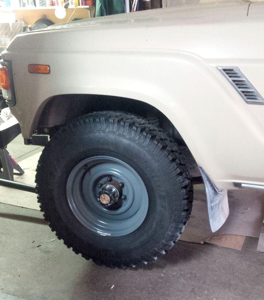

Another set of the Vintique "Smoothies" from Summit successfully wrapped and mounted.
For those keeping score:
Wheel Vintiuques 12 Series Smoothie Wheels
16x7, 4" Backspacing
Summit Racing P/N: WVI-12-670604
Rustoleum Dark Gray Gloss + Rustoleum clear coat
No Spacers
OME 2.5" lift, stock brakes + TREs. TREs clear by about 1/2"
Cooper Discoverer S/T in 255/85r16 (~33x10.5x16)
Thanks to @love2fly and @89cruiserfj62 for figuring out these wheels and posting their results.

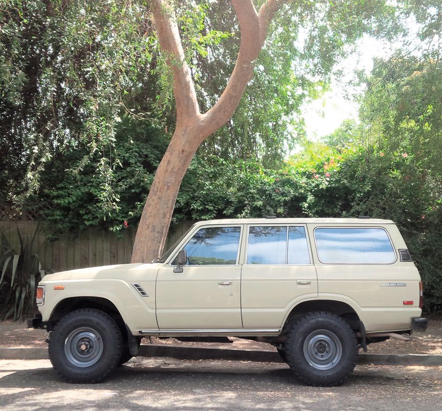

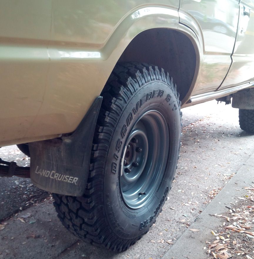

We all know that these 70 series wheels work, but I thought I'd post up the pics anyway. They have 255 85R16 Cooper Discoverer STs on them and are held up by the complete Dobinson Suspension system for the HJ61 that I recently had installed.
