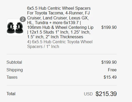

Finally found a very high quality product here in SoCal. I think there's one post somewhere that a member had a bad experience but it worked well for me. It's Custom Wheel Adapters in San Bernardino, CA and for the 3rd Gen, you want the hub-centric with the 106 mm center bore. Conservative 'bare minimum' is the 1-inch and it's perfect. Very high quality materials, excellent machining, and high quality studs and nuts. They arrived three business days after I ordered online. (The picture of the tire interference and the snowflake rims are from an online search for illustration.) Cost to my door is shown below for 8 spacers. Yes, eight spacers, aerospace grade alloy, aerospace grade fasteners, CNC machined, and Made in USA. Americans still make great products, don't let anyone convince you otherwise. No brainer installation. Buy some brake cleaner and non-residue degreaser, some Permatex anti-seize, Loctite. Get out your 21 mm socket, your torque wrench, a 19 mm socket for the nuts on the spacer, and a jack + jackstands.

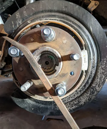

Also, get a 36-48-inch long steel stake from 'Big Box' construction supplies... you want the basic steel stake used for concrete forms (~1/4 in thick x 1.5 wide). Why? Some people say 'place your car in 4wd to lock the axles' or some such advice. I don't care to stress internals needlessly. 1. After cleaning, placing the antiseize, put the spacer nuts by hand down 1.5 threads and squirt loctite into the nut. 2. Ratchet them down criss cross snugly. 3. To torque down the nuts on the spacer, put three of your OEM lug nuts on the studs of the spacer, equally spaced in a 'triangle'. 4. Slip the steel bar at an angle so one end touches the ground and the other end slips between the two OEM lug nuts. That will keep the hub from rotating and the only stress will be on the two studs holding the torque of the steel bar. 5. For the 87 lbs or so torque of each nut, you'll be fine and you'll have to rotate the hub and remove-replace the steel bar as you do the six nuts. After that , you'll be fine. Just like changing a tire.
